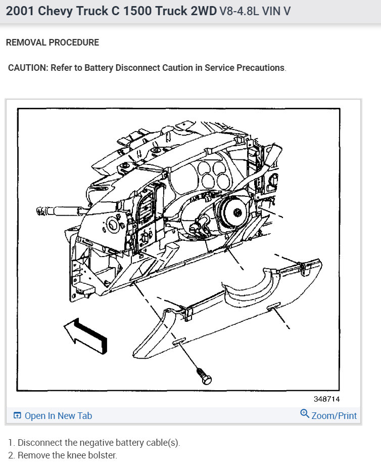

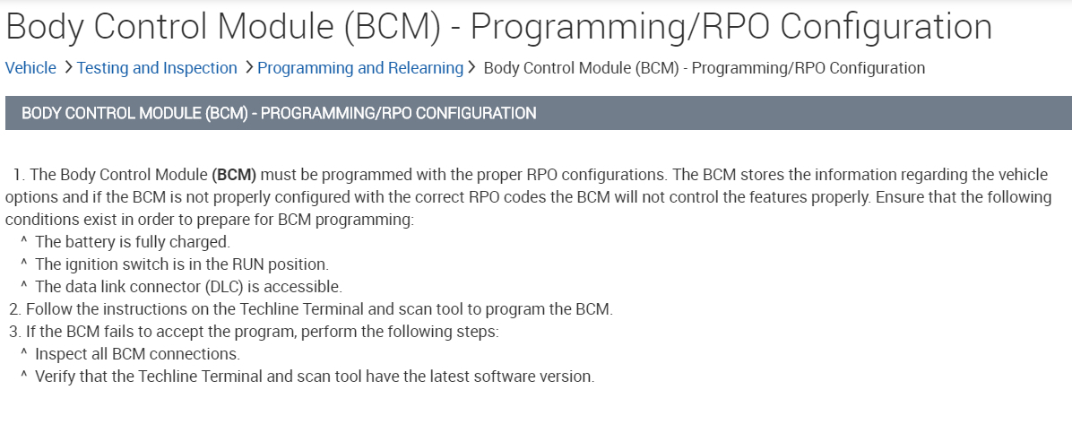

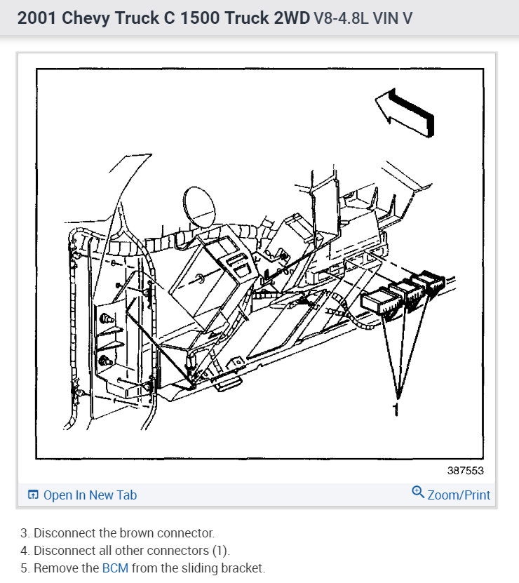

It sounds like you need to replace the BCM which is near the steering column. here are instructions and diagrams to show you how to do the repair. The new BCM will need to be programmed at a shop it should cost about $130.00. Check out the diagrams (below). Please let us know what happens.
