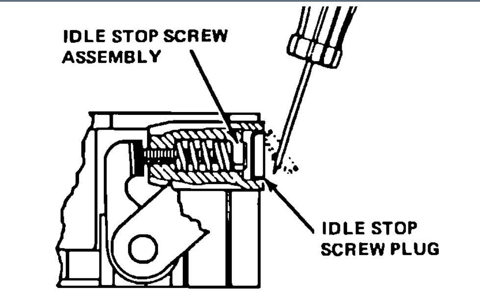

Remove the adjustable one and install the OEM back.

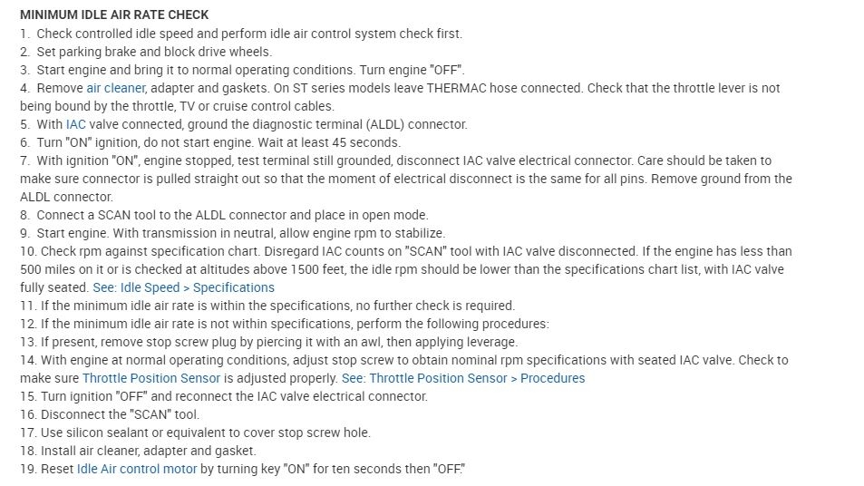

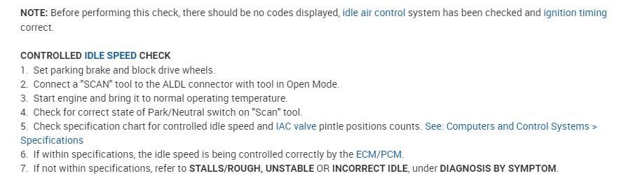

Did you set the base idle RPM? It should be 500-550 RPM.

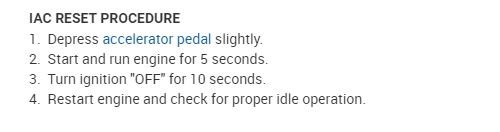

I would start by performing the base idle procedure and reset the IAC.

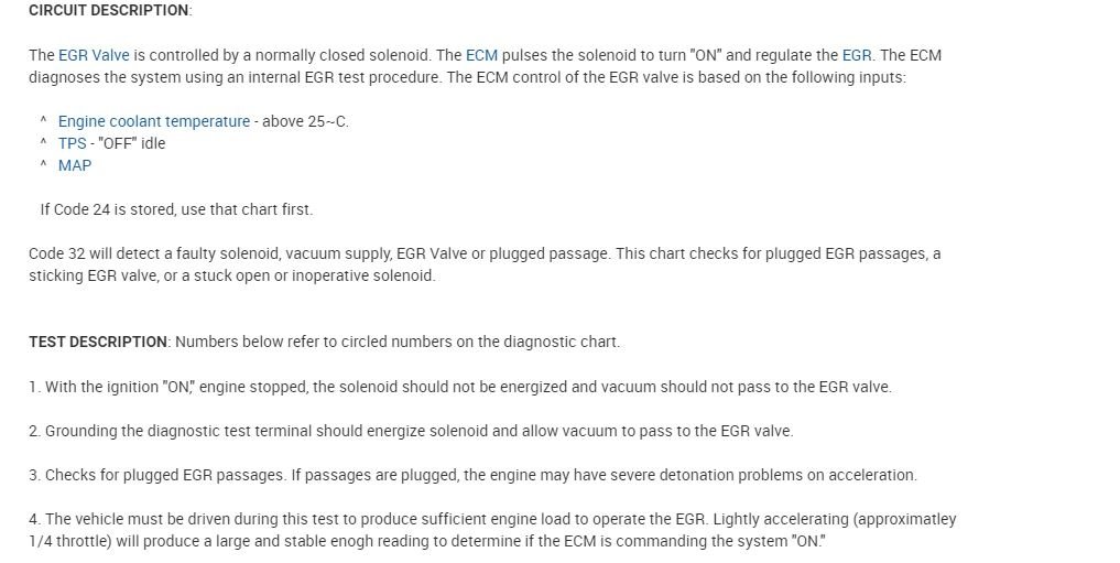

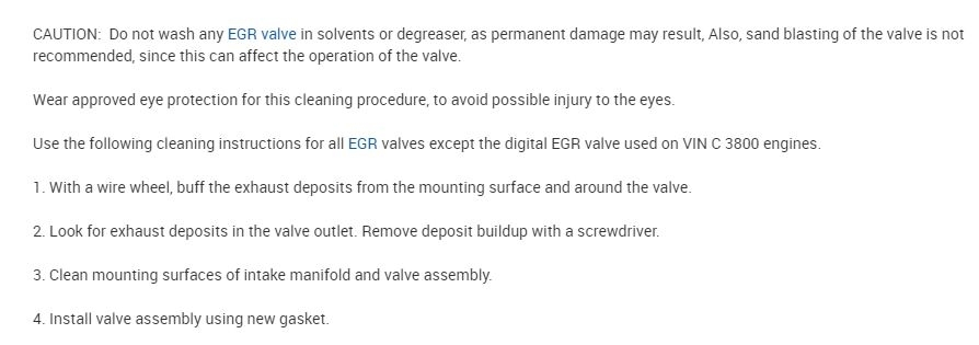

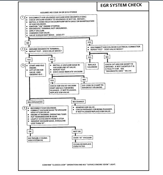

The EGR valve is stuck open is also a common cause of this issue as well. I would remove the valve and clean the end as carbon can hold the valve open causing a vacuum leak and lowering the idle and stalling.

Okay, over time the throttle body wears. you need to adjust the base idle to get the TPS in spec. You are not covering any issue by doing that at all.

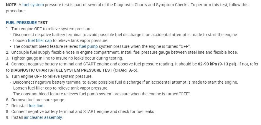

You can rent a tester from a parts store for the fuel pressure. You will need to T into the fuel filter connection to read the pressure. You need 9-13 pounds.
