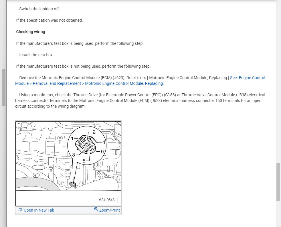

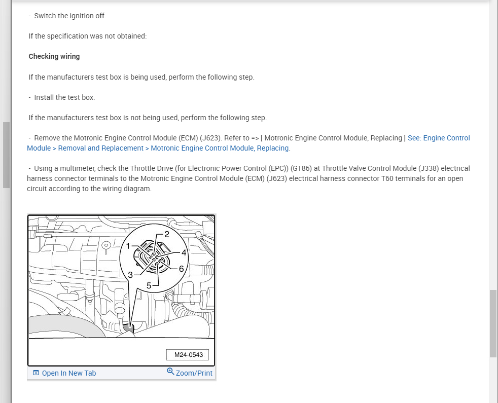

As I was reading through this the first thing that I thought of was an EVAP issue.
Here are some guides that will talk about this system so that we can be sure to be on the same page:
https://www.2carpros.com/articles/evap-system-code-repair
https://www.2carpros.com/articles/how-emission-control-systems-work

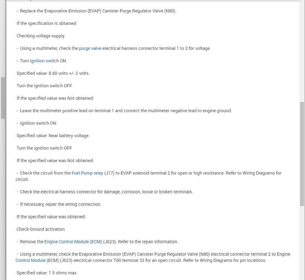

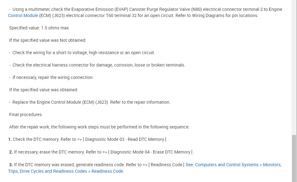

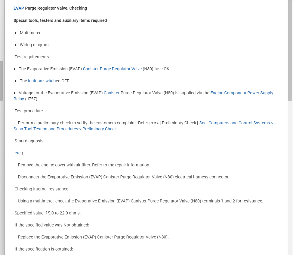

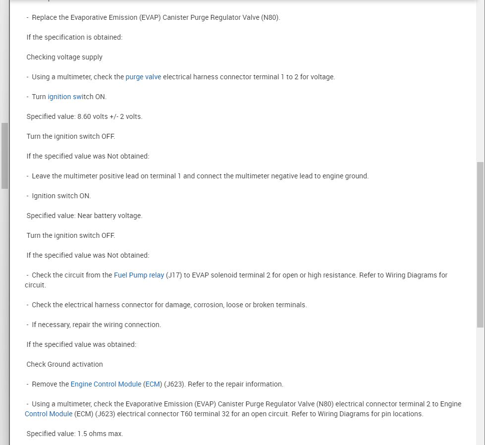

What I would do is remove the purge valve and inspect it for a powder type substance that is clogging the valve.
If there is, replace it. If not, run through the info below on testing the valve.

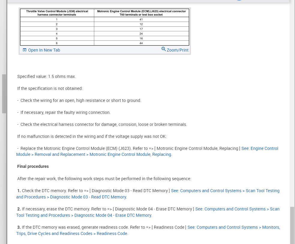

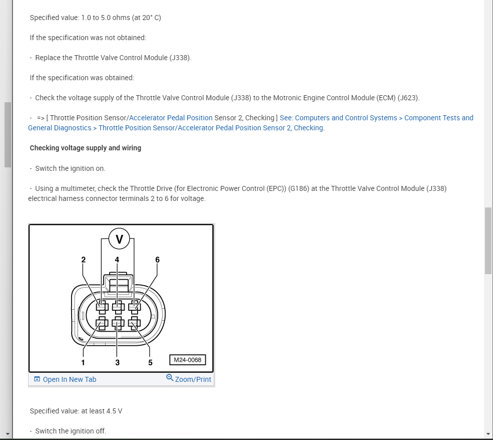

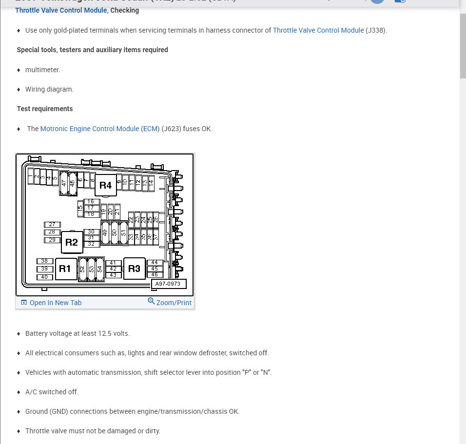

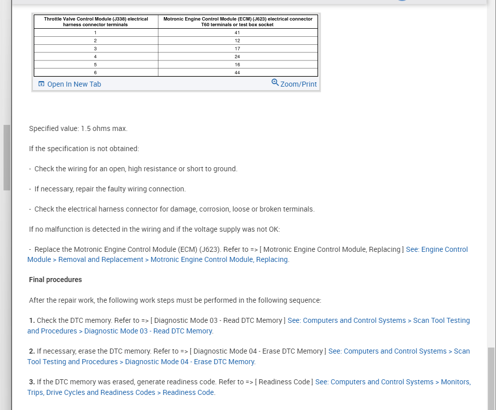

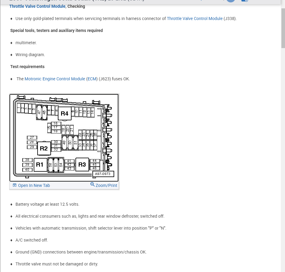

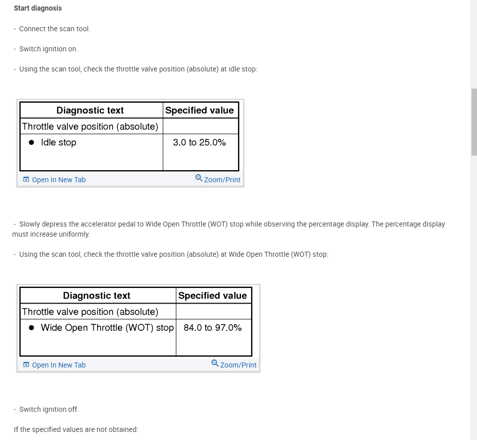

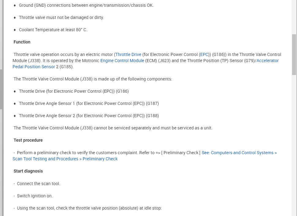

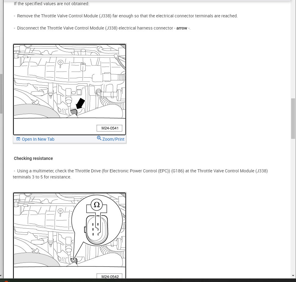

Also, the EPC light means electronic power control system which normally is just the throttle body. It could mean other things, but I suspect you are having an issue with the throttle getting stuck.
I am attaching some info on testing the throttle control as it would be worth running through this. At a minimum we need to inspect the throttle bore for it being dirty.
Please run through this info and let us know what you find. Thanks
