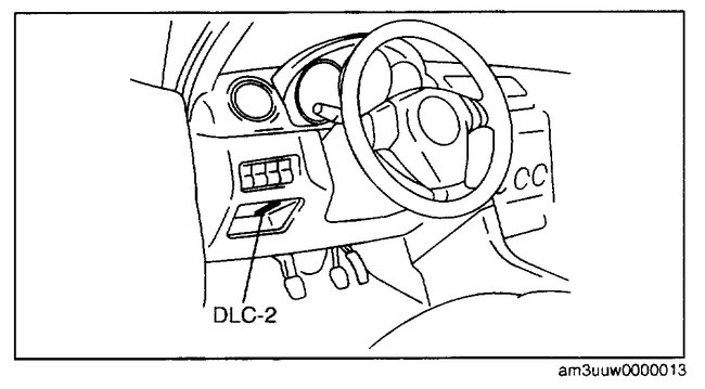

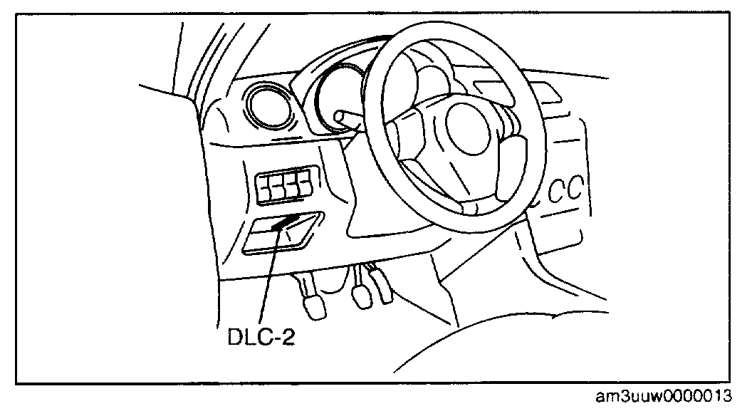

Using M-MDS
pic 1
1. Connect the M-MDS to the DLC-2.
2. Start the fuel pump using the "FP" simulation function.

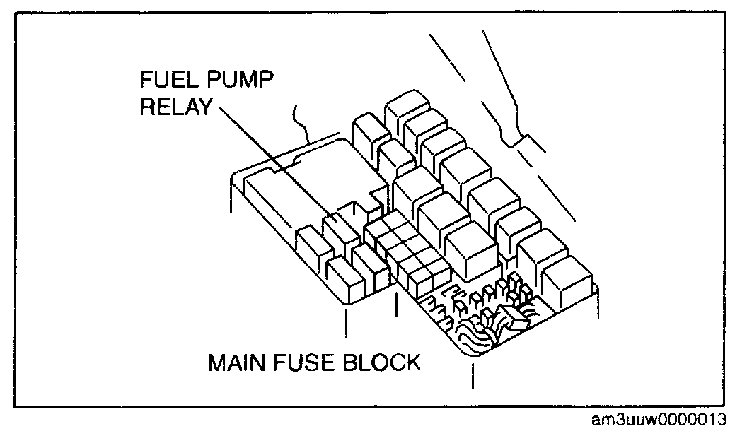

pic 2
2. Remove the fuel pump relay.

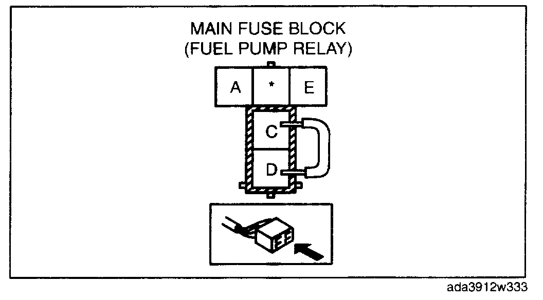

CAUTION: Be careful to short the specified terminal as shorting the wrong terminal of the main fuse block may cause a malfunction.
pic 3
3. Using a jumper wire, short fuel pump relay terminals C and D and connect the negative battery cable to start the fuel pump.

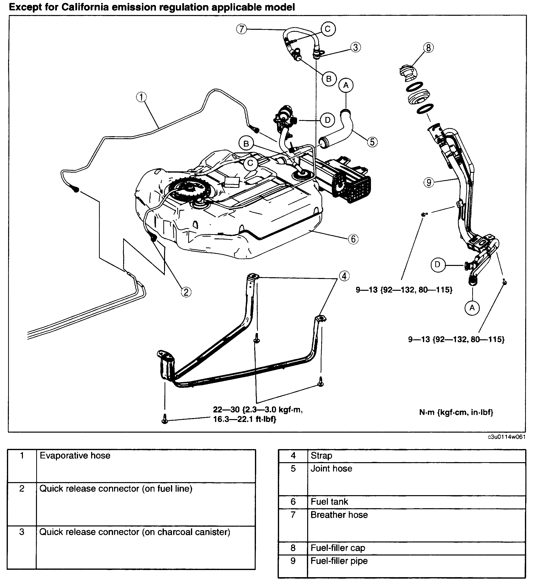

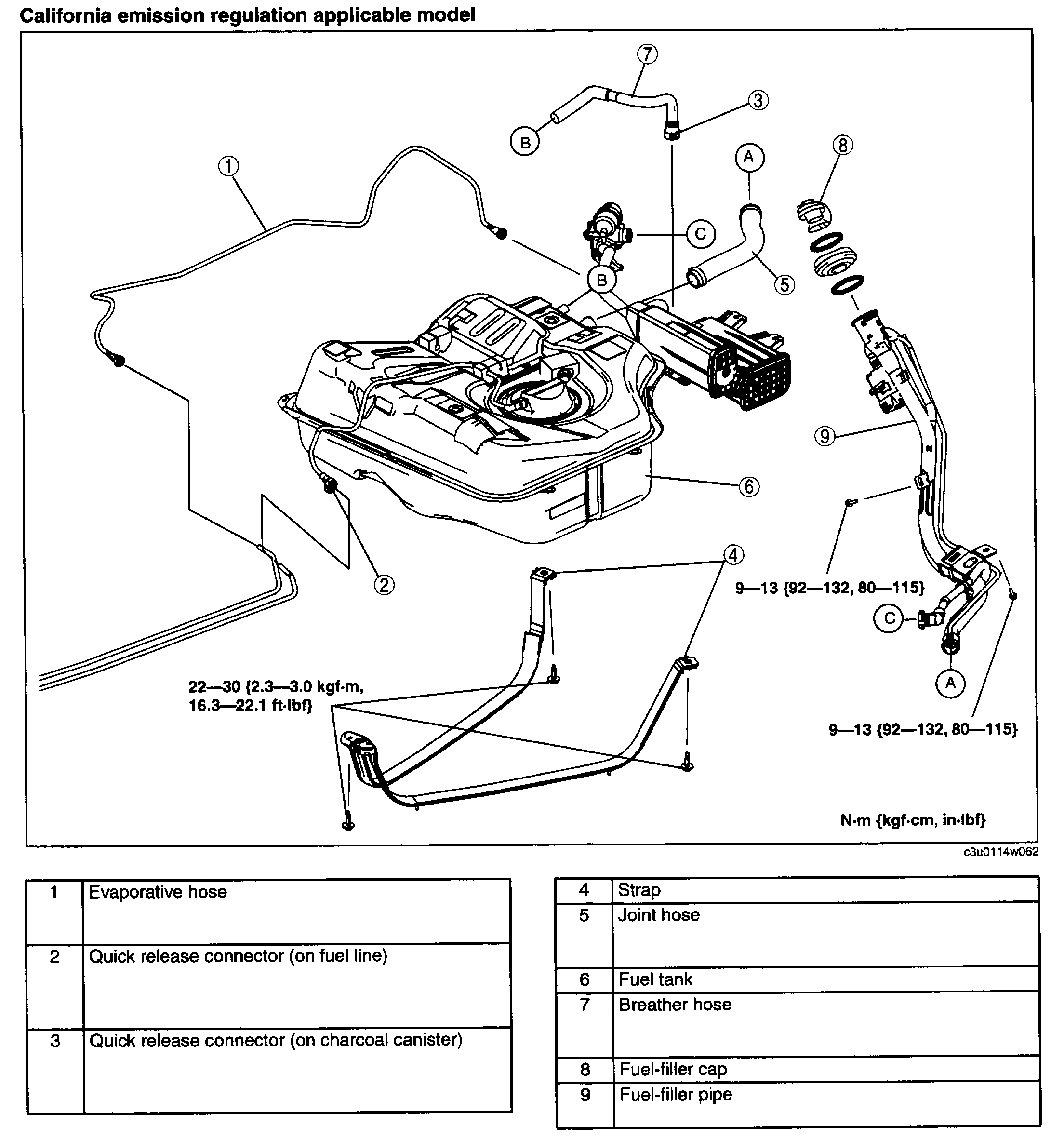

California Emission Regulation Applicable Model
pic 4
14. Inspect all parts by performing "AFTER SERVICE PRECAUTION". (See AFTER SERVICE PRECAUTIONS[LF, L3].) See: Fuel Pressure Release > Procedures > After Service Precaution
California emission regulation applicable model
Except For California Emission Regulation Applicable Model
pic 5
Except for California Emission Regulation Application Model
Evaporative Hose Removal/Installation Note
- Refer to the "QUICK RELEASE CONNECTOR (EMISSION SYSTEM) REMOVAL/INSTALLATION" to disconnect the quick release connector of the front side of the fuel tank.
- Refer to the "QUICK RELEASE CONNECTOR (EMISSION SYSTEM) REMOVAL/INSTALLATION" to disconnect the quick release connector connected to the charcoal canister.
- Refer to the "QUICK RELEASE CONNECTOR (EMISSION SYSTEM) REMOVAL/INSTALLATION" to reconnect the quick release connector of the front side of the fuel tank.
- Refer to the "QUICK RELEASE CONNECTOR (EMISSION SYSTEM) REMOVAL/INSTALLATION" to reconnect the quick release connector connected to the charcoal canister.

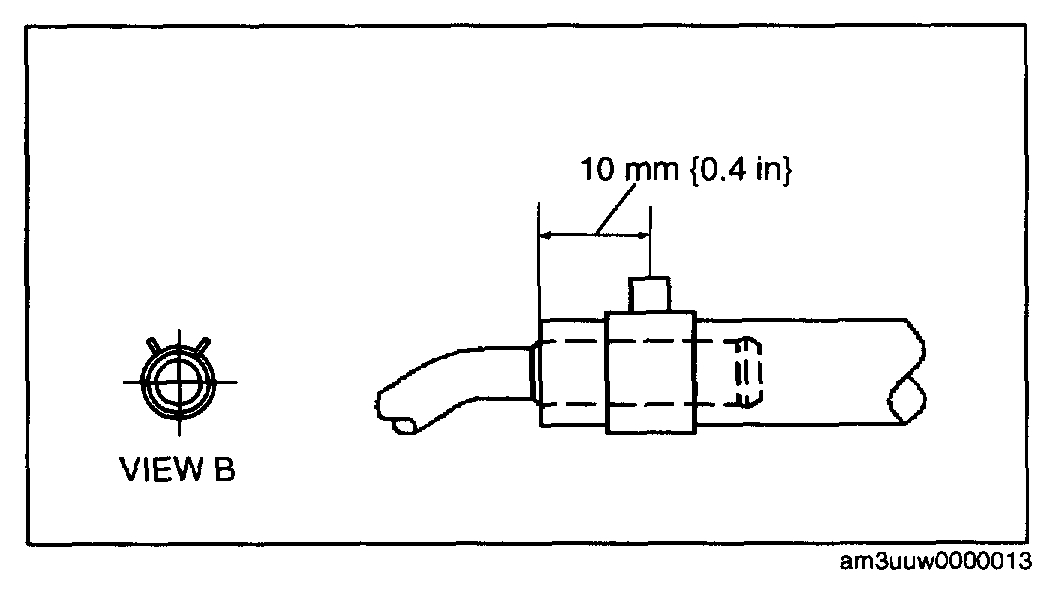

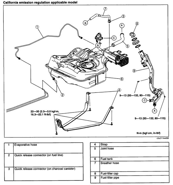

Breather Hose Installation Note
pic 6
- Connect the breather hose connecting with the fuel tank and clamp as shown in the figure.
Except for California emission regulation applicable model
- Refer to the "QUICK RELEASE CONNECTOR (EMISSION SYSTEM) REMOVAL/INSTALLATION)" to reconnect the quick release connector connecting to the fuel shut-off valve.

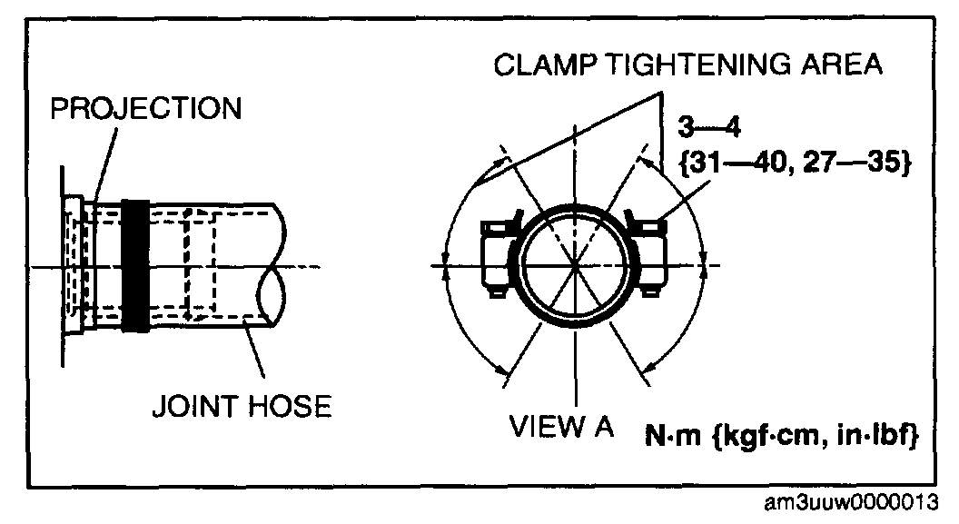

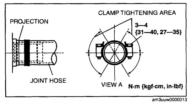

Joint Hose Installation Note
pic 7
1. Install the joint hose and clamp as shown in the figure.

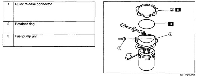

FUEL PUMP UNIT REMOVAL/INSTALLATION
FUEL PUMP UNIT REMOVAL/INSTALLATION[LF, L3]
WARNING:
- Fuel is very flammable liquid. If fuel spills or leaks from the pressurized fuel system, it will cause serious injury or death and facility breakage. Fuel can also irritate skin and eyes. To prevent this, always complete the "Fuel Line Safety Procedure", while referring to "BEFORE SERVICE PRECAUTION".
- Fuel is very flammable liquid. If fuel spills or leaks from the pressurized fuel system, it will cause serious injury or death and facility breakage. Fuel can also irritate skin and eyes. To prevent this, before performing the fuel pump unit removal/installation, always complete the "Fuel Leak Inspection After Fuel Pump Unit Installation".
NOTE: Gasket must be replaced anytime fuel pump is removed or replaced.
1. Follow "BEFORE SERVICE PRECAUTION" before performing any work operations to prevent fuel from spilling from the fuel system. (See BEFORE SERVICE PRECAUTIONS, L3].) See: Fuel Pressure Release > Procedures > Before Service Precaution
2. Disconnect the negative battery cable.
3. Remove the fuel tank.

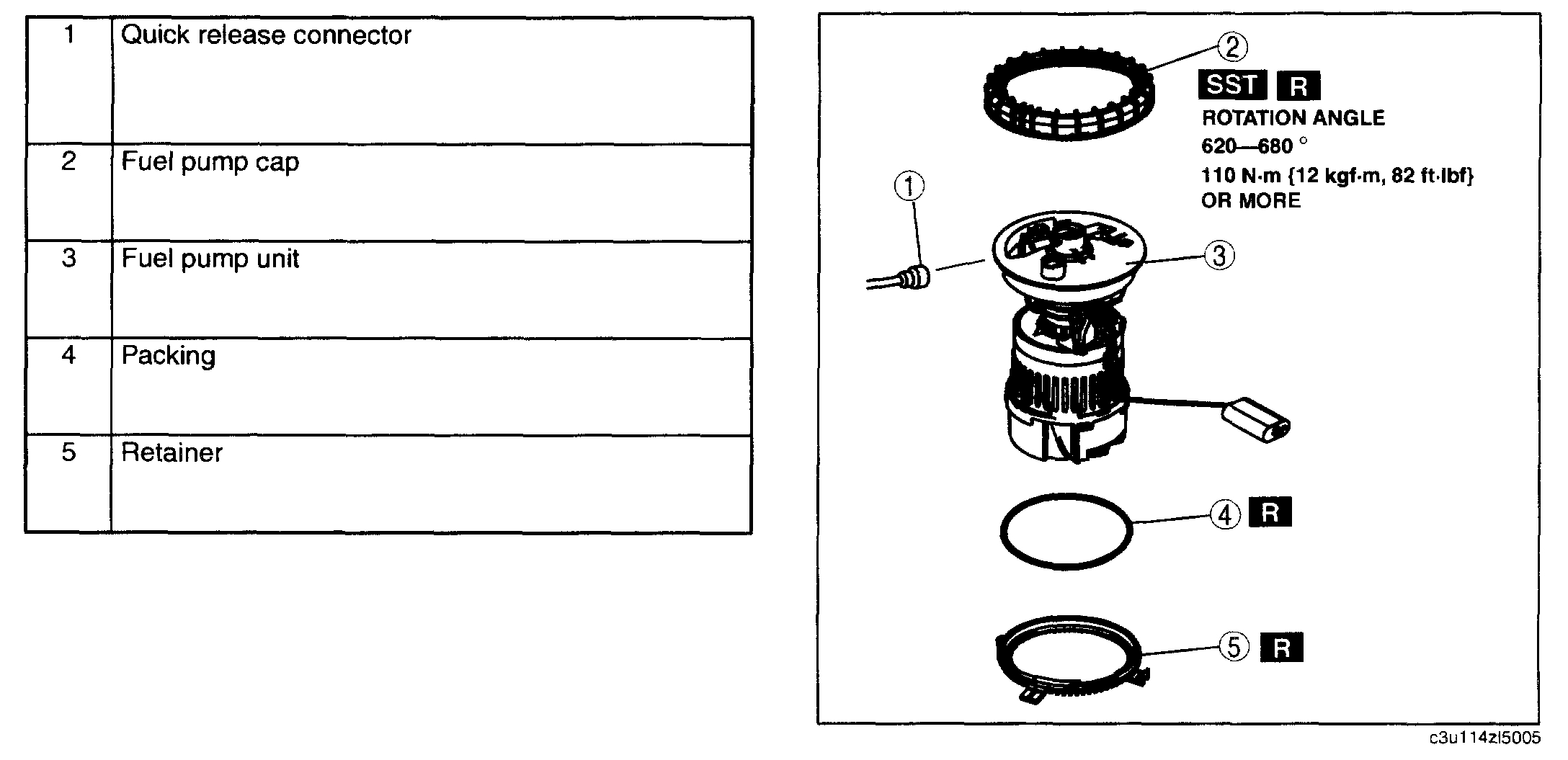

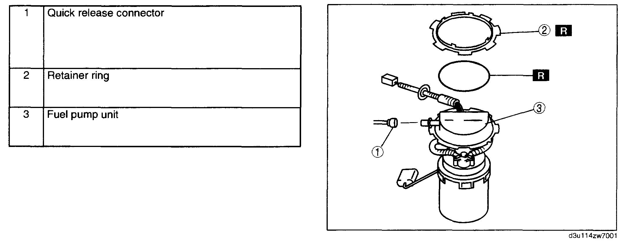

4. Remove in the order indicated in the table.
5. Install in the reverse order of removal.
pic 8
6. Inspect all related parts by performing "AFTER SERVICE PRECAUTION". (See AFTER SERVICE PRECAUTIONS[LF, L3].) See: Fuel Pressure Release > Procedures > After Service Precaution

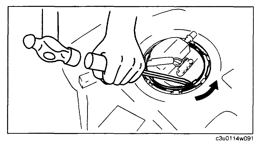

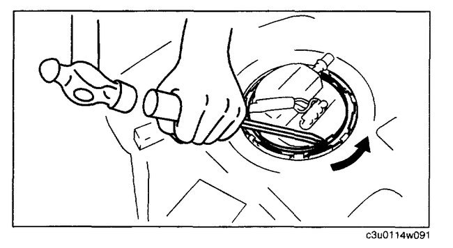

pic 9
1. Remove the retainer ring by tapping a retainer ring projection using a flathead screwdriver as shown in the figure.

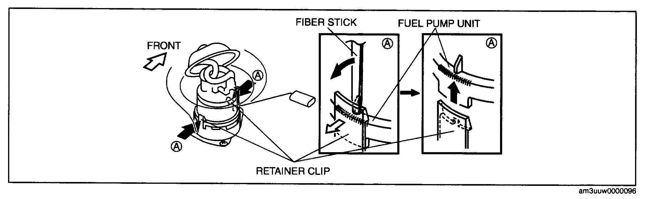

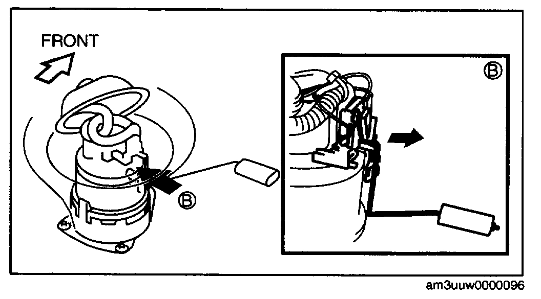

Fuel pump unit removal note
NOTE: The fuel pump unit is secured by the two retainer clips with the bracket on the bottom surface of the fuel tank.
pic 11
1. Using a fiber stick, disengage the retainer clips until the pump can be removed
2. Remove the fuel pump gauge connection area from the fuel pump unit.
3. Set the fuel pump gauge out of the way and remove the fuel pump unit from the fuel tank.

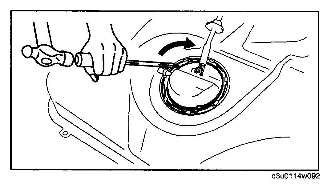

Retainer ring installation note
pic 12
1. Tap a retainer ring projection using a flathead screwdriver as shown in the figure and tighten the retainer until it is fixed in place.

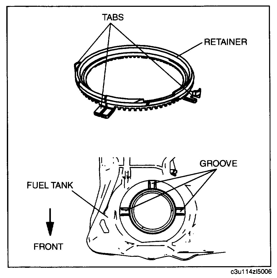

3. Install a new retainer to the fuel tank.
1. Align the retainer tabs (3 locations) with the fuel tank grooves.
2. Verify that the tabs are inserted into the grooves and the retainer is installed correctly.
3. Verify the retainer is not damaged.

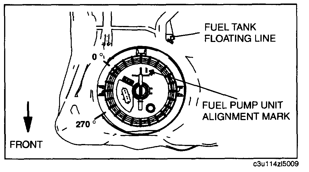

5. Install the fuel pump unit to the fuel tank.

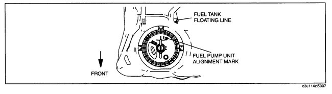

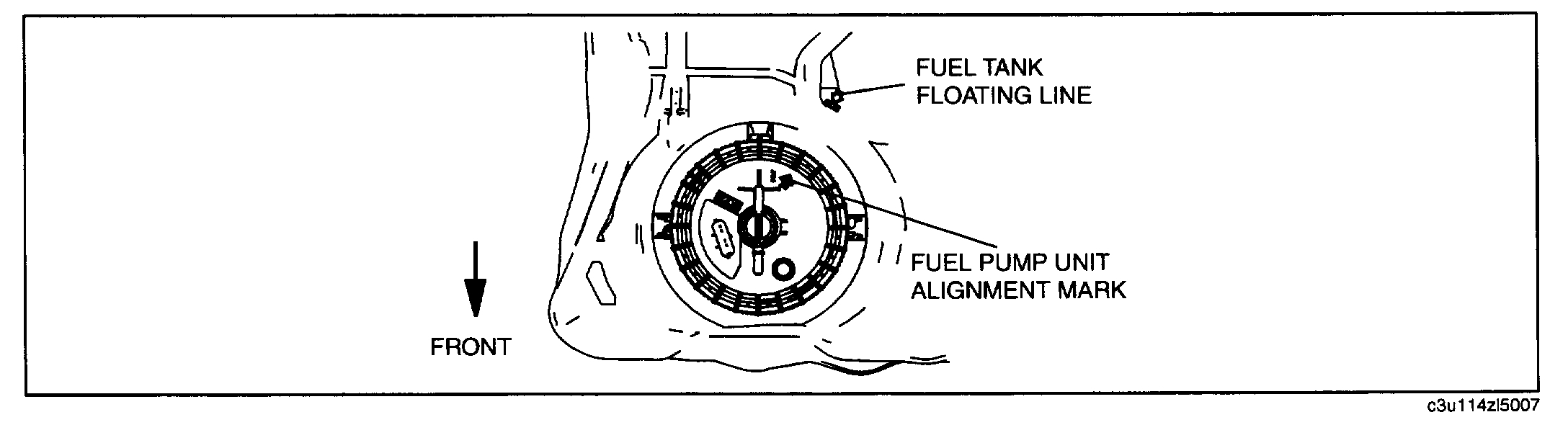

pic 16

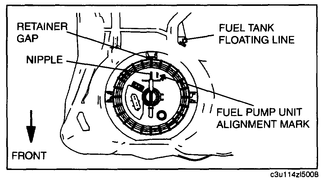

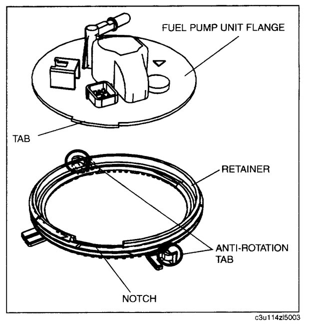

1. Align the fuel pump unit alignment mark and the floating line on the fuel tank.

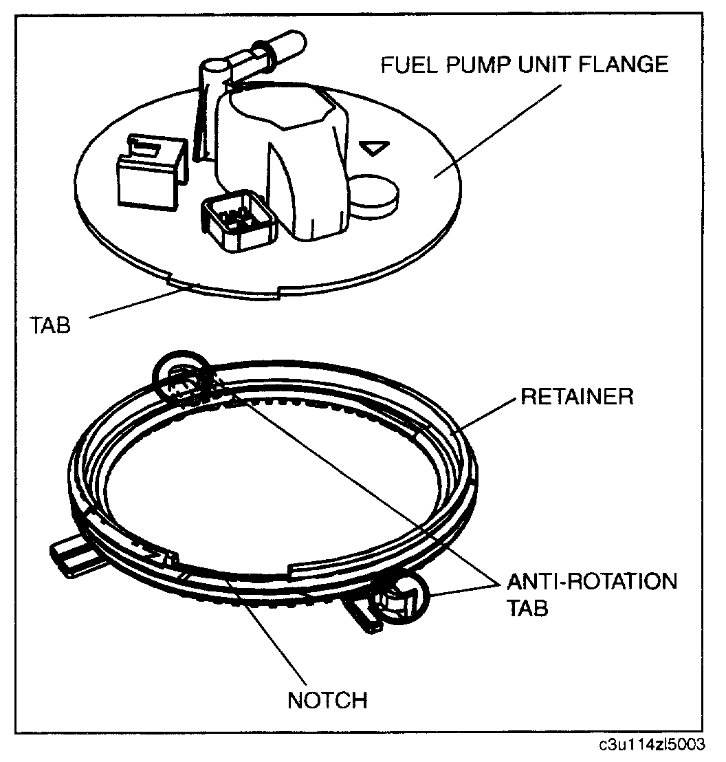

pic 17
2. Verify the tab on the fuel pump unit flange with the notch on the retainer.
pic 18

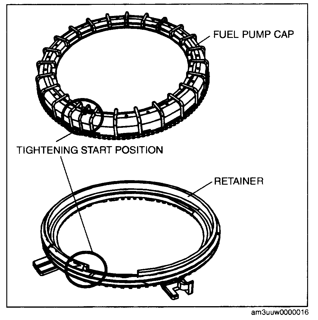

6. Set on a new fuel pump cap.
1. Apply downward force (push down) on the center of the fuel pump unit flange.
NOTE:
- Align the fuel pump cap with the tightening start position of the retainer and tighten the fuel pump cap with the start position as 0 °.
- The fuel pump cap tightening start position is the position where the spaces between the ribs become narrow. The retainer tightening start position is the notch position.
2. Align the tightening start position on the fuel pump cap and the tightening start point of the retainer.

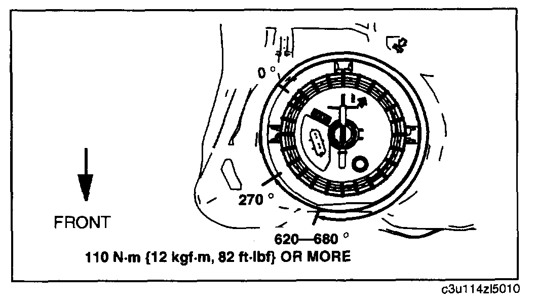

7. Tighten the fuel pump cap.
pic 20
1. Tighten the fuel pump cap by hand to the specified angle or more until the flange is fixed.
Fuel pump cap rotation angle
270 ° or more
2. Verify that the fuel pump cap is tightened correctly.
1. The gap between the bottom of the fuel pump cap and the tank surface is even all around.
- If the fuel pump cap is not tightened uniformly, loosen it by hand and reinstall it.
pic 21

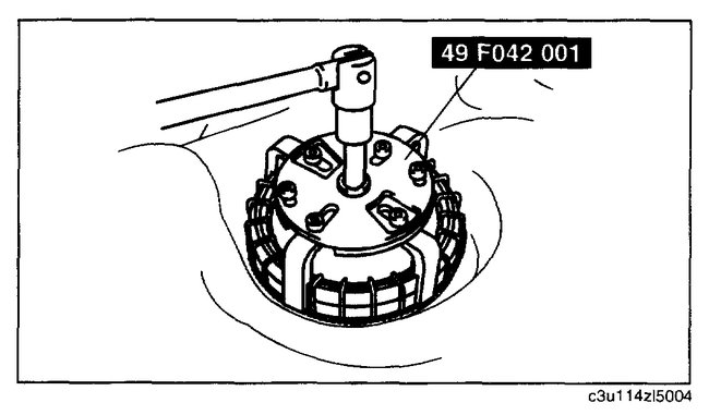

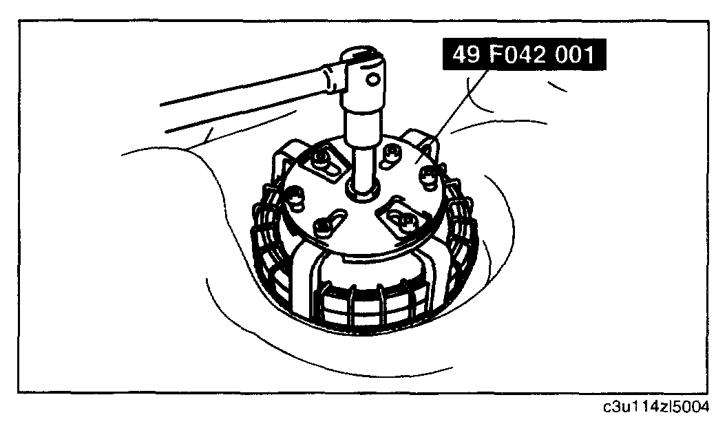

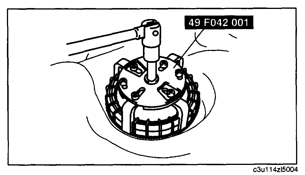

3. Install the SST.
NOTE The fuel pump cap rotation angle is the angle from the 0 ° position. The angle tightened to using the SST includes the angle tightened by hand.
pic 23
4. Tighten the fuel pump cap to the specified torque and to the specified angle or more.
620 - 680 °
Fuel pump cap tightening torque
110 N-m {12 kgf-m, 82 ft-lbf} or more

3. Verify that the fuel pump unit alignment mark and the floating line on the fuel tank are aligned.
- If they are not aligned, re-install it using the following procedure.
pic 23
4. Verify that the fuel pump unit nipple and the retainer gap are aligned.
- If it is not aligned, re-install using the following procedure.
