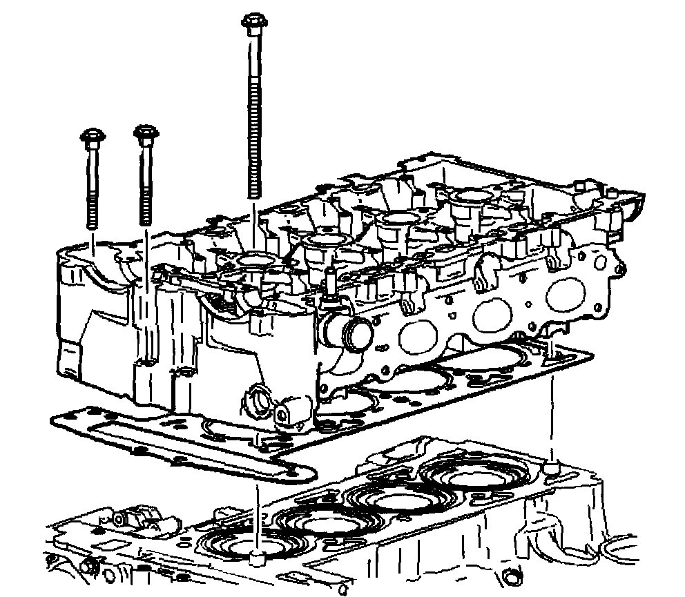

Removal Procedure
picture 1
1. Disconnect negative battery cable.
2. Remove the intake manifold.

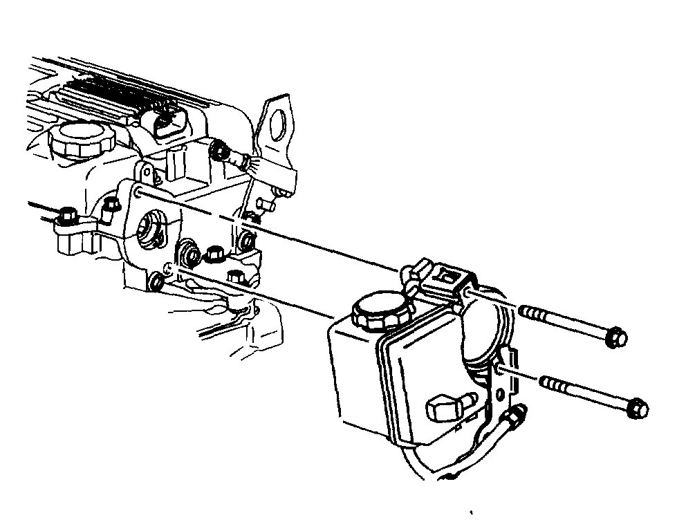

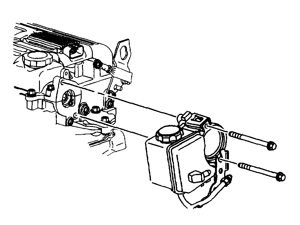

3. Remove the power steering pump bolts and set pump aside.

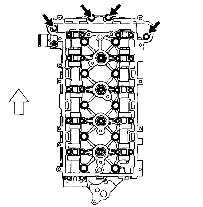

picture 2
4. Remove the exhaust manifold.

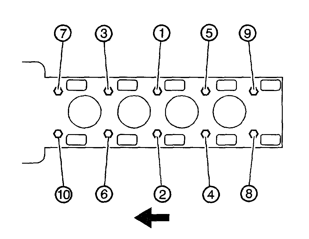

Installation Procedure
picture 4
1. Install the cylinder head and gasket.

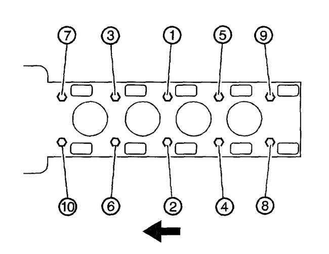

picture 5
Notice: Refer to Fastener Notice in Service Precautions.

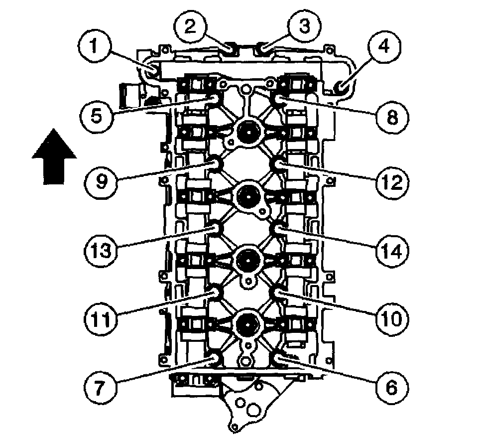

3. Tighten the cylinder head bolts in sequence.
^ Tighten the cylinder head bolts to 30 Nm (22 ft. lbs.) plus 155 degrees.

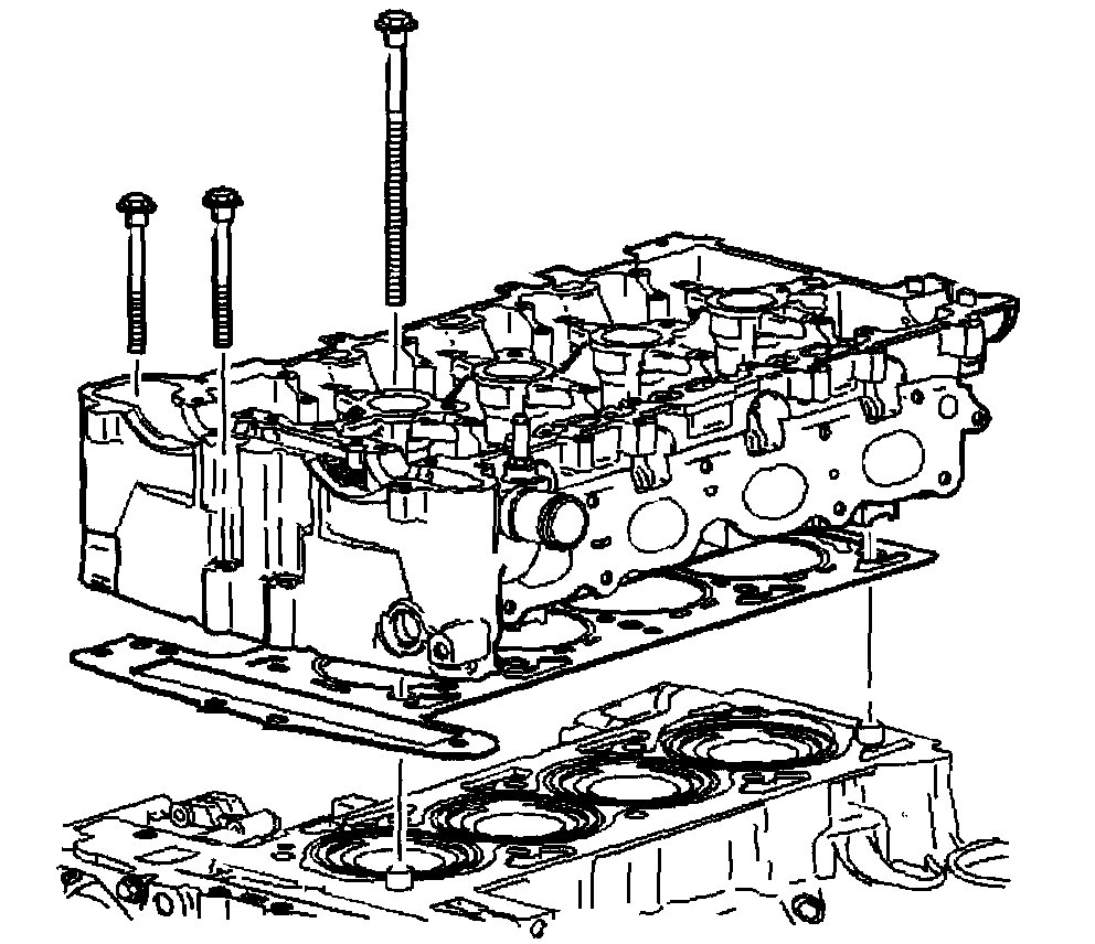

picture 6
4. Install the NEW front cylinder head bolts.
^ Tighten the front cylinder head bolts to 35 Nm (26 ft. lbs.).

9. Install the power steering pump.
^ Tighten the power steering pump bolts to 25 Nm (19 ft. lbs.).
