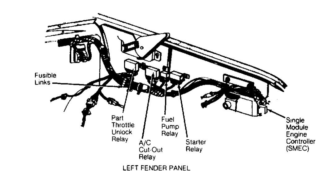

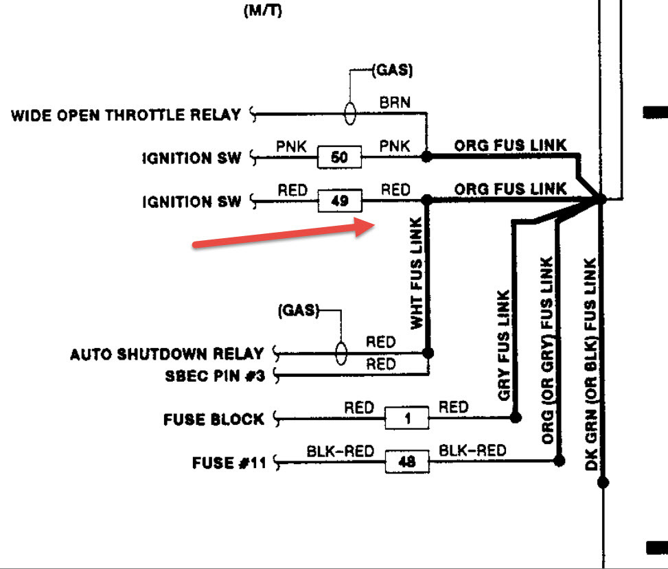

check all fusible links in pic they go off of starter relay check fuel pump relay for power.
