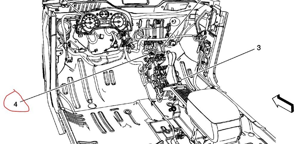

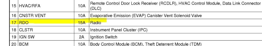

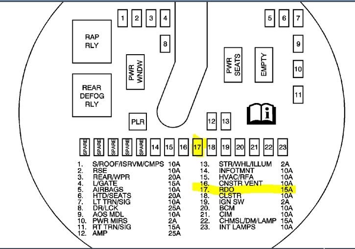

The first thing I recommend checking is the fuse. The fuse is located in the passenger compartment.
I attached three pics to help you locate it. Also, here are a few links you may find helpful when checking:
