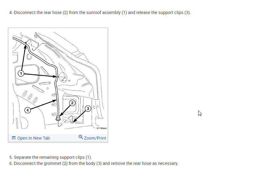

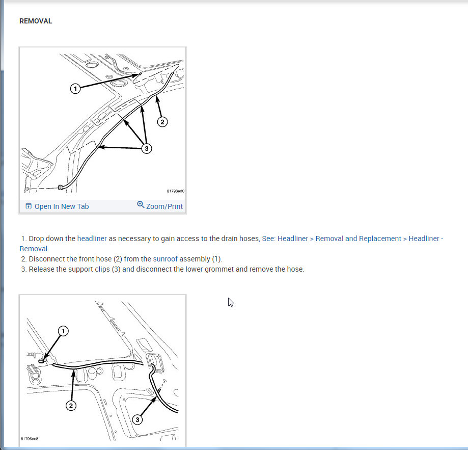

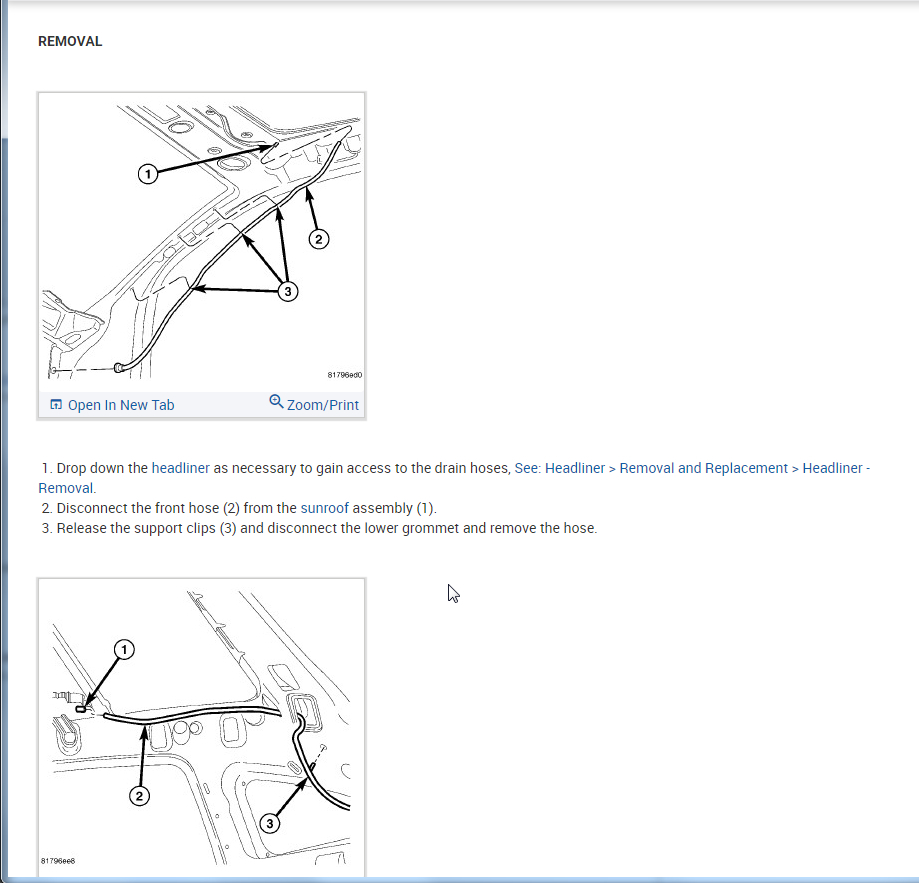

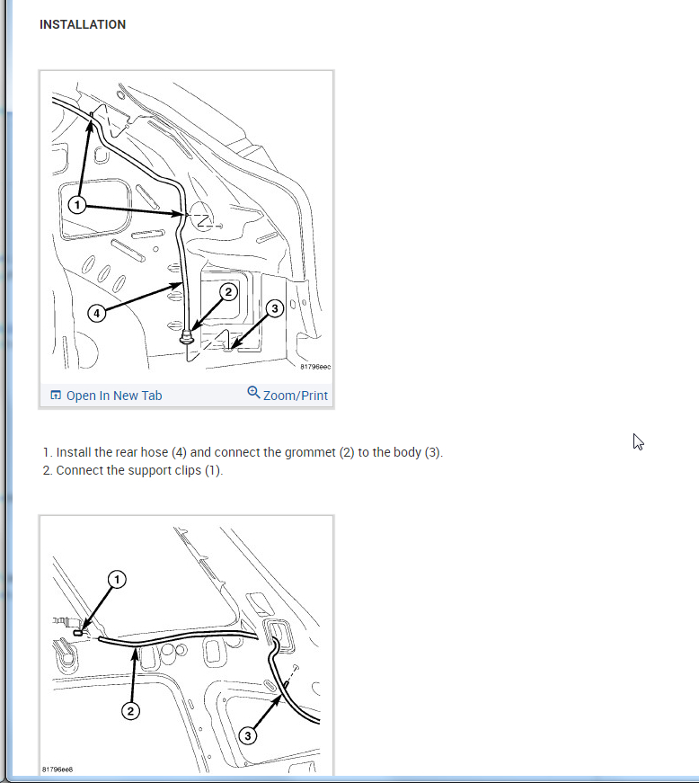

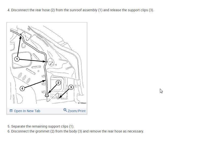

I suspect you have a sun roof and if you do then most likely the front drain tube on that side is leaking. It runs down the A pillar and connects to a grommet on the front firewall of the vehicle.
I attached the process below on how to replace this. I suspect you can reconnect it but I would suggest just replacing it if it is not found to be unhooked as you have a split in the line somewhere.
Let us know if you have questions. Thanks
