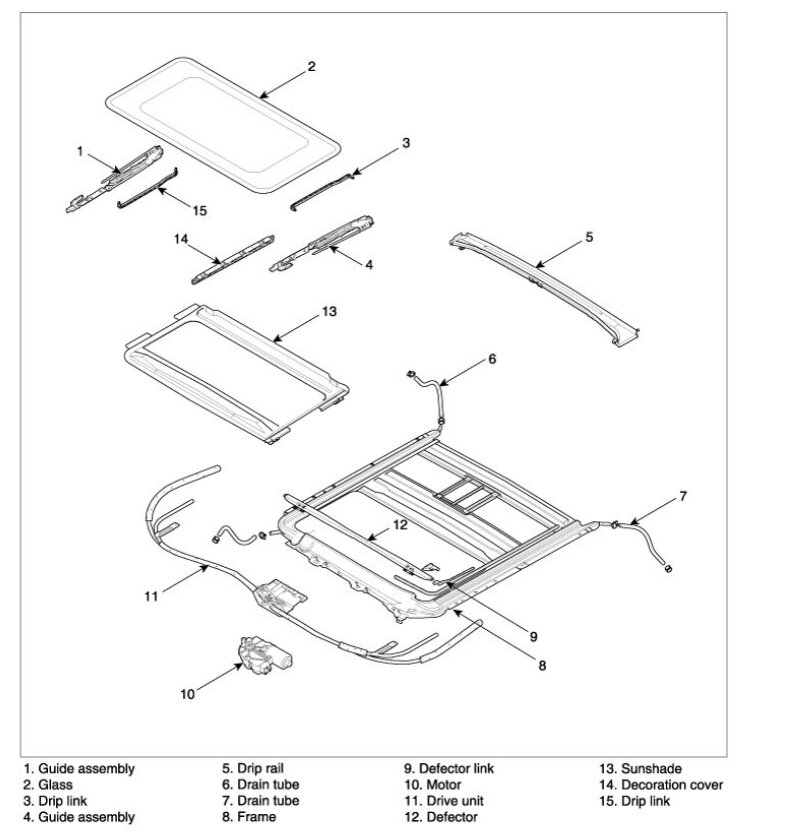

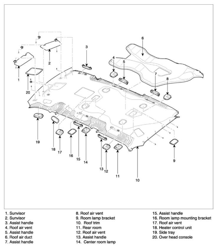

I recently noticed rain coming in from the overhead map light console as well as from the pedal box area. I'm assuming the two are somehow related for both to have started seemingly at the same time.
Aug 8, 2023 at 6:55 AM

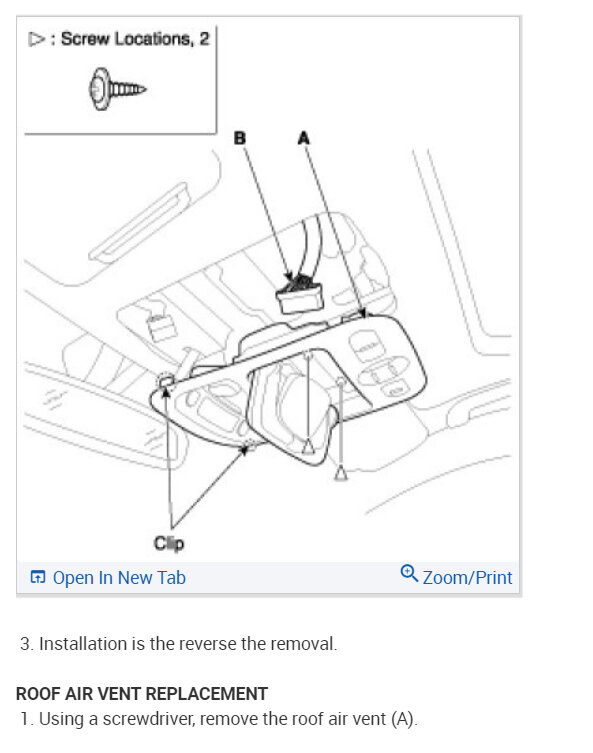

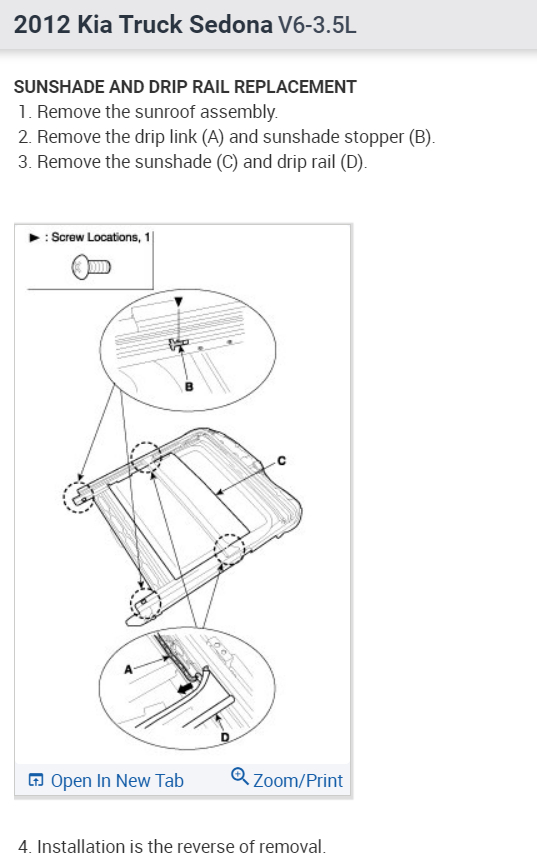

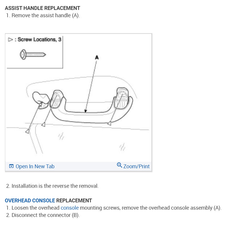

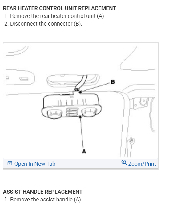

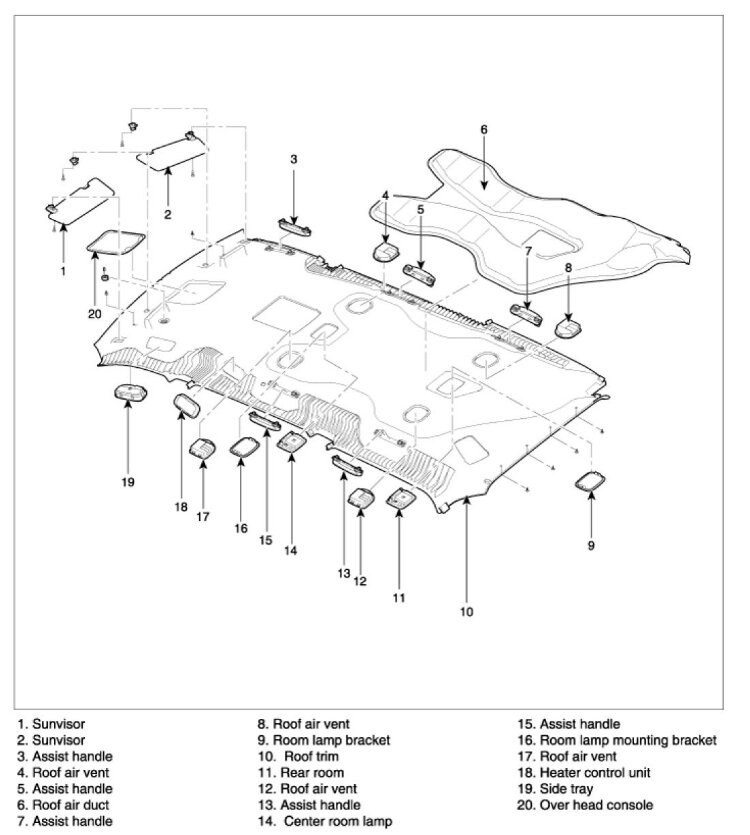

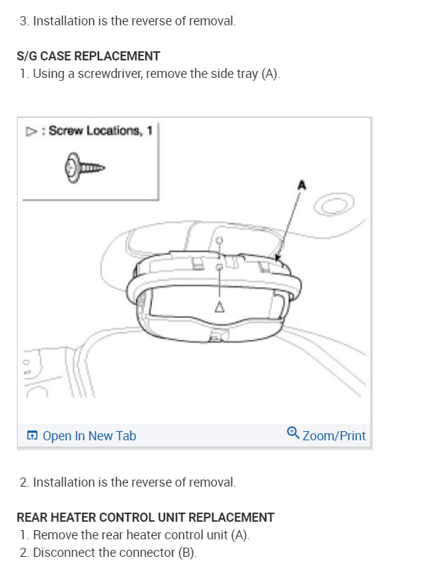

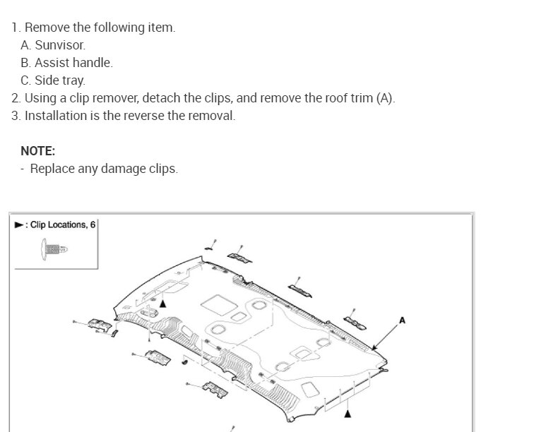

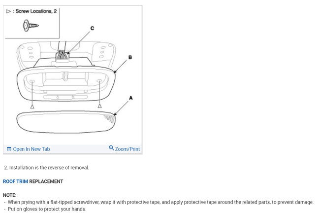

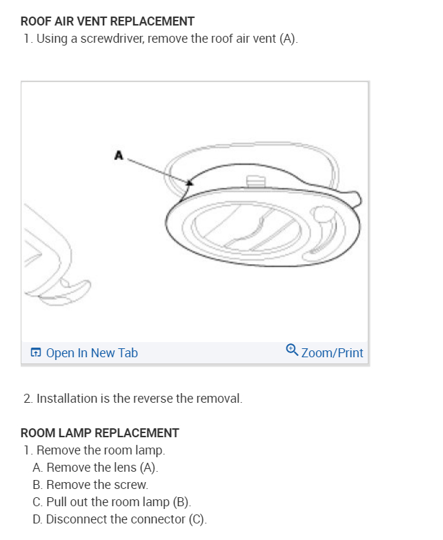

So, what happens is the drip rail for the sunroof gets clogged up or it comes off of the drain catch basins, you will need to remove the headliner and will need compressed air to clear it out or reattach the drain tube. Check out the images (below). Please let us know how it goes.
