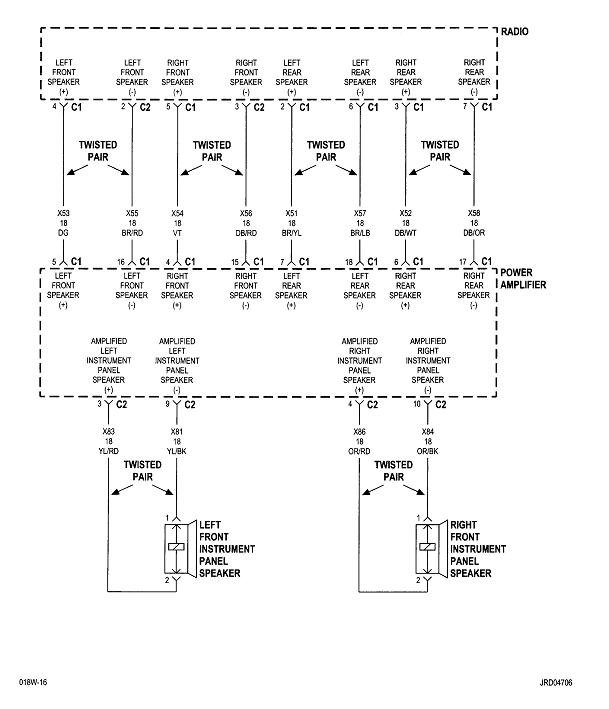

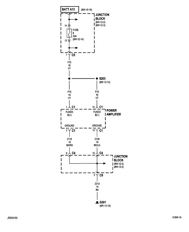

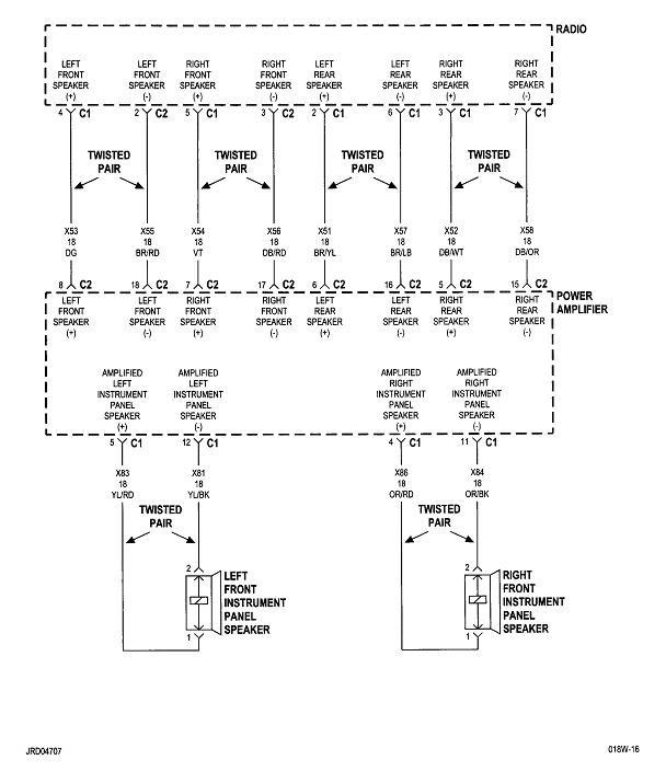

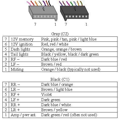

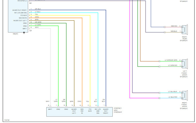

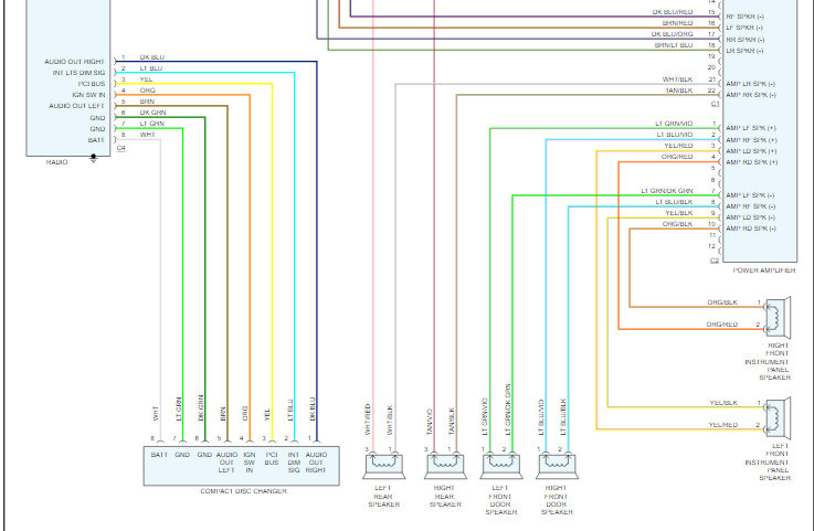

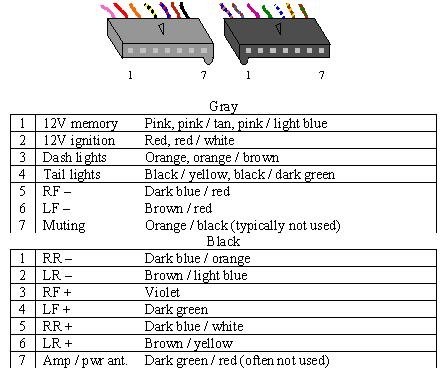

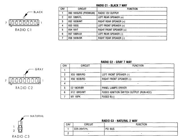

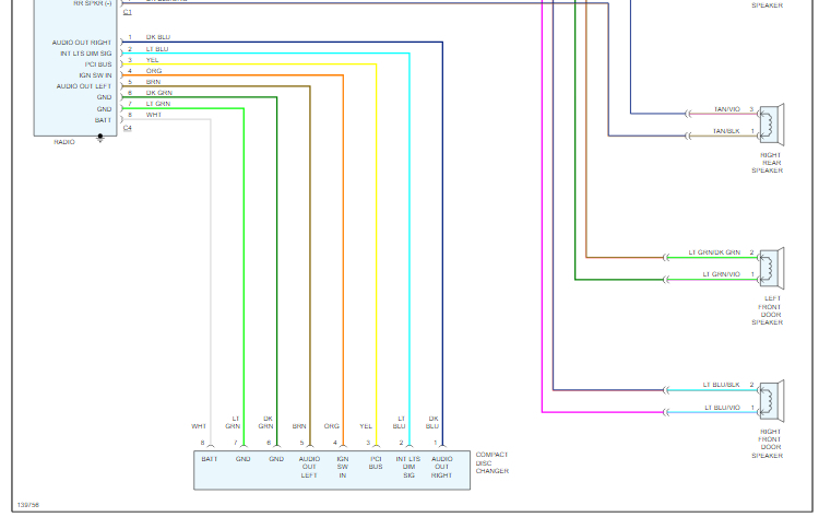

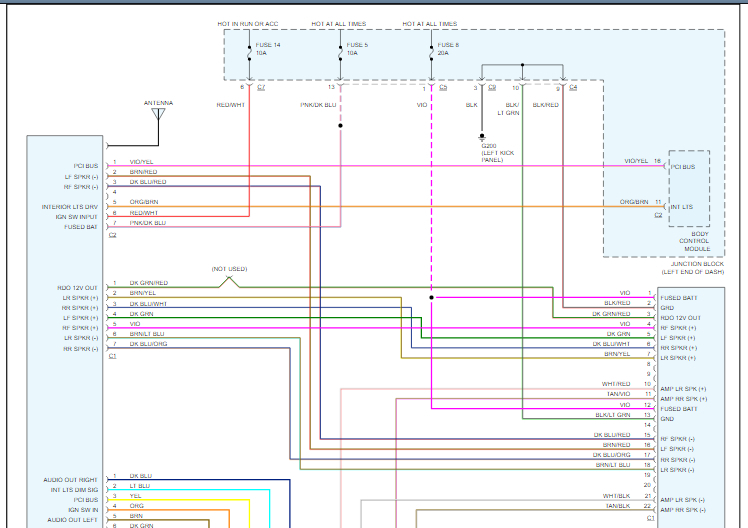

There's three versions for this system. I need to know what you're trying to do or solve if it involves the connectors. The first drawing is one I developed and have been handing out at car show swap meets for many years. The last one is from the online service manual. The two do not agree, so I have to figure out which one is wrong.
Also, don't get hung up on the wire colors. Those on your car could be different than those shown in the first drawing. Go by the locations in the plugs, and the colors shown in the diagrams. These diagrams are specific to your year and model.

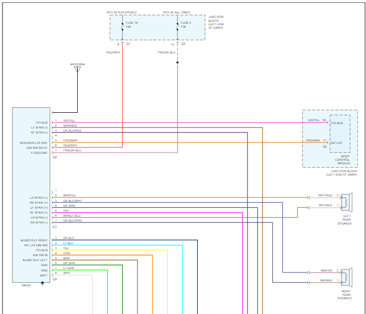

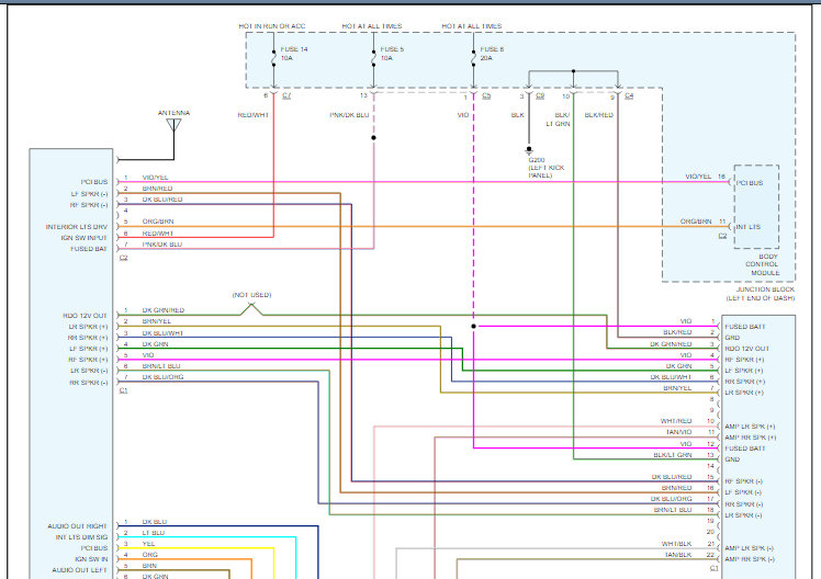

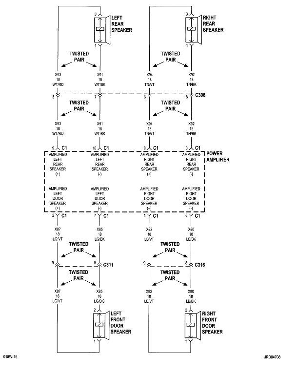

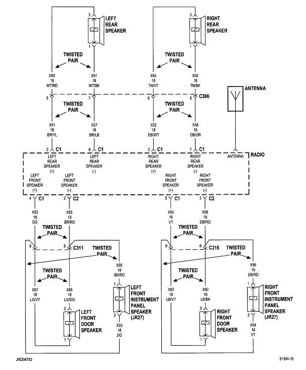

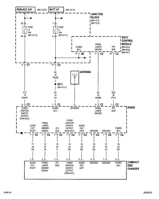

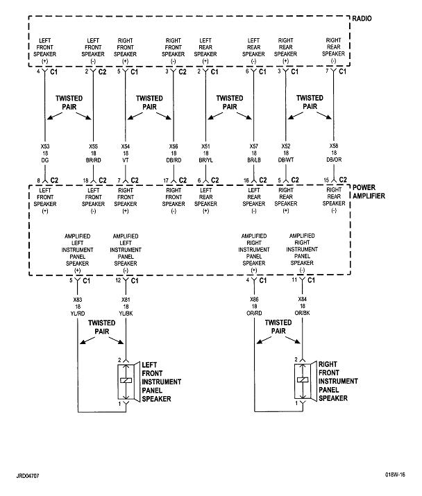

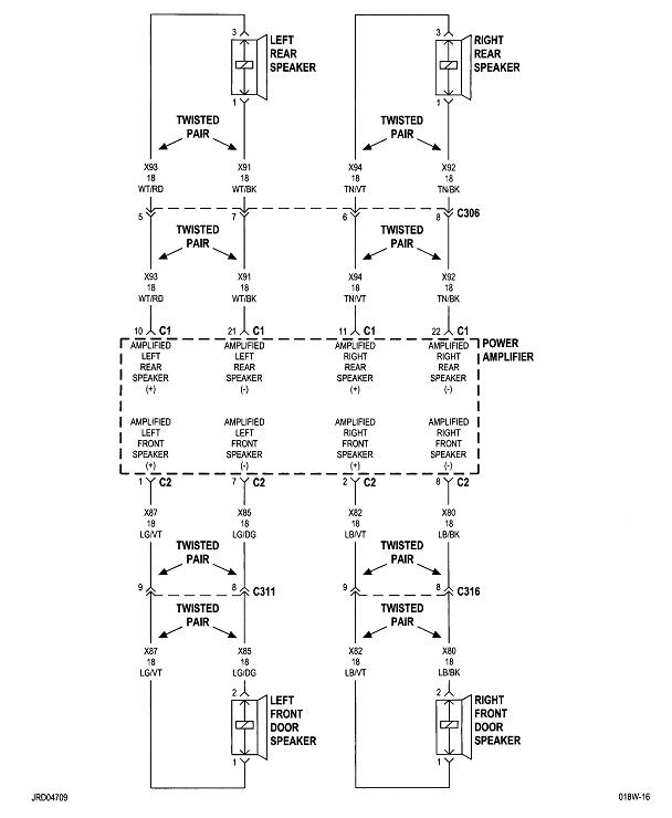

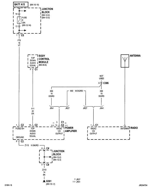

Here is the radio wiring diagram you requested. I've cut the pictures into 2 pieces to blow them up a little larger.The first two pictures are for the base model radio.The second two pictures are the premium model.Hope this helps and thanks for using 2CarPros.

Thanks guys, I'm trying to upgrade my car radio, that's why I'm looking for the right diagram. I was trying some diagrams that I found in the internet but it just didn't match the colors. I'll try with these. Thanks

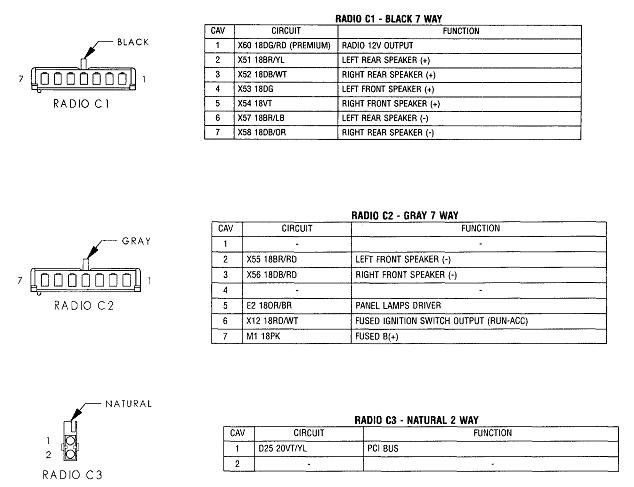

Here's my corrected drawing. The wire color / locations are the same. I only changed the numbering to agree with the diagrams.
If you need to know if you have the base radio system or one of the two premium systems, the premium systems use an amplifier mounted to the floor under the passenger's front seat.

These combo radios are my best seller for people doing upgrades to a used car they just bought, and want to stick with original equipment. The disadvantage is if you want the newer features like Bluetooth, and things like that, you'd have to look for something in the aftermarket world that will plug in the back. The first diagram makes reference to connector "C4" which was a round 8-pin connector for the remote CD changer. That would be where an aftermarket accessory would plug in. I never got involved with aftermarket stuff, so you'd have to rely on the product description and advertising to see if those would work for you.

Thanks a lot, I will consider all your recommendations and I just match all the wires thanks to your drawn. it really helped me a lot.
