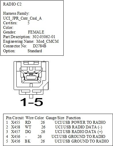

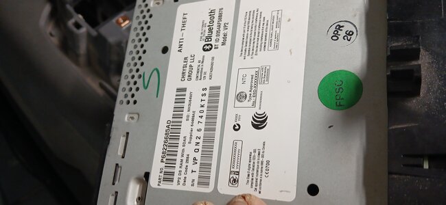

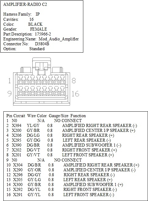

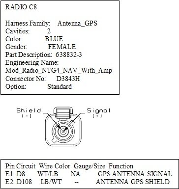

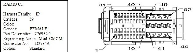

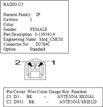

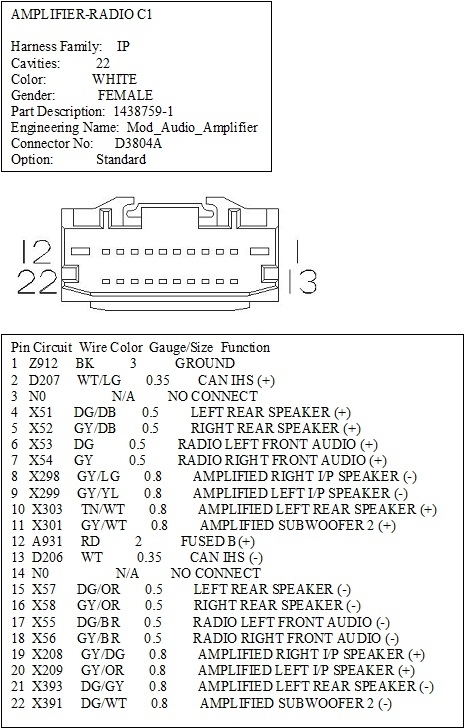

hello, I was hoping someone would have access to a wiring diagram for the factory stereo harness for a SLT 2014 Ram. (No radio controls on wheel)
I was adding RCA cables and needed to splice into the white/black wire and maybe others.
I would greatly appreciate this. Thanks, and good day to you all.
