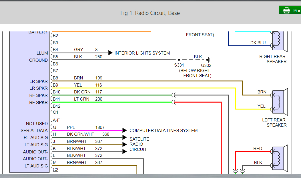

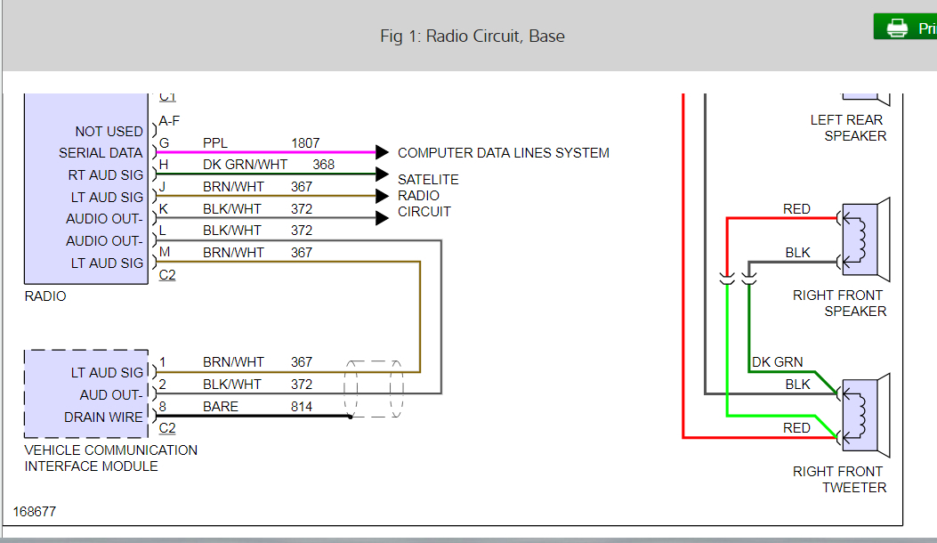

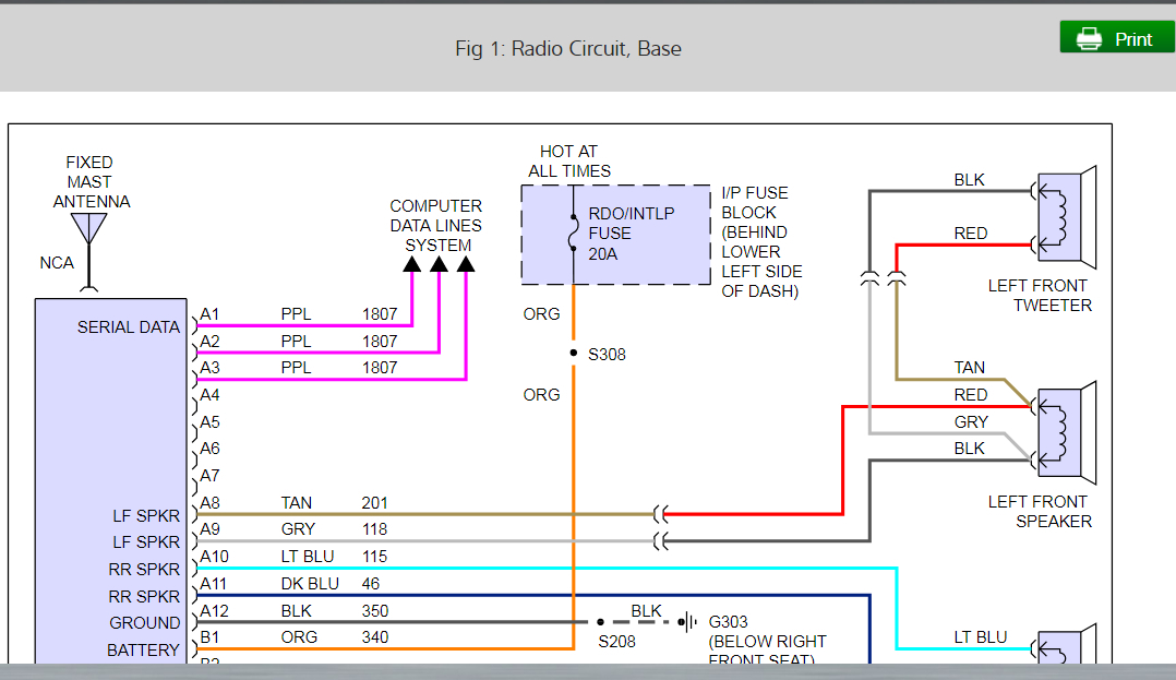

My car is a coupe. I have no sound.I don't have the outrageous amount they want for the wire harness and I'm trying to straight wire the radio. The original is 24-pin connector a1-12 and b1-12, a1 purple a2-a7 empty, a8 to a11 speakers a12 black (ground). B1 orange 12v+ b2&3 empty b4 gray b5 black b6&7 empty and b8 to 11 speakers. Have switch hooked up in fuse box.
