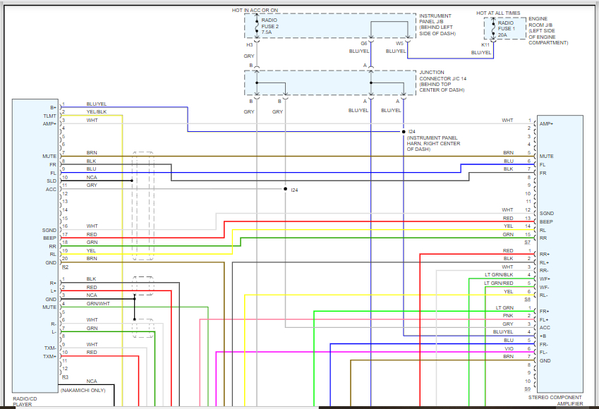

Car keeps popping a fuse to the radio. Want to follow the wire and check for any grounding issues.

Here is the information you requested. Here is a tutorial for you to view on how to test electrical wiring:

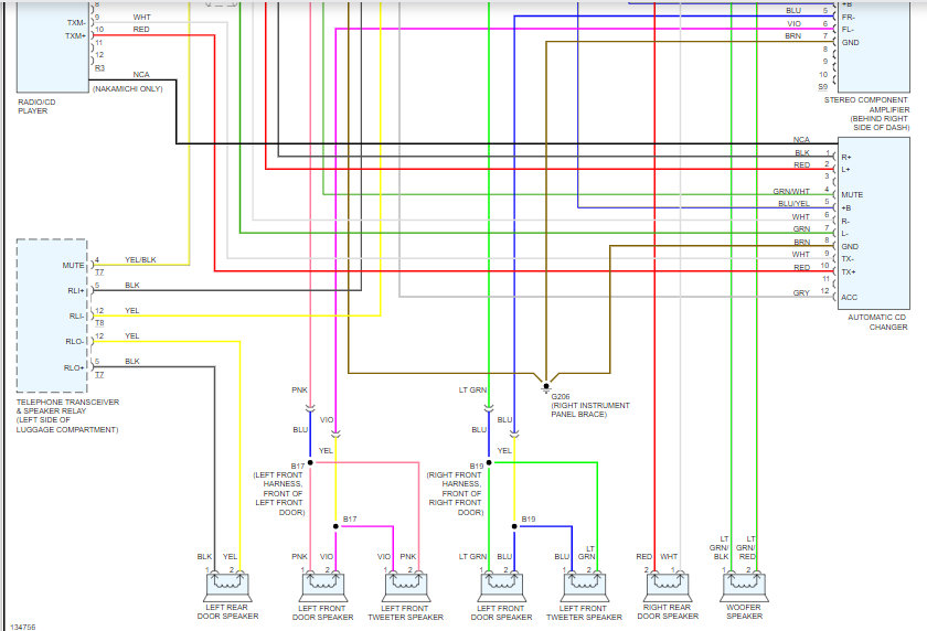

I've attached the radio wiring diagram below for your car. I've cut the picture in half so you can view larger. Hope this helps and thanks for using 2CarPros.
