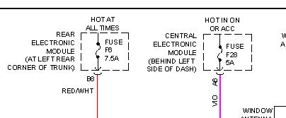

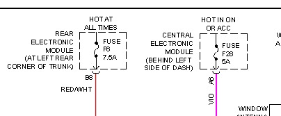

there are three fuse for the seats in different areas -see pic- if it 'gets power to switches and switches work it can be a module which would require scanning. there are two fuse sfor radio on in car an done in trunk so check trunk one. also for power seat check fuses c1 c2 and c10 in left hand side of dase an ffuse 11 for radio. for 12v power outlets check e4 and e5 in battery fuse box.

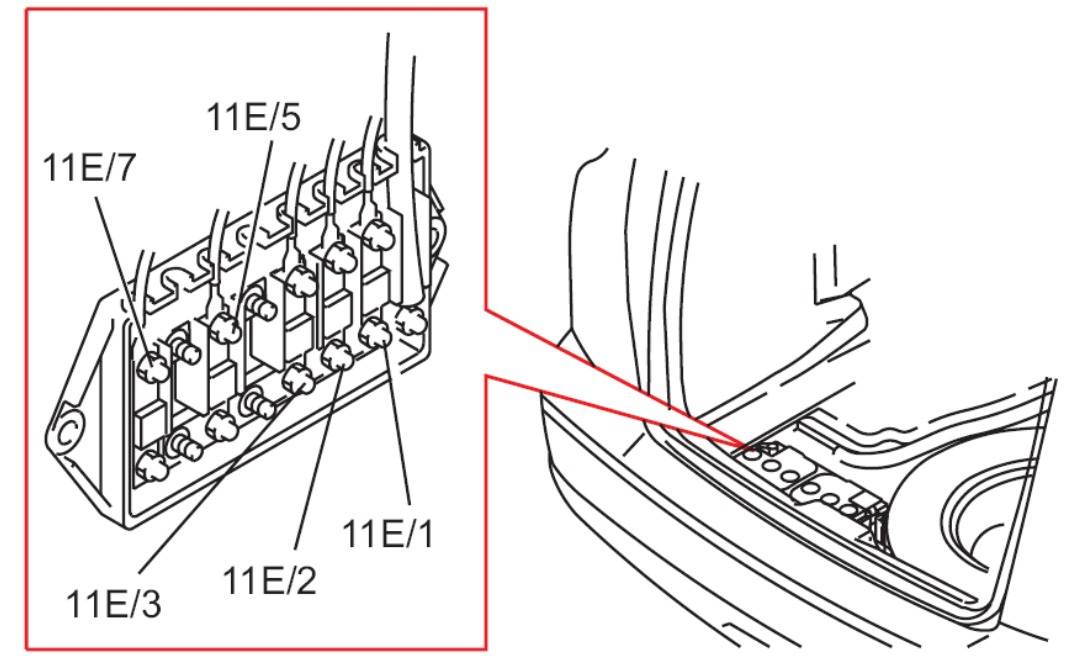

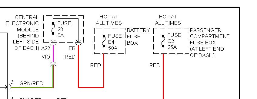

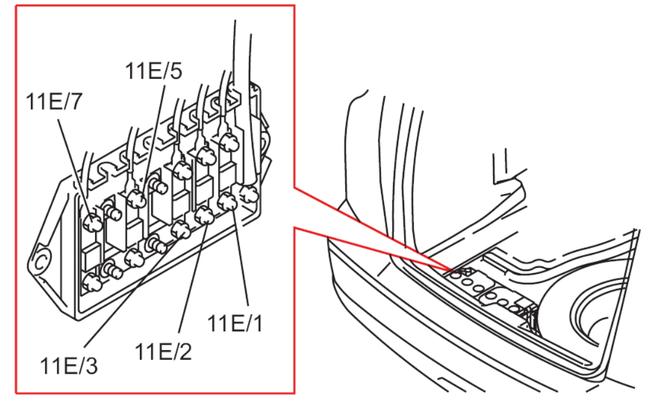

Thank you for your quick response and input. I checked all of the fuses you mentioned and have found all of them to be in good working order. The only thing I could not find was the E4 that you mentioned in the battery fuse box. The diagram you sent says E4 is a 50 amp however I could not find an E4 and there are no 50 amp fuses in the battery fuse box? am I looking in the wrong place?

it's in thetrunk by the battery sorry. the pic doesn t show E4 but in a chart it does.
