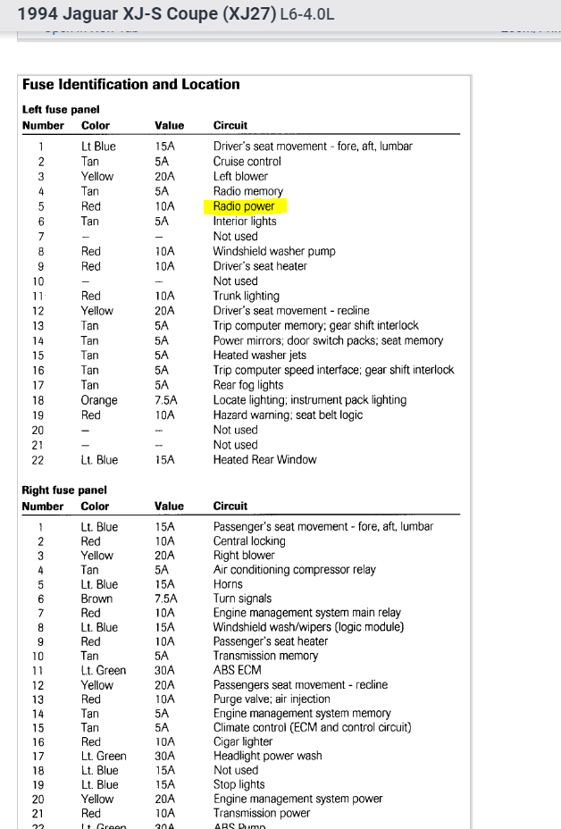

This WAIT message usually comes up after the vehicle gets a jump start. It is typically an indication of the CD changer not functioning properly.
Do you have a CD changer in this vehicle?
Also, it is likely that the shop jump started the car due to battery being discharged and triggered the message.
Try removing the fuse for the radio and re-installing it. Sometimes it will reset the message.
Before doing so make sure the vehicle is off.

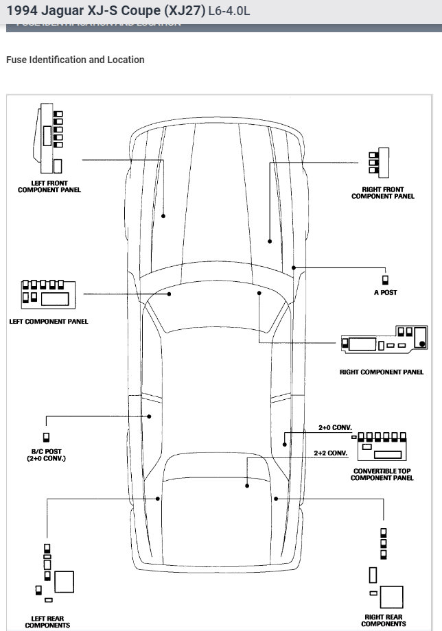

I have attached the fuse panel diagram below. It is in the left side fuse panel inside the vehicle.
Let me know of any questions.
