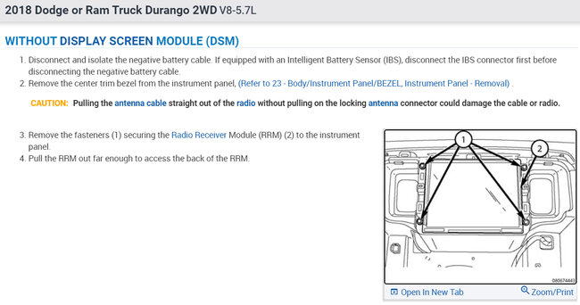

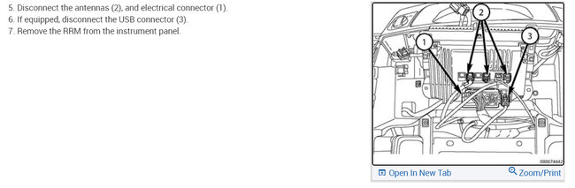

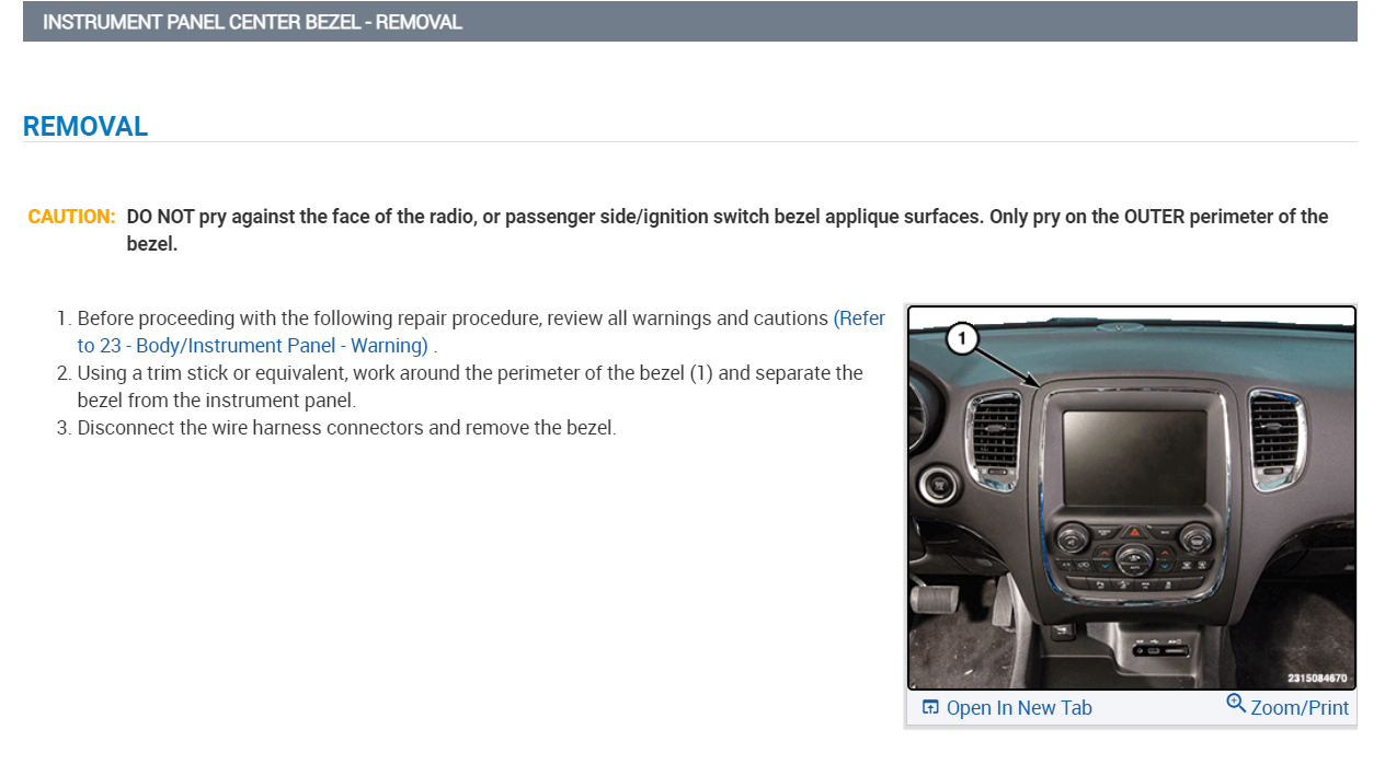

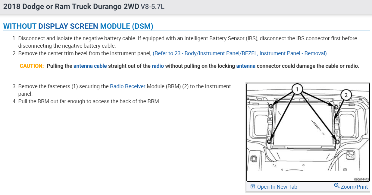

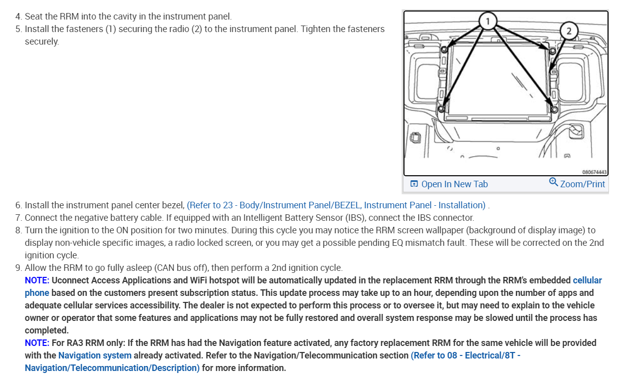

Not really, you can if you remove the radio and send it in for repair or look on eBay they have them for about $50.00. Here is how to remove the radio. Check out the images (below). Please let us know if you need anything else to get the problem fixed.
