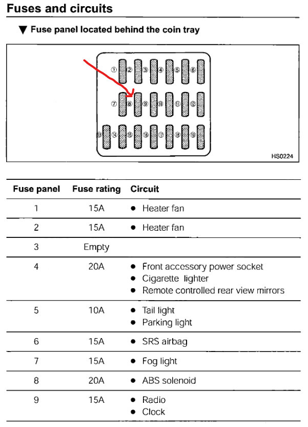

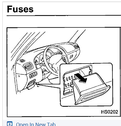

My starter went out and after I changed it, my radio stopped working entirely. I had to disconnect the battery to get to the starter, but everything was hooked back up fine. The only problem is the radio. It doesn't light up or make noise.
