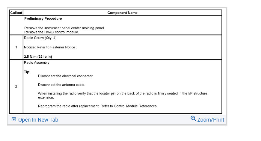

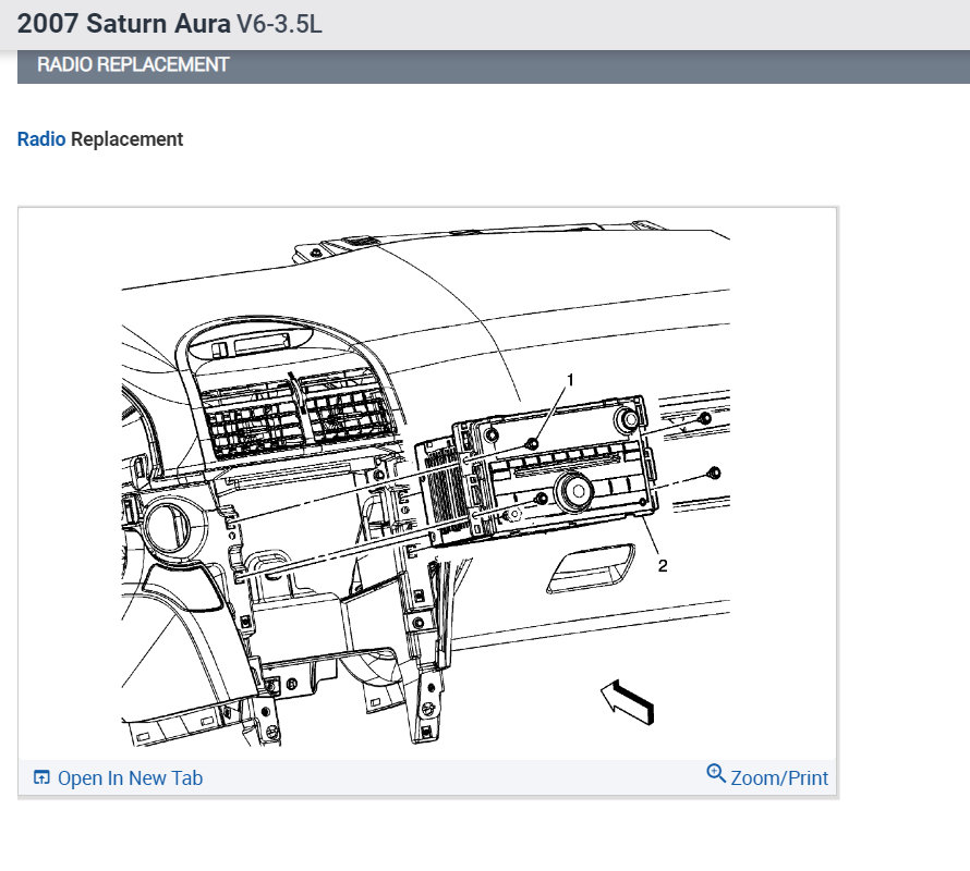

Yep, what happens is the amplifier inside the radio startts to go out this is why it pops on all of the sudden, you can get a used radio from a used parts house or check ebay, they have a bunch of used ones. here is how you can remove the radio in the images below. Please let us know if you need anything else to get the problem fixed.
