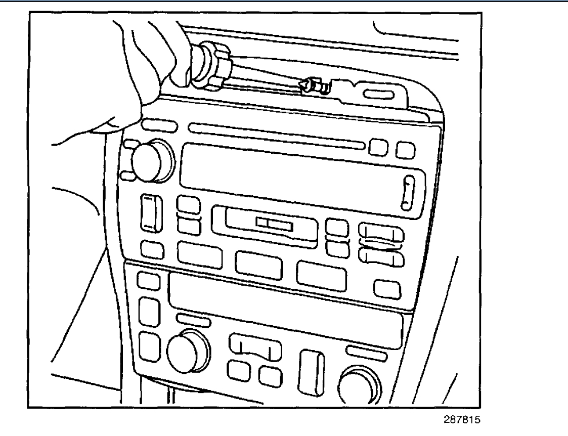

How do I remove factory radio from console? sls model.

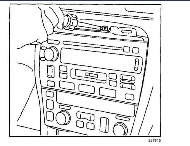

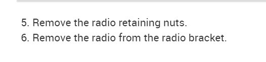

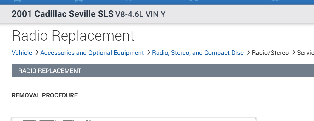

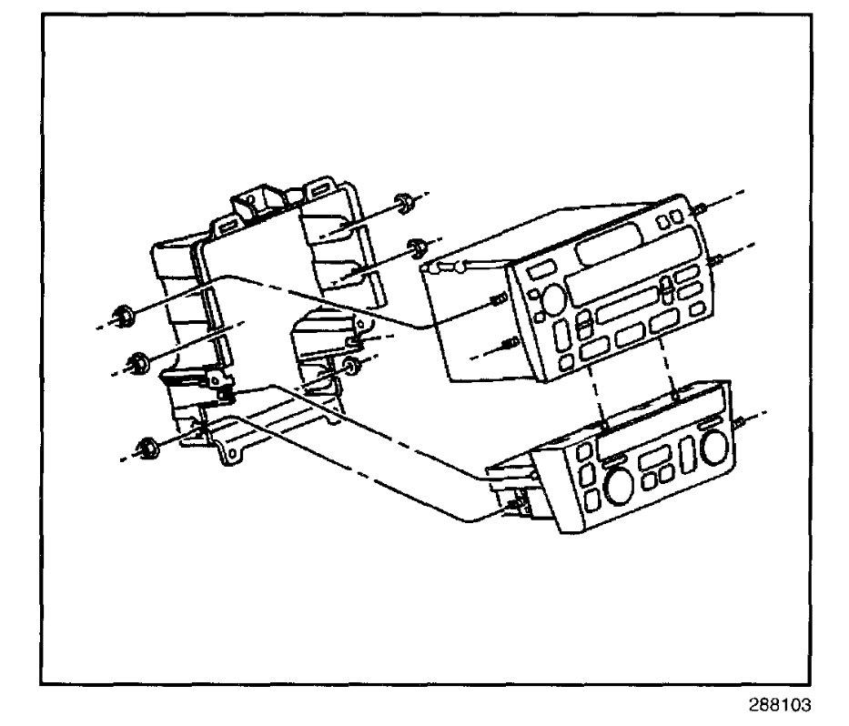

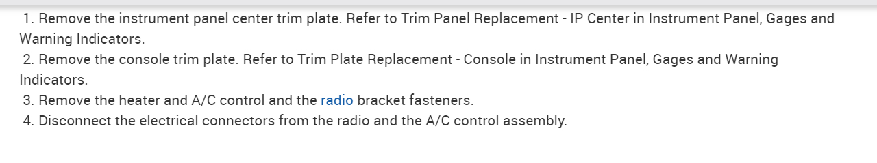

I have included the information that you requested in the diagrams down below. Please let us know if there is anything else that we can help you with.
Thanks,
Alex
