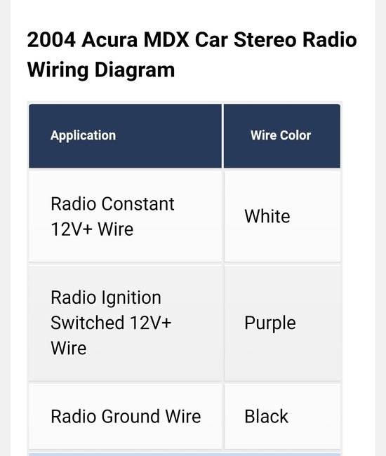

Here's the power feed wiring colors for the radio, let me know if these match what you have at the back of your radio, just to make sure we've got the right ones, you can check power on these wires coming from the ignition switch with a test light. Also check that the black ground wire didn't come loose.
Jul 21, 2020 at 4:40 PM

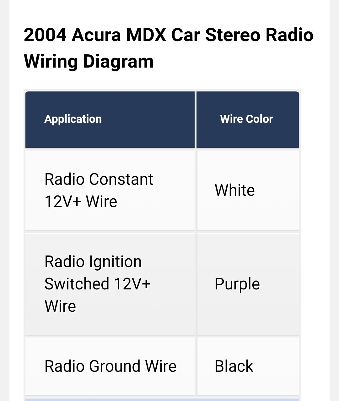

Do you have any of these wire colors at the back of the head unit? White, purple, and black. These are the wires that power up the head unit. Can you send a picture of those plugs, make sure you have power at the radio fuse too? you can check that with a test light attached to battery negative.
