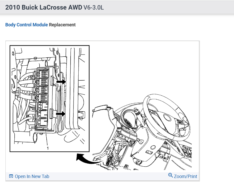

Yes, the BCM is responsible for the operation of the radio, but to be sure the BCM is bad we should do a CAN scan. You can get a CAN scanner (Controller Area Network) which will work on most cars from Amazon.

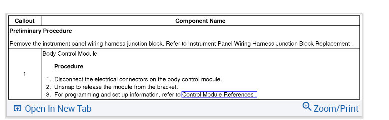

Here is the location of the BCM and how to replace it in the images below. You can get a preprogrammed unit by searching Google or Ebay. Check out the images (below). Please let us know if you need anything else to get the problem fixed.
