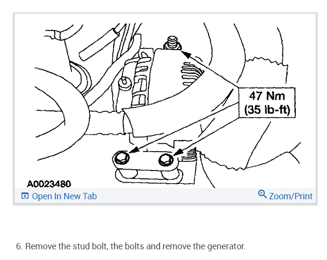

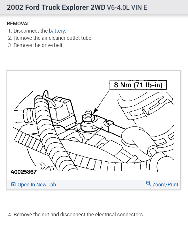

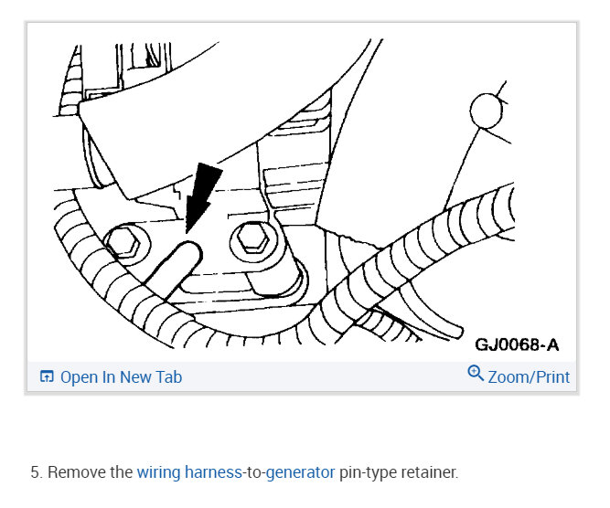

It sounds like the alternator has a diode that is going out causing voltage problems (throwing AC voltage). I would confirm the issue by following this guide and replacing the unit if it fails. here are to guides and diagrams below to help you get the job done:
This guide will walk you through the steps with instructions and diagrams below:
https://www.2carpros.com/articles/how-to-replace-an-alternator
