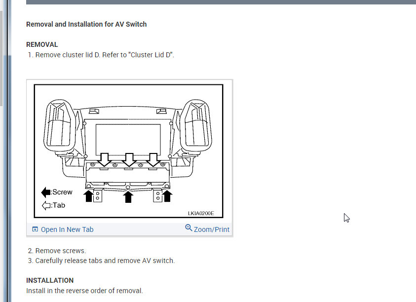

There are some websites out there that say they can provide it for you. However, this may require you to remove the radio. I included the process below for this in case you need this.
