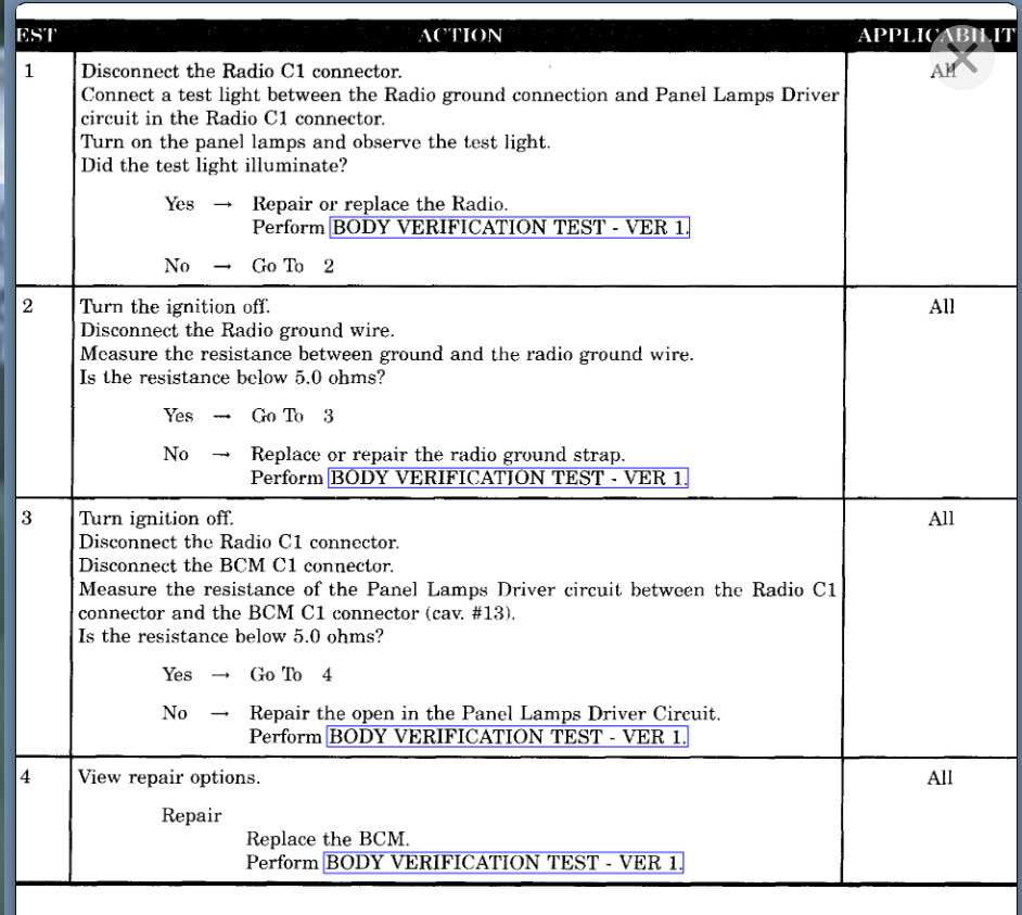

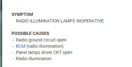

The radio/CD/Cassette player work but the display is no longer lighting up.
Dec 15, 2020 at 3:03 PM (Merged)
There are a couple possible causes of this so we need to perform the attached testing and repair as needed. Let me know what questions you have with this and we can go from there.

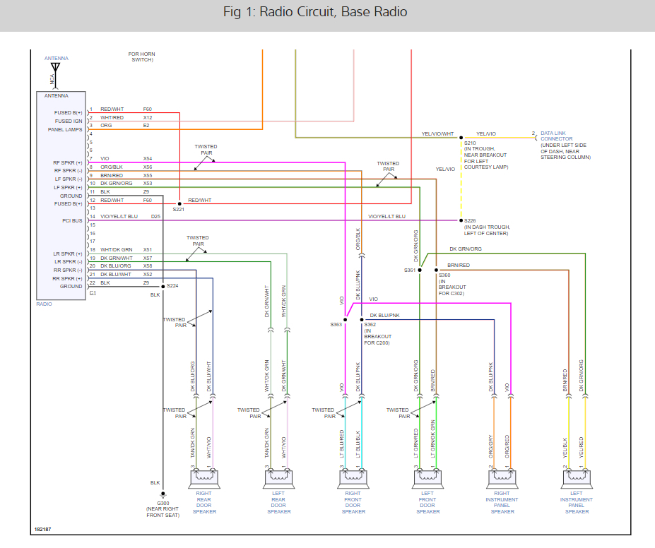

Radio seems to be okay, but no sound. Confused about your answer. Blue power antenna wire, where does that hook up? Last wire on black connector? Last number sequence, if that is the case which is pin one.
Have the infinity amp.
I have brown mute wire open.
I have blue with yellow open and blue with white open. P. Cont. Remote?
CARADIODOC
  • 34,306 POSTS
What is the rest of the story? If you are posting a new question instead of replying to the original question, new people will be coming in to the middle of your ongoing conversation and nothing will make sense.
It sounds like you are trying to install a lower-quality aftermarket radio and use the vehicle's remote amplifier. Unlike with GM and Ford systems that must be used as a matched set, Chrysler radios can all be used with or without the amp, but if not matched correctly, you will have too much or too little bass. Chrysler amps do not increase volume or power, so they can be used with an aftermarket radio, but they will not have the same tone response as the original one had.
The amp gets its turn-on signal from the circuit at the radio that could also turn on a power antenna. That is usually labeled as the "power antenna" wire on aftermarket radios, and in a loose attempt to standardize wire colors, that is typically a dark blue wire.

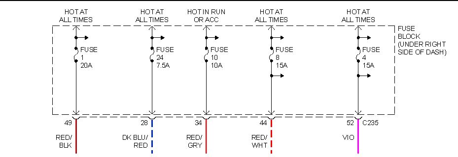

You need to check all fuses in pic, use atest light if you have one.
