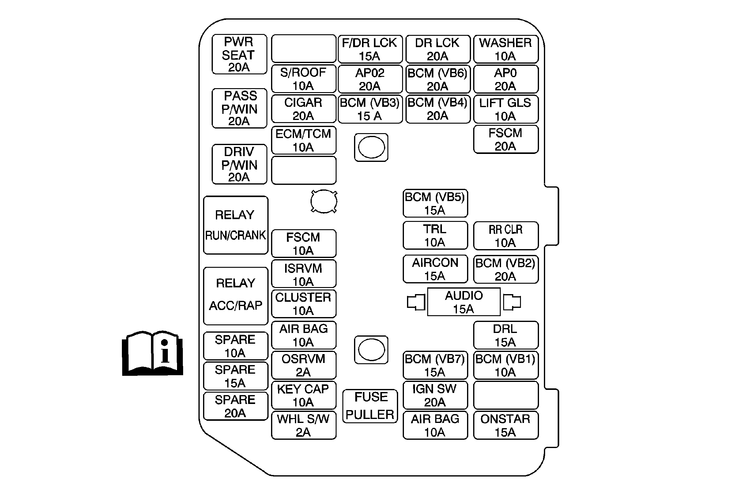

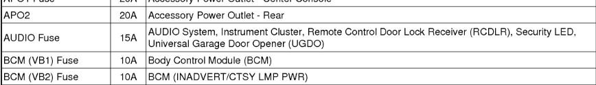

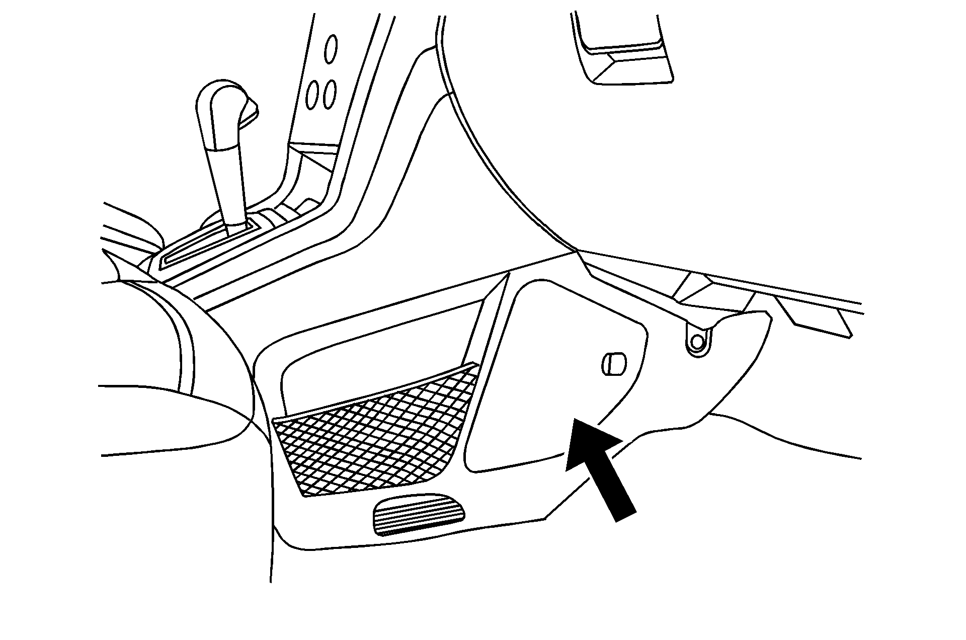

The first thing to check is the audio fuse. I attached three pics. The first shows the location of the fuse box which has the audio fuse. The second shows fuse location in the box. The 3 indicates the fuse amperage as well as what it powers.
