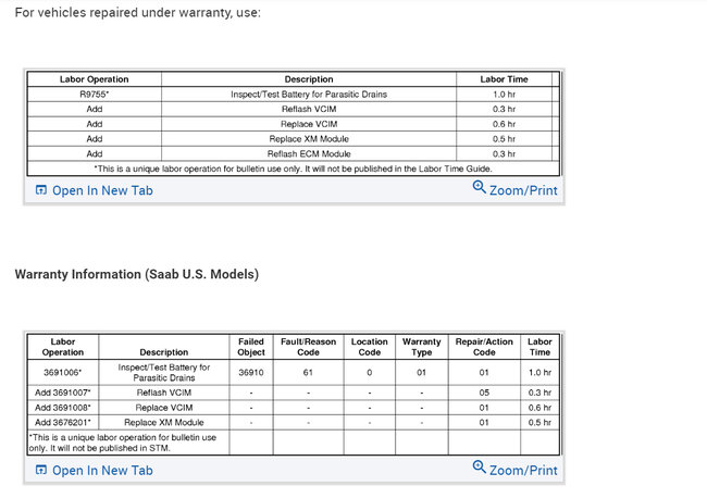

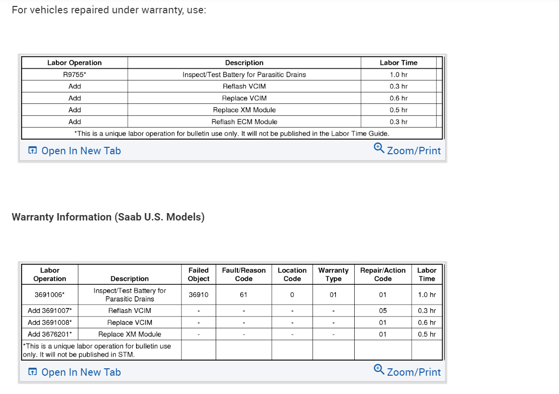

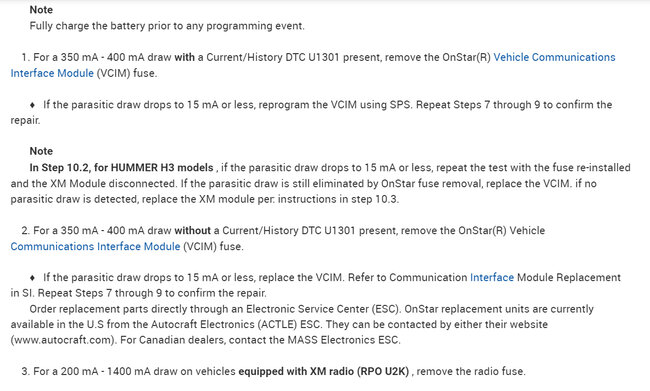

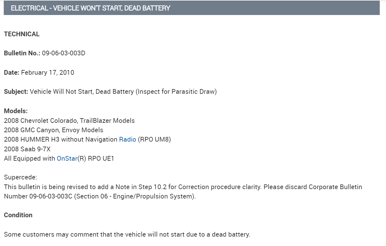

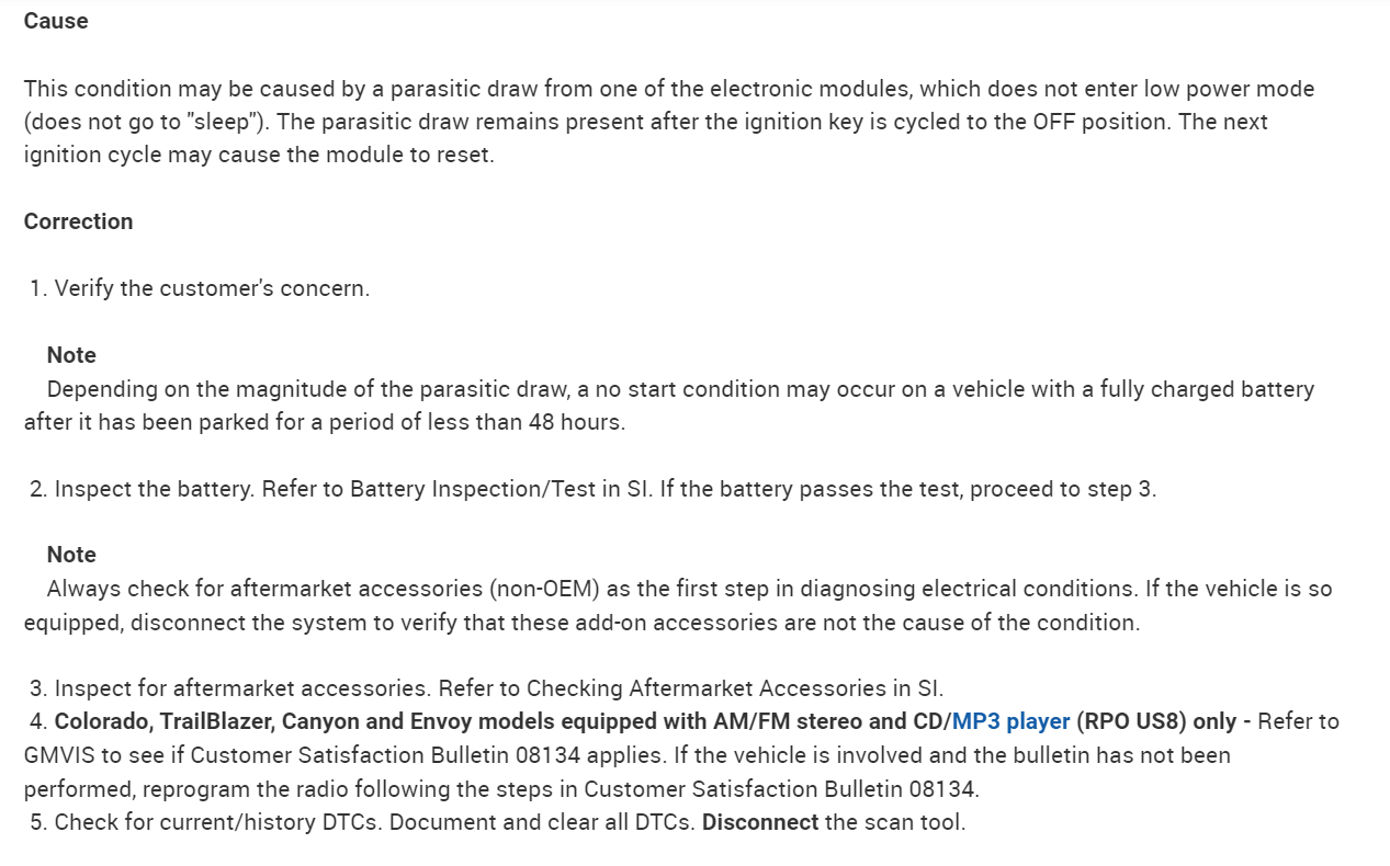

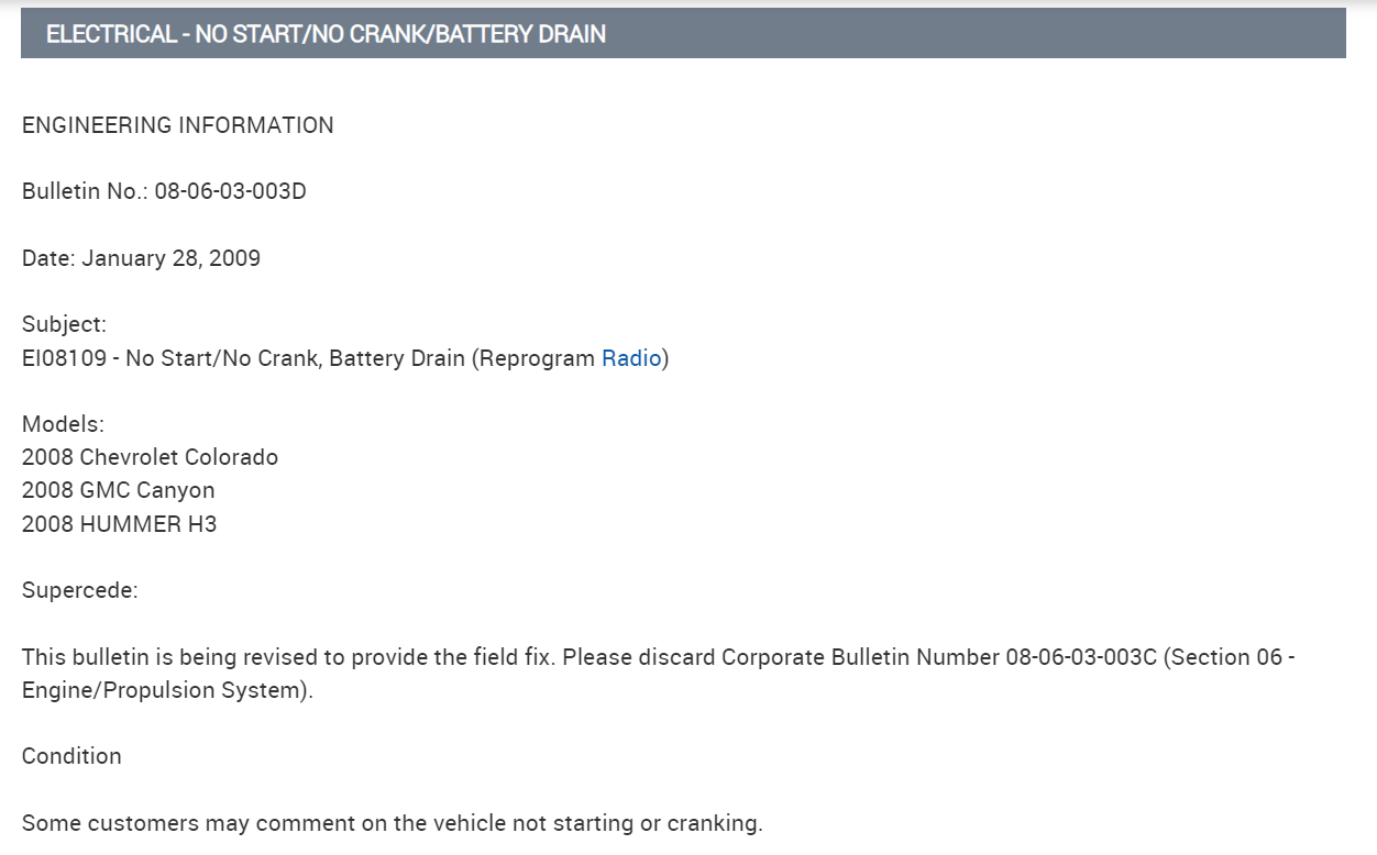

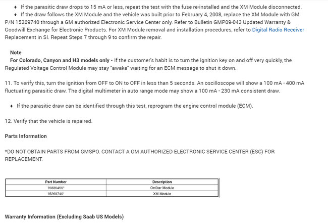

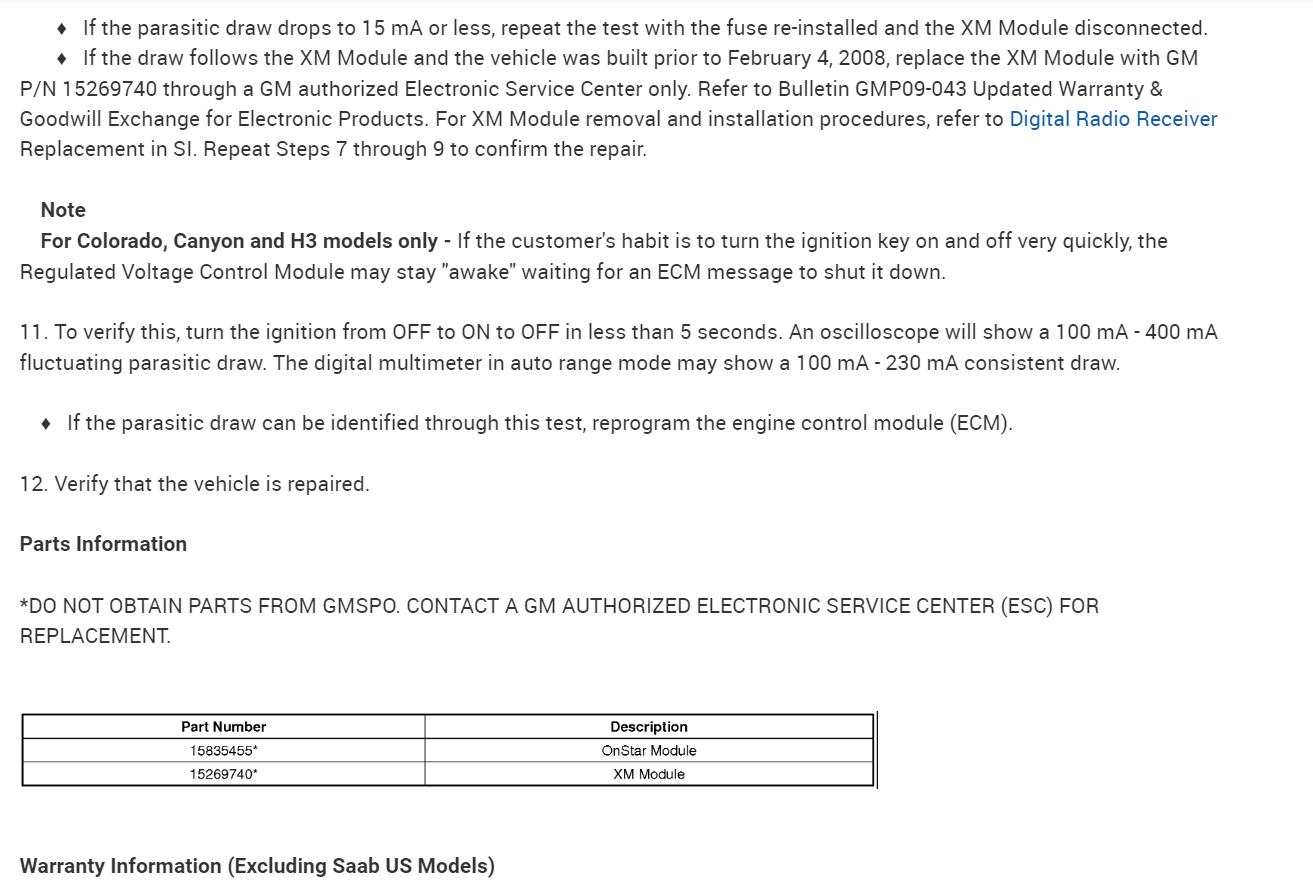

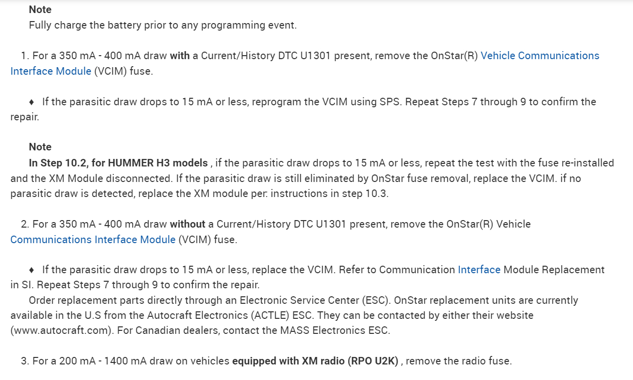

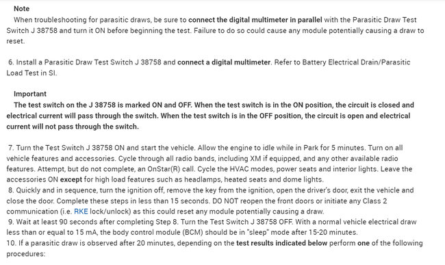

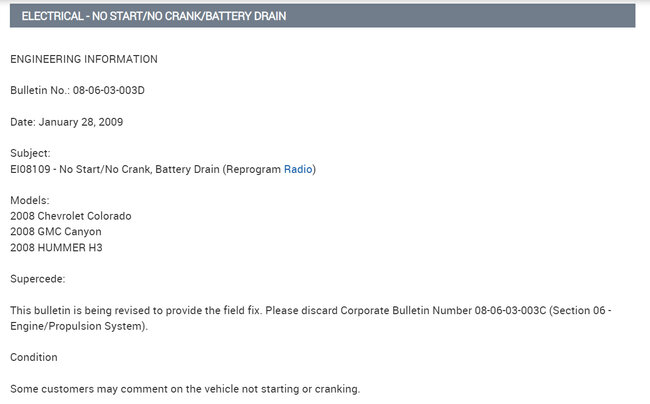

Note: There is a Technical Service Bulletin on this exact issue, I will post it below, so this is a known problem with this model vehicle.

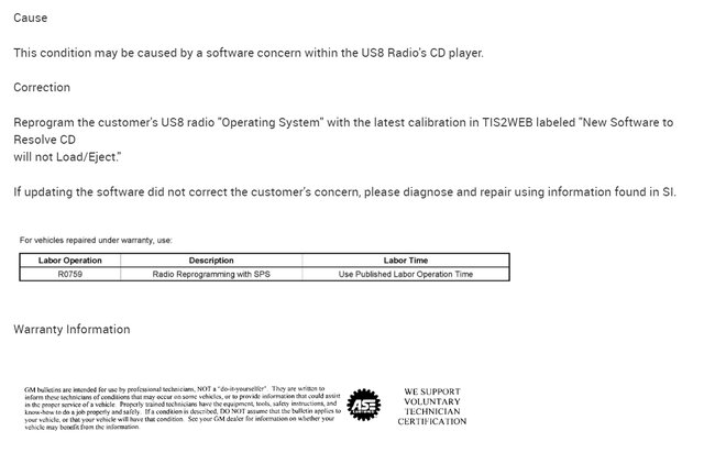

Okay, there are actually 2 TSBs for this issue, one has to do with having the Radio reprogrammed if it is not an aftermarket radio, Ill post that one first, it is pages 1 and 2 below.

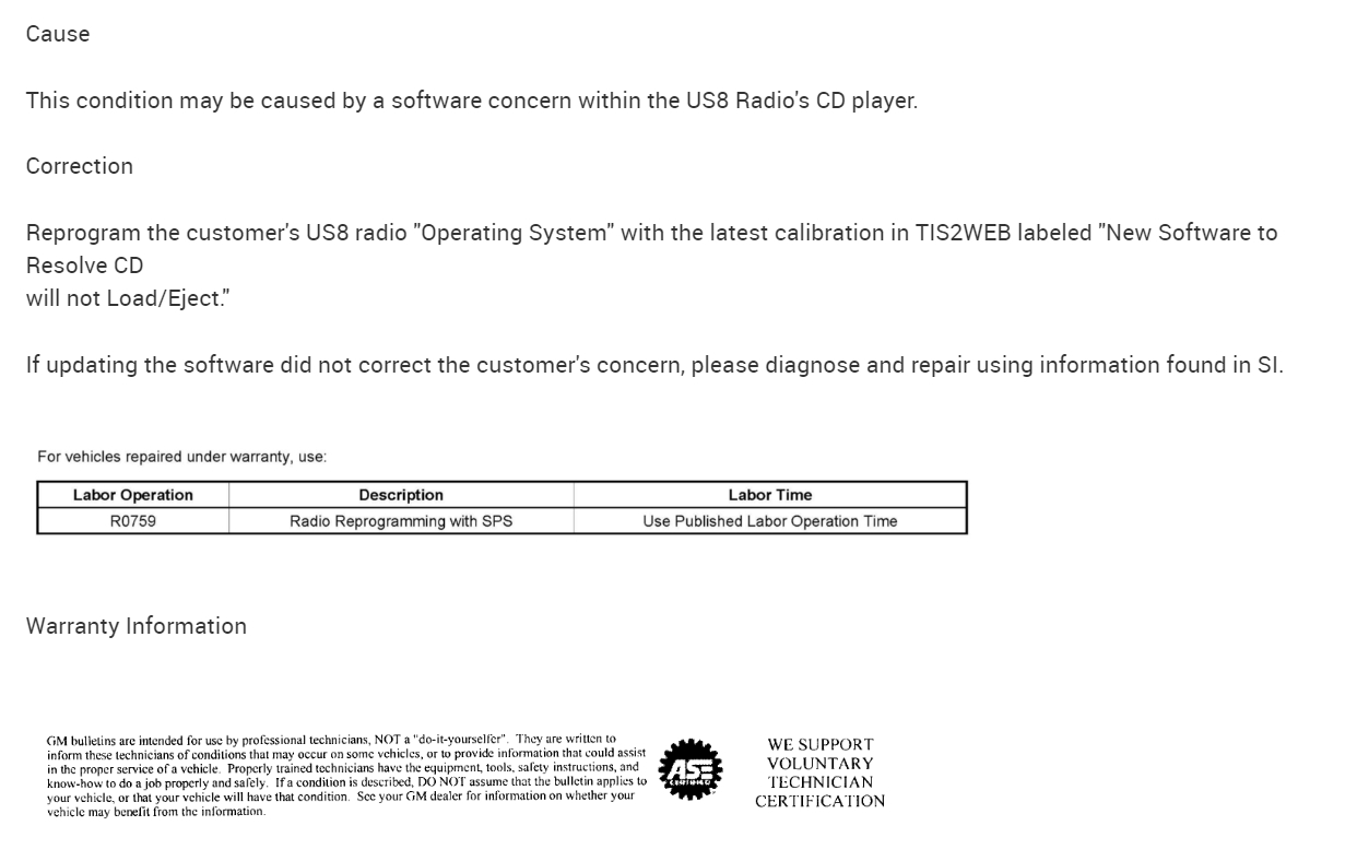

The 2nd TSB is pages 3 to 9. If you do not have aftermarket Radio installed, the dealership may do the reprogramming for free since it is a manufacturer defect in the software.

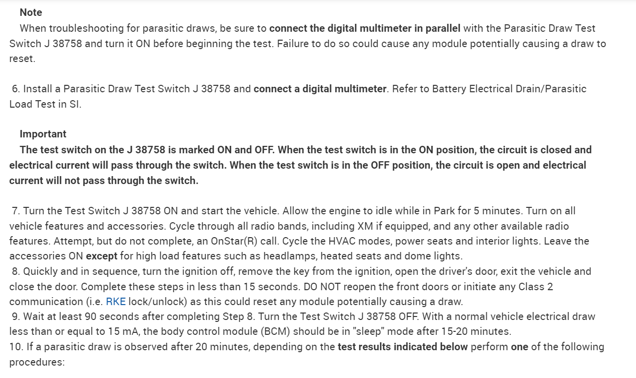

But either way, they have a procedure for checking the battery draw on the radio if it is the OEM original equipment. If it is aftermarket, it can still be another module in the vehicle waking the radio up at certain time intervals and causing a drain on the battery overnight.
