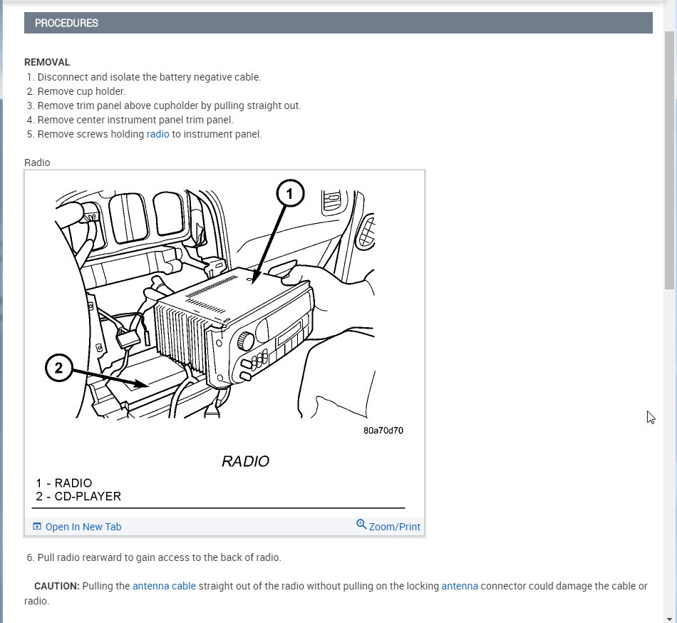

Sorry, if I am misunderstanding but are you asking if we have the actual part or are you looking for information about it? If you are looking for the actual part, we do not supply parts as we are not a parts website. We only provide technical support to help diagnose or replace components.
I attached the replacement procedure if that is what you are needing. Thanks
