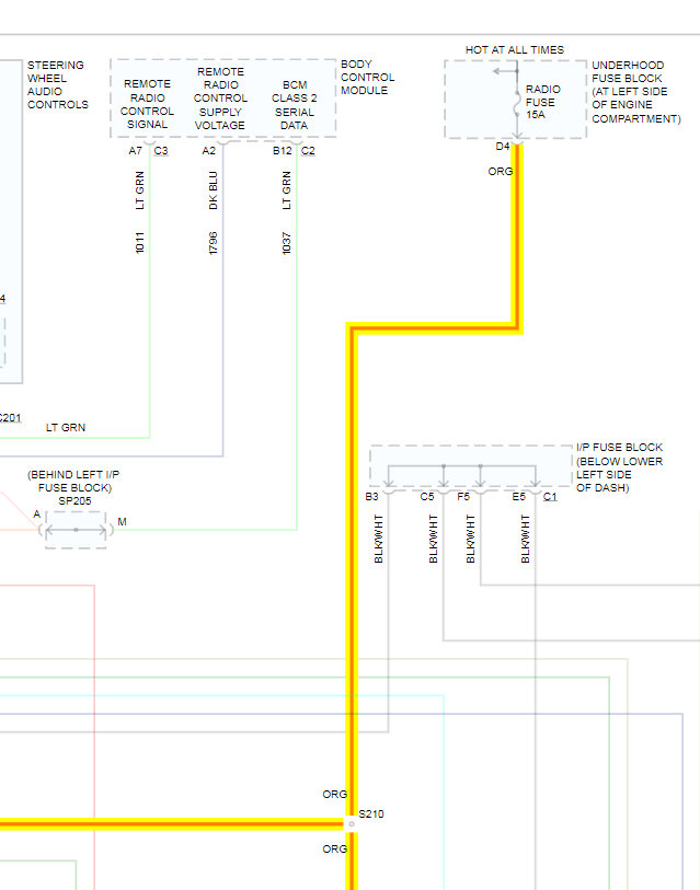

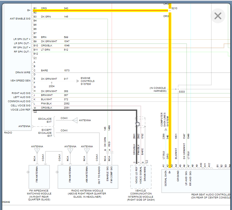

You have to appreciate that the engineers went through a lot of work to make their diagrams difficult to follow, then it gets worse when they get translated into online diagrams by another person. I found this one that shows all the places current could be going from your radio fuse, but instead of making separate diagrams for every version of optional equipment, they combined them all into one diagram, then you have to figure out what is relevant to the truck you're working on. I was going to use different colored arrows for each version, but as an experienced tv / vcr / car radio repairman, even I got confused with all the different options, and I had to give up.

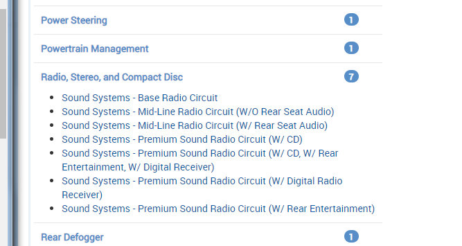

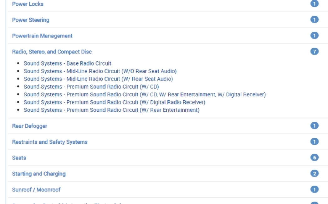

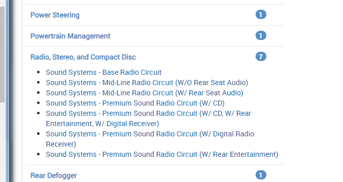

Take a look at this list and see if you can figure out which diagram is the correct one for your truck. That would insure we're working with the correct list of optional equipment. This is the same list KASEKENNY1 posted earlier, but unless I missed it, I didn't see your answer to which system you have. His list appears to be from the original manufacturer's diagrams. My list is from the aftermarket, (translated) diagrams.

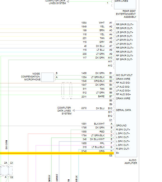

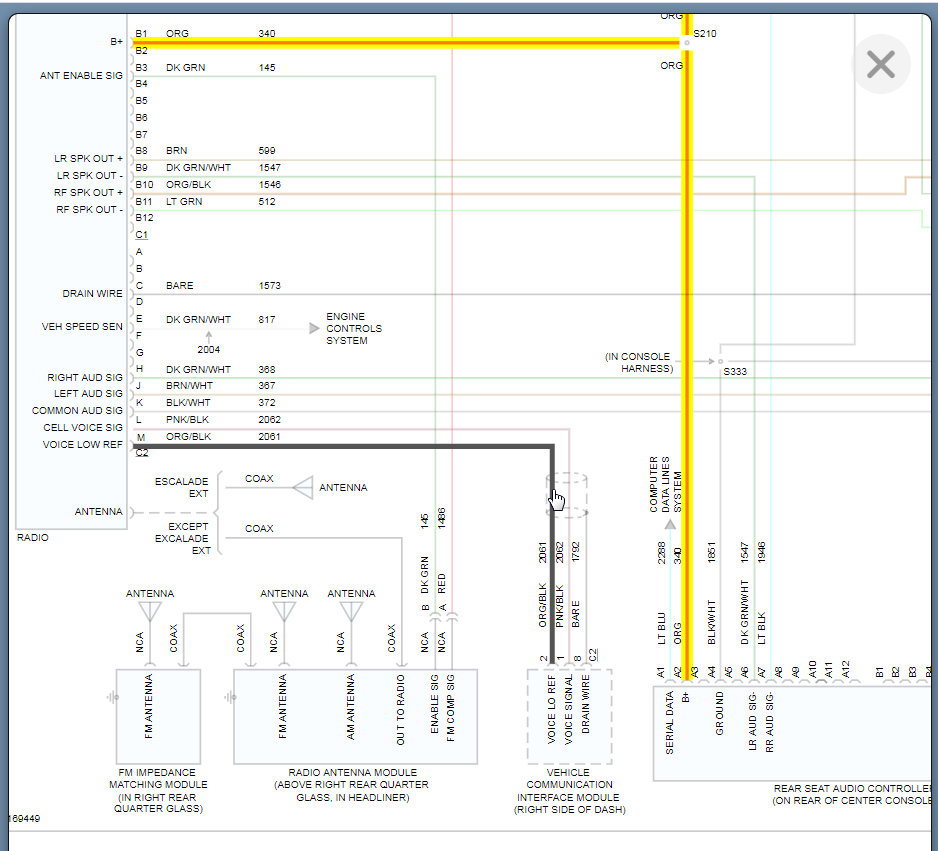

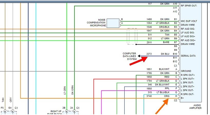

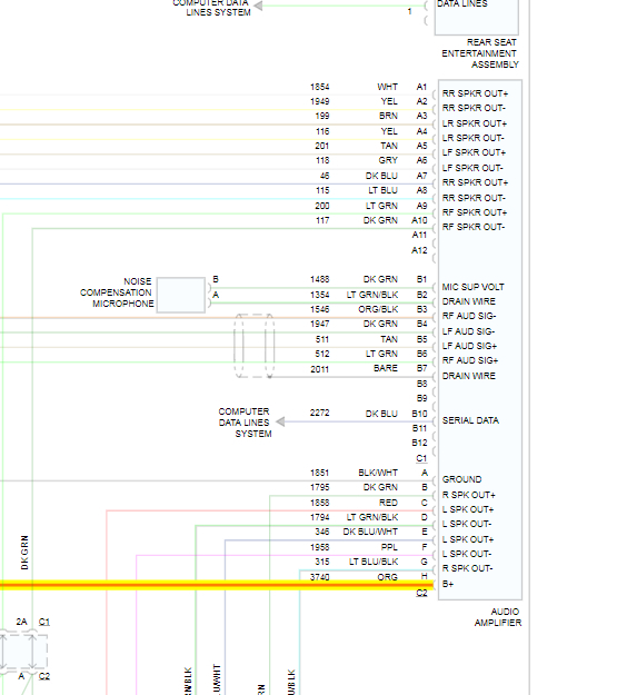

The last diagram is also from the aftermarket ones. They leave out a lot of things like splices and inline connectors, but they pack more information in one diagram. This is a partial diagram of the amplifier. I focused on that because you mentioned there was a related problem with that, but you didn't say what it took to solve it. This partial diagram is from the, "Premium Sound Radio Circuit (W/ Digital Radio Receiver)".

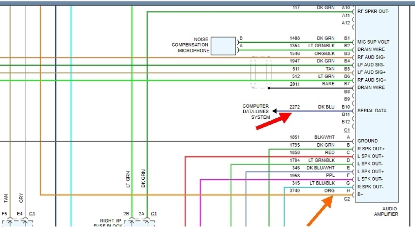

This diagram shows this type of system. The orange wire, (orange arrow), goes back to the "radio" fuse and is hot all the time. The switching is done inside the amp by a circuit that is told what to do by the digital computer signal that comes in on the data buss, (red arrow). It was not that unheard of for the switching circuit to short and keep the amp powered up all the time, and that would cause the drain as you described. Other than that, the amp will work just fine. Where this used to get confusing is you could pull the "amp" fuse and lose the current drain, but there was often a second power source for the amp. That used to come through the radio's power switch and was meant only to be a low-current turn-on signal. With the fuse missing for the amp's high-current circuit, it would use the radio's turn-on current as a back-up current source, so to speak, and under low volume, it could appear to work normally. That higher current put a lot of stress on the radio's on / off switch contacts. Later, most radios used an internal relay to switch power on and off, and the high current for the amp put a lot of stress on its contacts and solder connections.
The point of that sad story is even though everything appears to be working, check for 12 volts on that orange wire to the amp while it's paying. If you find 0 volts there due to how you cut or disabled that circuit, it is getting its power from an alternate source, and the actual cause of the drain is that amp. This is where the drain you found is still there when the radio is unplugged. It would drop lower if you had unplugged the amp.

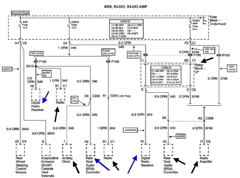

When you ran a new wire to the radio, did you cut the orange wire off the radio's plug and isolate it? If so, the drain should come back when you apply 12 volts to it on either end. If that happens, unplug each item you can find that I have an arrow pointing to. That should tell us which one isn't turning off.
