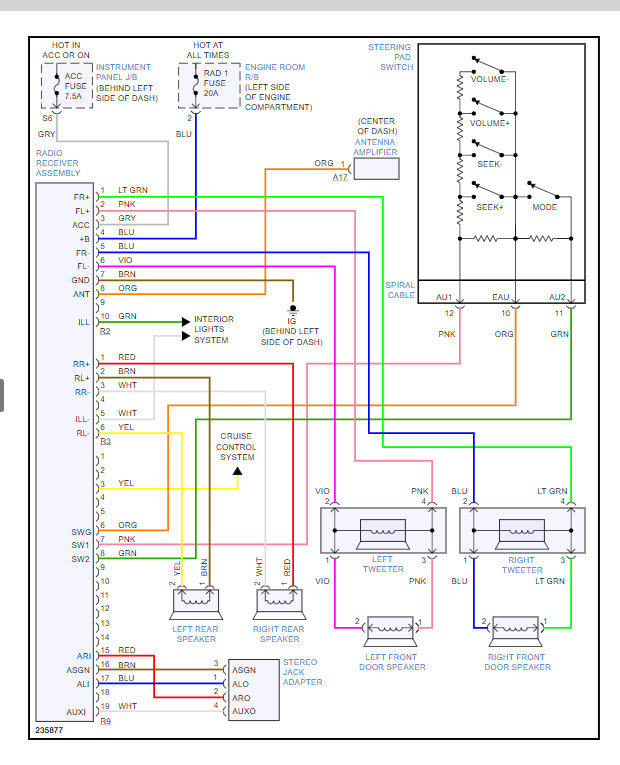

I understand. I feel that there is just no output from the radio. Here are the wiring schematic for it in the diagrams below and a guide to help test it.
Check out the diagrams (Below). Please let us know what happens.

No i don't, unfortunately. I have reason to believe that the cause is the fact that there is only one wire harness connected to the back of the HU when i believe there should be 2, considering all of the loose wires (where harness #2 should be) the old owner of the car must have messed up the wiring before i purchased the vehicle and now im stuck with a mess.
Mar 4, 2015 at 11:11 PM
Most likely you're right. Usually there is one plug for the power supply and another for the speakers. However, if you wired an amp to it, then you had to wire to the speakers and there had to be an output from the radio.
