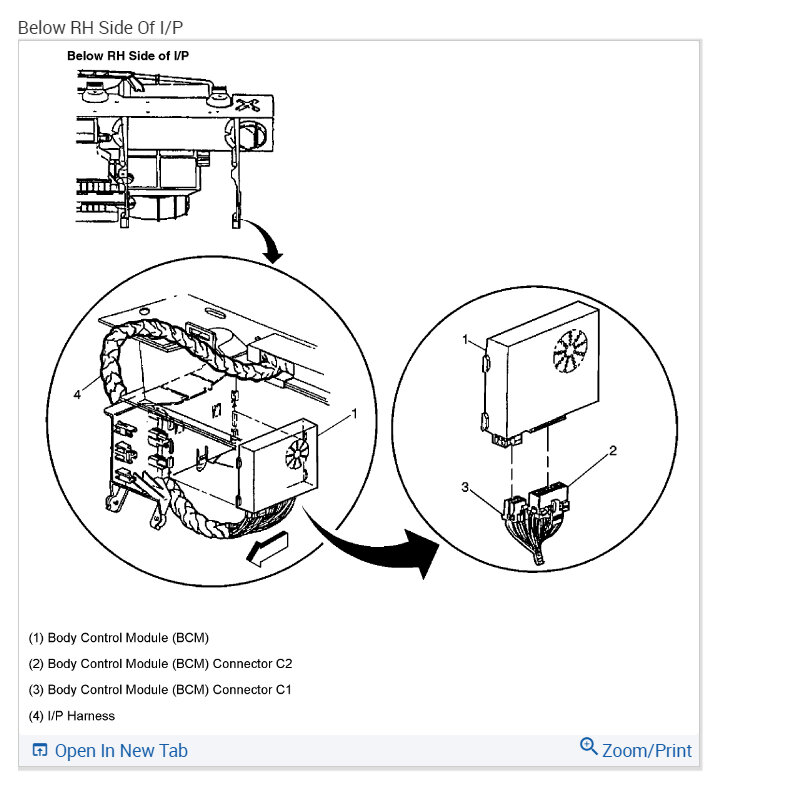

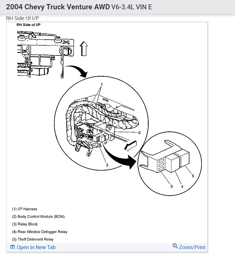

It sounds like the BCM is going out, but the fuse is located under the hood on the left side labeled "radio" here is the location of the BCM and how to change it out in case you want to fix the problem, you can get a preprogrammed unit by searching Google or Ebay. Check out the images (below). Please let us know what happens.
