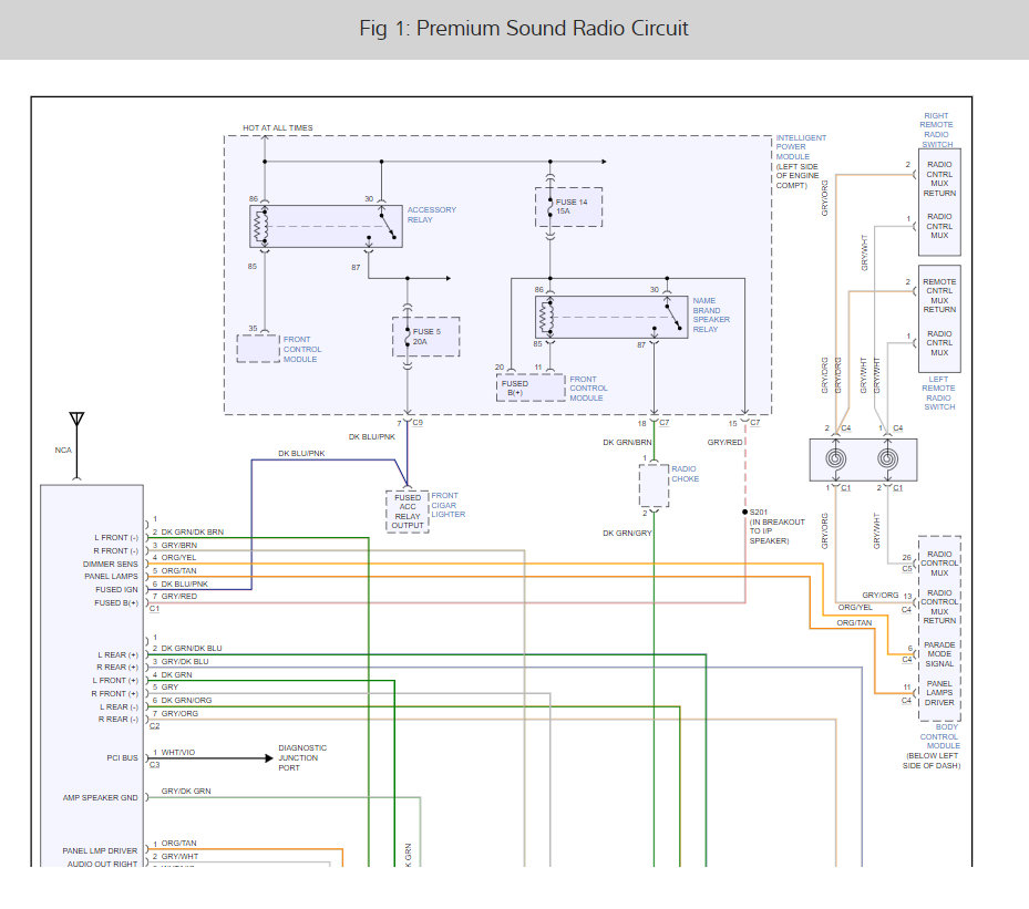

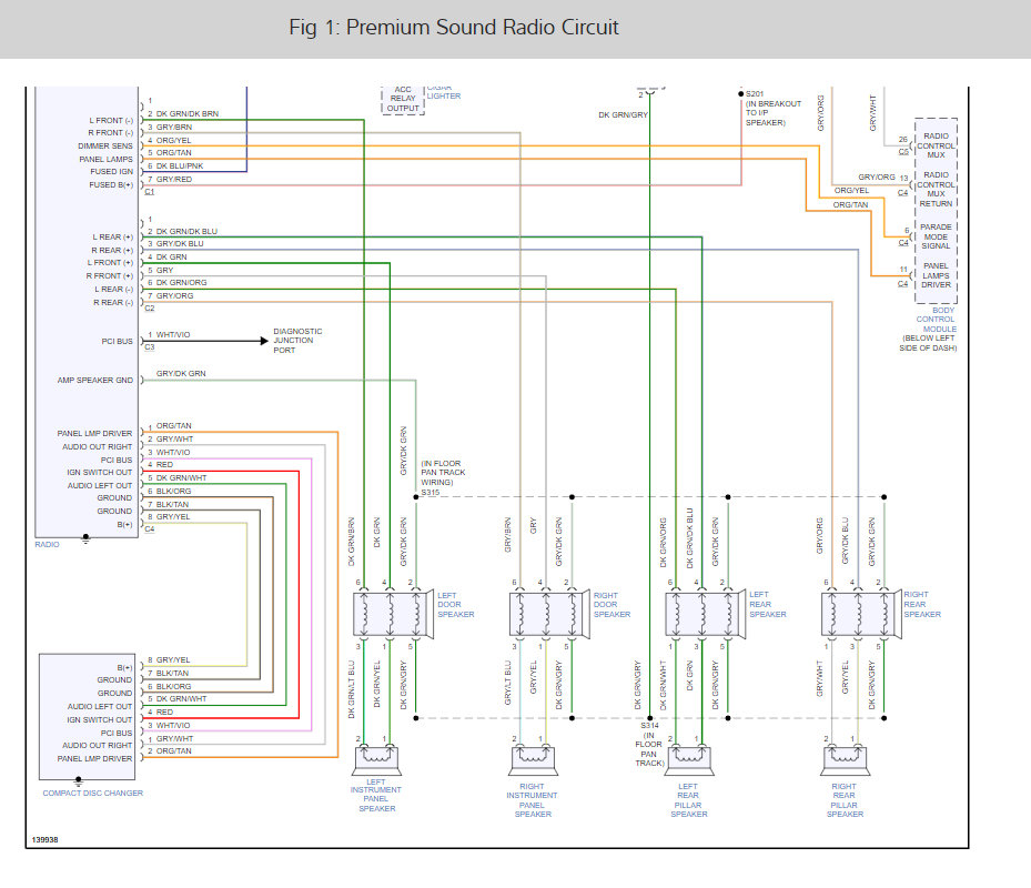

I have read your thread on several of these. I replaced my radio and CD changer with a Boss BV9358B with Bluetooth, DVD/MP#?CDAM/FM receiver and backup camera which i have yet to connect. After installing it everything worked but no sound. I called Boss they asked me to check the blue white wire to see if it was connected in the aftermarket harness. I had connected the antenna wire (solid blue) instead of the power to the amp. I corrected that and there is still no sound. All the displays and menus work. Any suggestions?
Boss said they would replace the new unit. but Covid has stopped shipments in California.
Radio Daimer/Chrysler P56038518AJ CD changer P56038531AD
Jan 16, 2021 at 4:00 PM

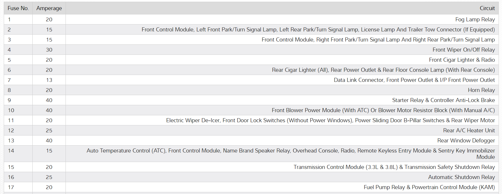

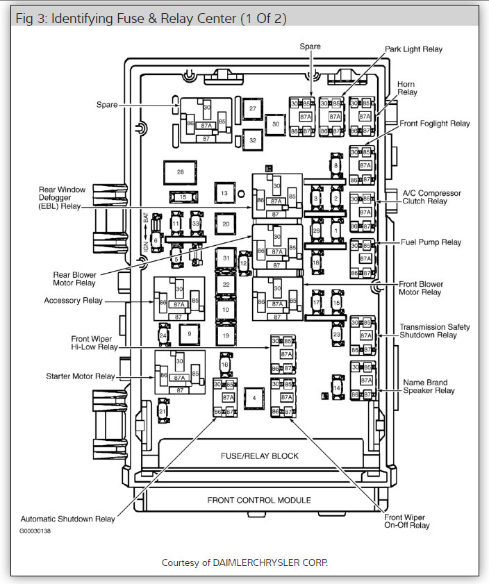

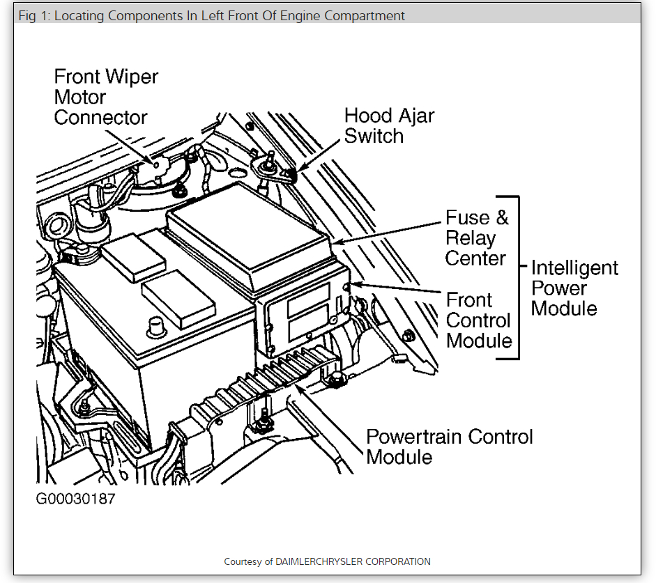

There is a name brand speaker relay we need to make sure is working. here is a guide to help you check it with the radio wiring diagrams so you can see how the system works. Also check fuse 5 and 14.

I am needing the wiring codes because the wiring plug has been removed before i purchased the vehicle. It is equiped with the 8-10 speaker infinity sound system but i only know the codes for four sets of speakers. Can anyone help?

Gray plug, starting away from the keyway:
Pin 1 is not used
Brown / Red: LF speaker -
Dark Blue / Red: RF speaker -
Yellow / Black: tail lights (dims the display)
Orange: dash lights (tells the display how much to dim)
Red / White: 12 volts from ignition switch
Pink: 12 volts all the time (station preset memory and clock)
Black plug, starting away from keyway:
Dark Green / Red: Power antenna / remote amp
Brown / Yellow: LR speaker +
Dark Blue / White: RR speaker +
Dark Green: LF speaker +
Violet: RF speaker +
Brown / Light Blue: LR speaker -
Dark Blue / Orange: RR speaker -
You can snip these plugs out of any Chrysler product from the early 1980s to at least 2000 in the salvage yard. A few models including the full size vans used them through 2002. They were consistent with the four power and dash light wire colors, but the speaker wires will likely be different colors depending on the car model you get the plugs from. Note that there is no ground wire in the plugs. A lot of installers confuse the tail light wire with a ground because of the color and its low resistance to ground. Connecting an aftermarket radio's ground wire to the Yellow / Black wire will cause the dash light fuse to blow when the headlights are turned on. The ground wire is a black wire clipped to a prong on the rear of the radio or a braided strap bolted to the rear of the radio. The radio will also be grounded through the braided shield of the antenna wire, but this is a very poor ground for the power circuits.
