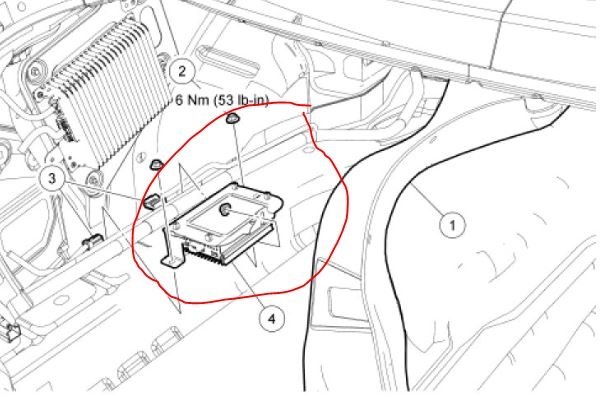

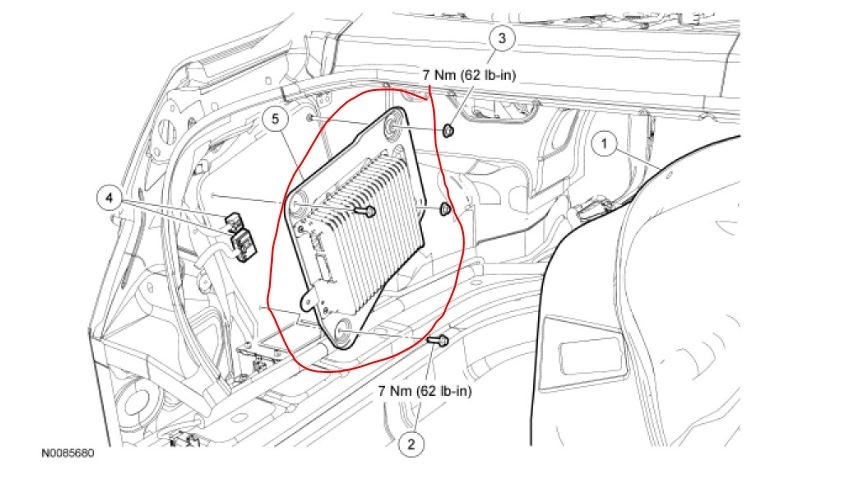

Based on your description, it sounds more like an amplifier issue. The vehicle has two separate ones. If you look at picture 1 below, it shows the sub-woofer amp. Picture 2 shows the audio amp. I would start there and check for connection issues.
Let me know what you find.

Thank you! I will get back there by this weekend and update you on my findings. I know the second picture shows the radio amp in the trunk. is the subwoofer amp below it in the trunk as well or is that under the center console/ radio area?

Hello again, I was finally able to get back in the trunk and remove all the fabric to get to the amp and the area the schematics say the sub amp is. I found the amp and looked toward the bottom, on top and around other areas of the trunk but was not able to find the sub amp. I think it is up near the sub woofer under the rear deck plastic cover behind my back seats. Will be looking into it sometime soon hopefully this weekend. Any extra thoughts?

Was able to take back seat completely out and get to rear deck. Found a plug just sitting in the sub amp not clicked in once I clicked it all problems went away. thank you for your help!
