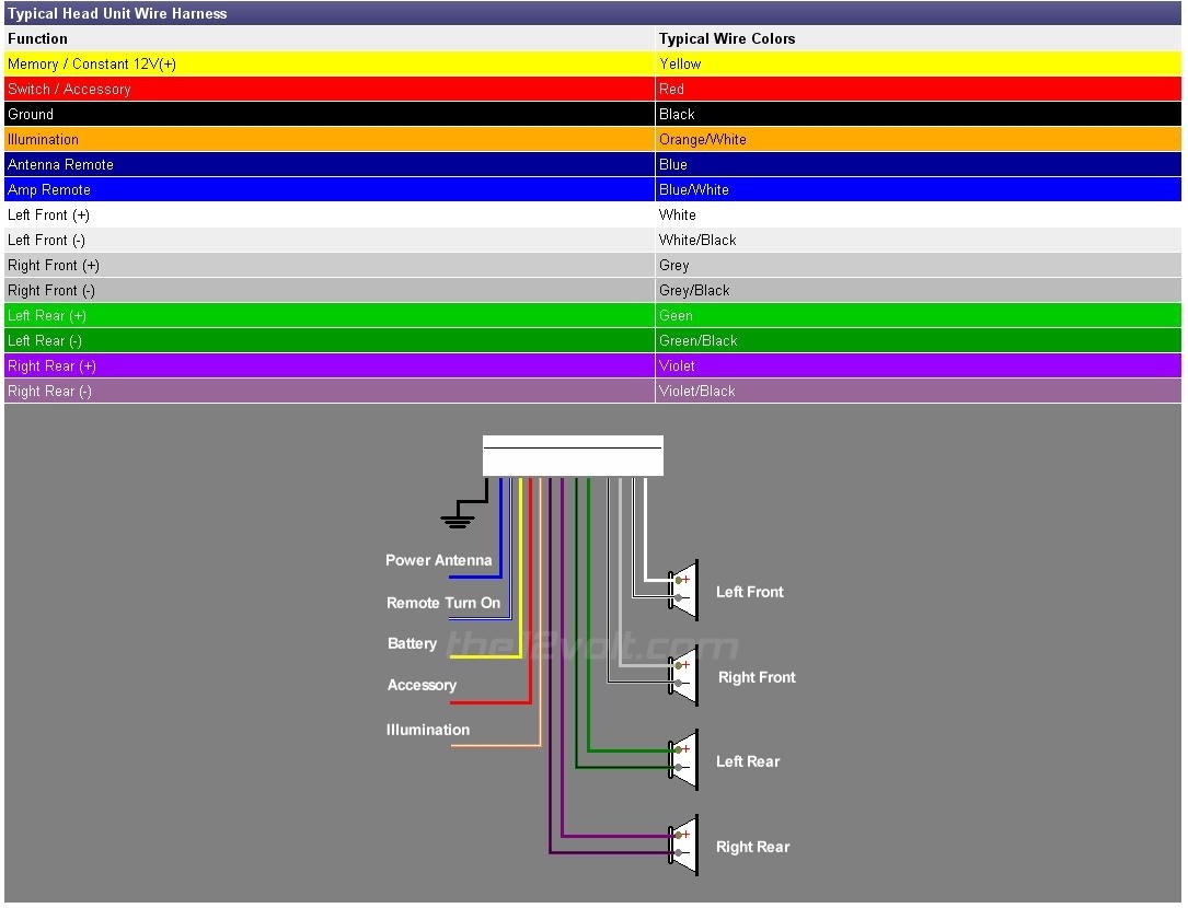

I need a wire diagram to install aftermarket radio.
Sep 27, 2022 at 8:21 AM
MIKE H R
CERTIFIED EXPERT
3,094 POSTS
Here is a diagram of the wiring you asked for, I hope that helps you install the aftermarket radio. You can always get in touch with us if you need anything else, we are here to help.
