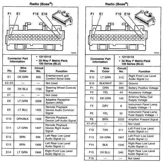

The first file shows the relay in the factory harness. Would this be the antenna connection? My aftermarket radio harness has a built-in wire in the harness. The second picture is the entire factory harness with wiring description.

Hello again.
Yes, you would use your factory harness dark green wire to be connected to the antenna power wire on your new/aftermarket radio. Hope this helps and thanks again for using 2CarPros.
