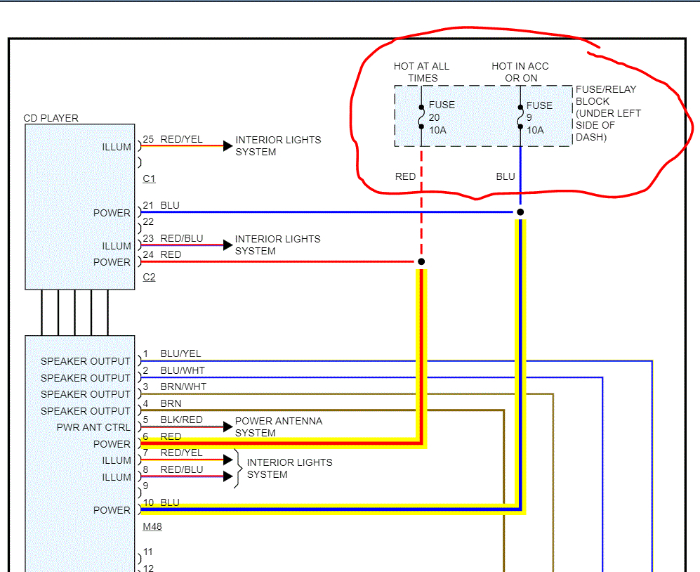

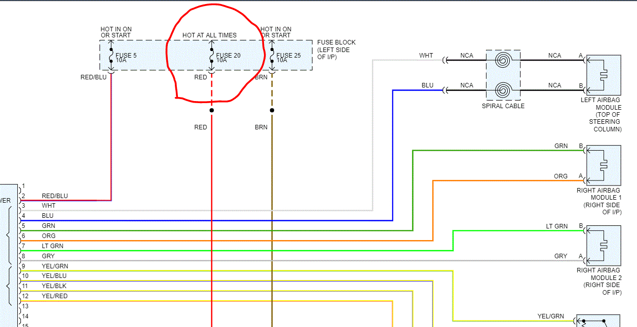

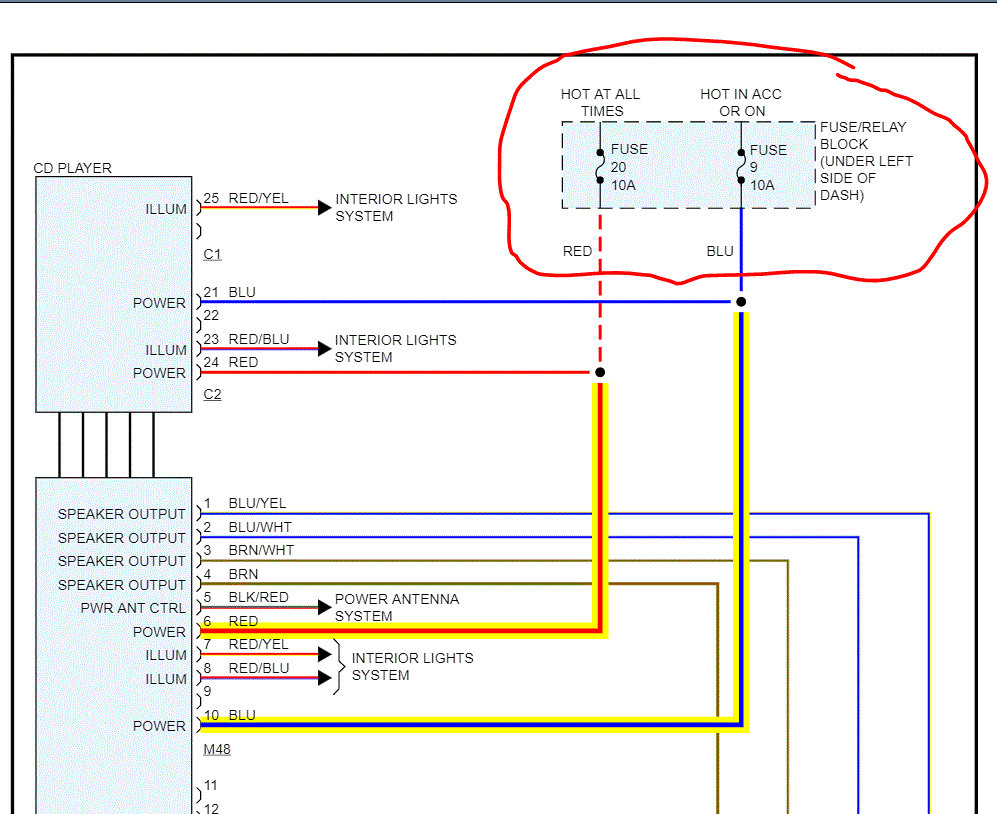

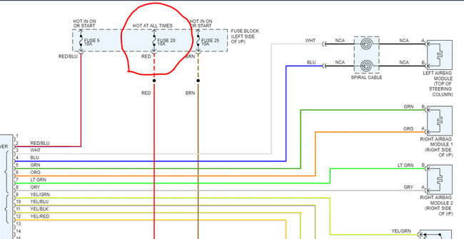

Hello everybody, I bought this car about a year ago and it had an aftermarket radio in it which worked great despite being a little old. I decided I wanted to replace it with a newer model, took it out only to realize I needed a new wiring harness. I put everything back together and found that my clock stopped working as well as my radio and power antenna. The airbag light came on too. I just bought a new wiring harness for the other radio, installed it, checked every fuse, and plugged the radio in. Still nothing. Does anybody have any advice for me? Thanks in advance.
