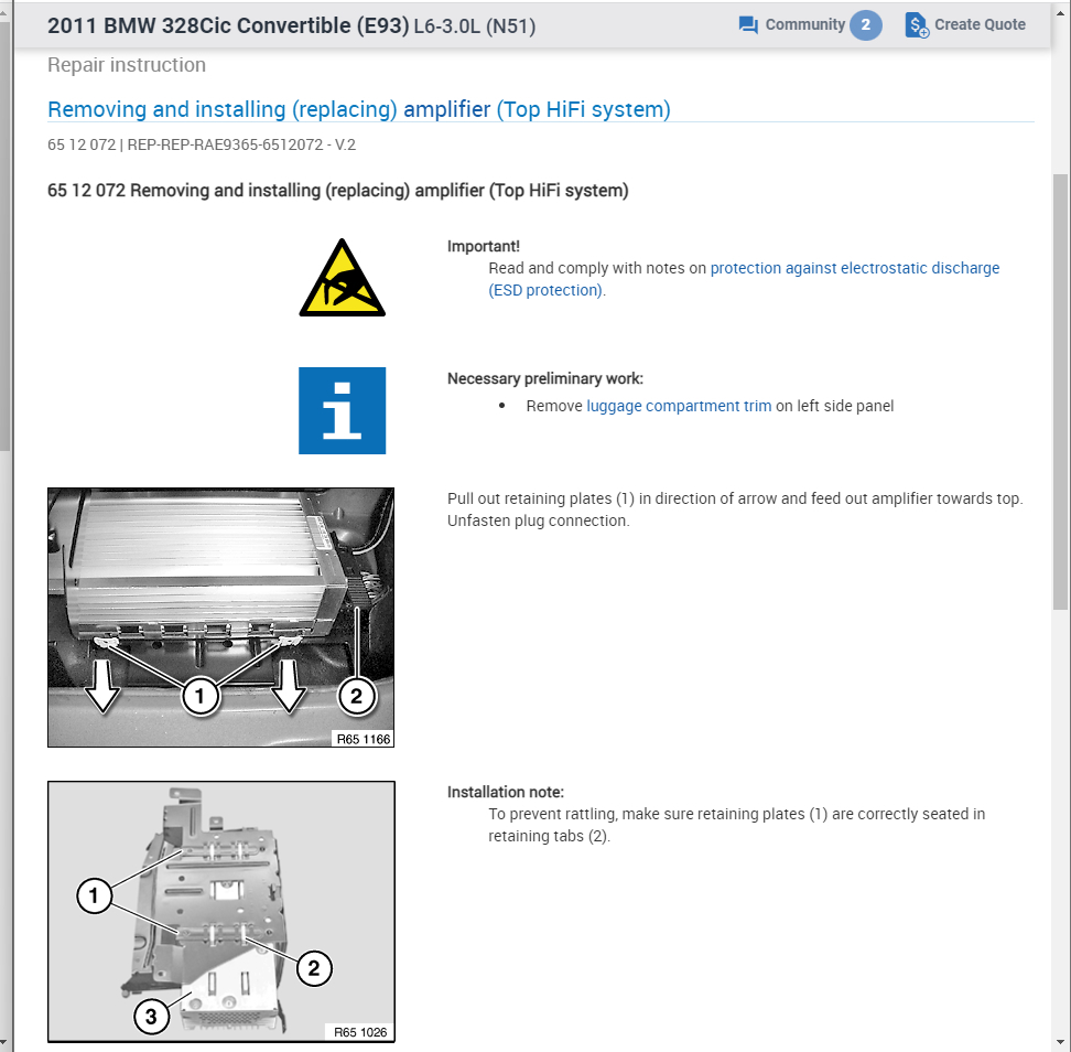

I have a convertible, the trunk is designed differently than on the sedan. Where is the radio amplifier located on a convertible?
Sep 29, 2018 at 7:31 AM

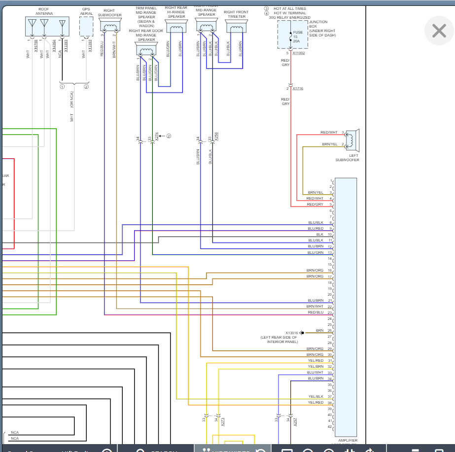

I suspect if you are looking for the location that the amp is not working. Before you replace it, I would suggest checking power coming into the amp first.
I have seen many amp failures because of a fuse so just check for power and ground before you replace it.

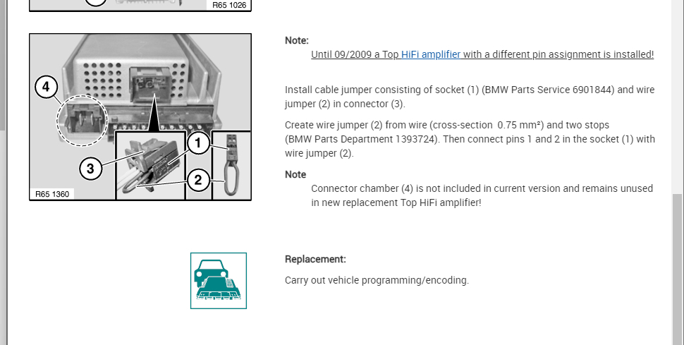

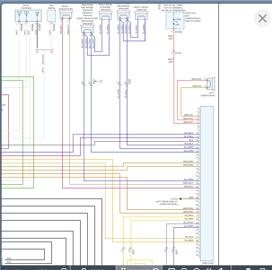

Below you will find the process from the manual and wiring diagrams on the amp.
Please let us know what you find with this. Thanks
