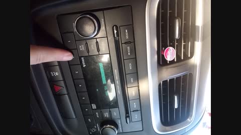

The radio stations aren't working, everything else does.

I will help you, but I need a little more information. When you say are not working do you mean you cannot see them or they don't pick up anything? Can you please shoot a quick video with your phone so we can see what's going on? that would be great. You can upload it here with your response. Please let me know.

CD player works.
Aug 30, 2019 at 5:44 AM

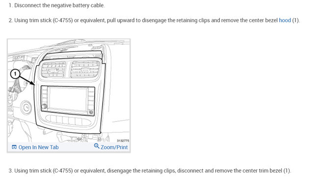

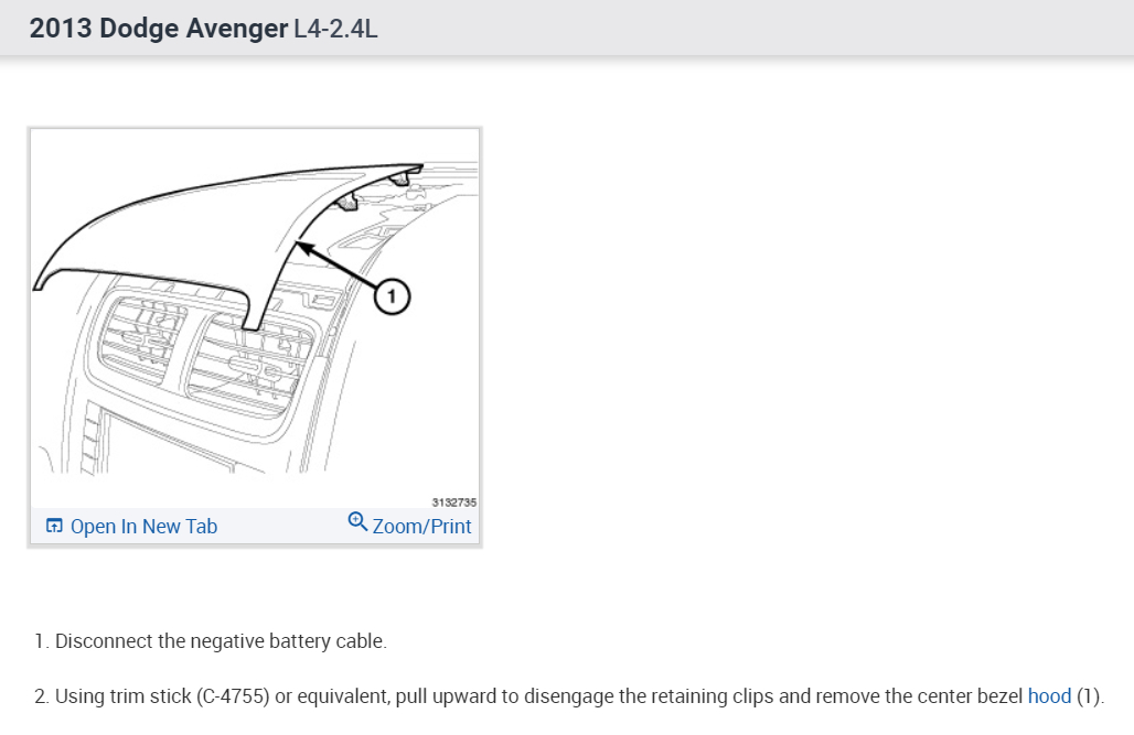

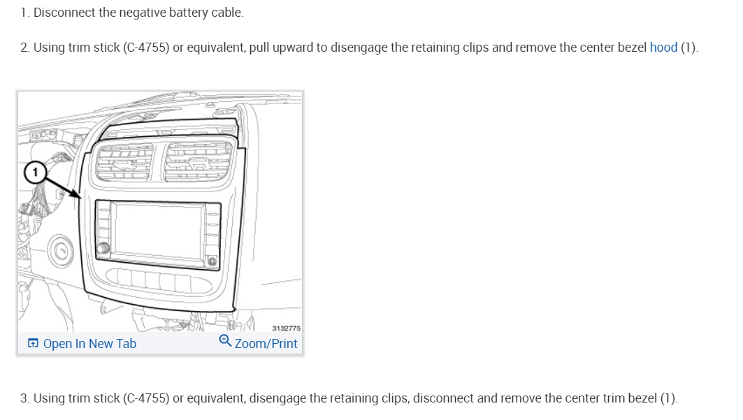

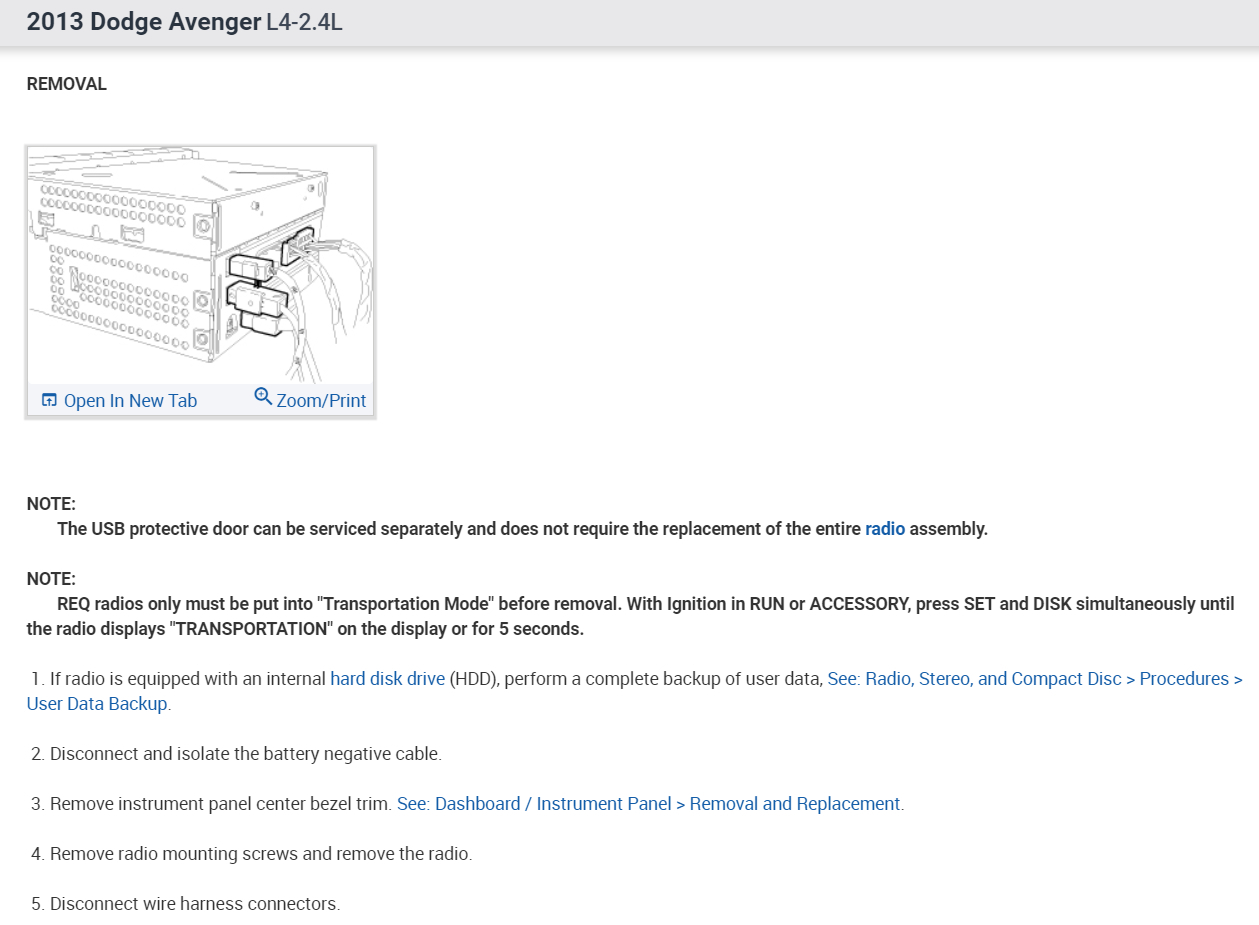

Hmm, the video just shows the vents? what kind of phone are you using? can you re-shoot please so I can see what is going on? It looks like the radio has gone bad though. here are instructions in the diagrams below to show you how to replace the radio:
