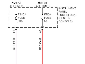

Your problem sounds like the audio amplifier is no longer powering up.
This is controlled by fuse F31DA(30A).

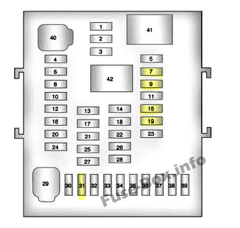

See image 2 below I marked the fuses which supply the infotainment system, marked in yellow. Note that not all fuses might be present, depending on the vehicle's equipment level.
A good source of fuse information:
https://fuse-box.info/chevrolet/chevrolet-equinox-2010-2017-fuses-and-relay

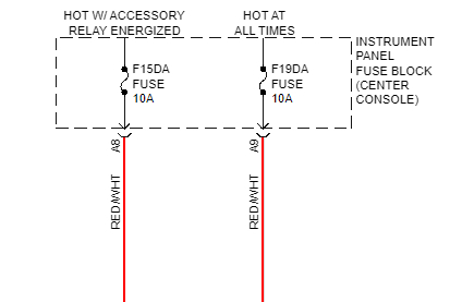

Fuse F15DA (10A) supplies power to this module

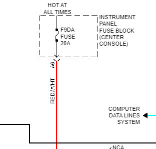

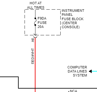

Also while going over the wiring diagrams, I found another fuse, fuse F9DA (20A).
I would think that this is the fuse which you had checked in the beginning, see image below.
