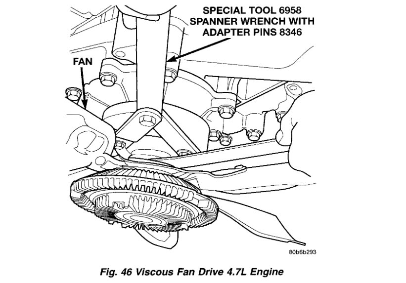

Thank you. That may be easier said than done. ;) Doesn't seem very accessible but I'll give it a try. is there a special tool to make that angle? Do you suggest getting to it above or below the fan?
Feb 19, 2019 at 9:14 AM
Yes, that is the way to remove it.
The tool is shown in the picture. You can rent that tool at a parts store for the removal.

Thank you Roy. So that tool removes the nut holding the fan to the engine or do I just remove the four smaller bolts holding the fan on?
Feb 19, 2019 at 9:18 AM
You are welcome.
It holds the fan from turning while you loosen the four nuts that secure the fan to the water pump pulley.
