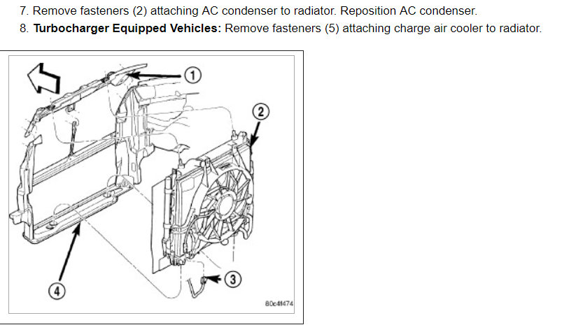

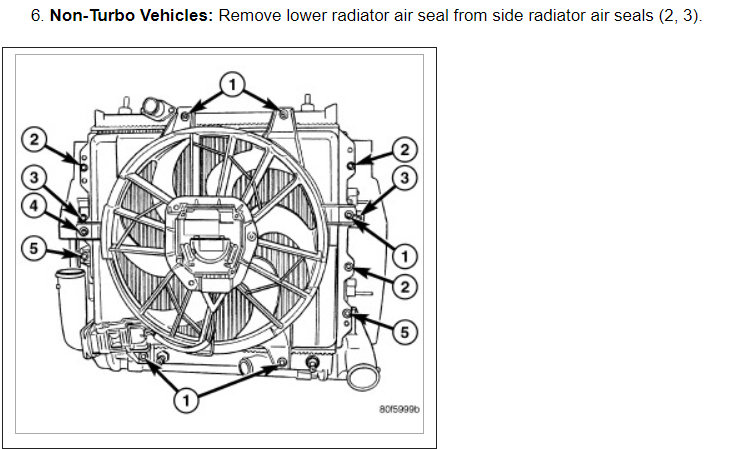

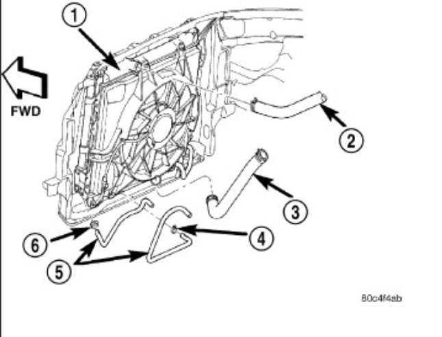

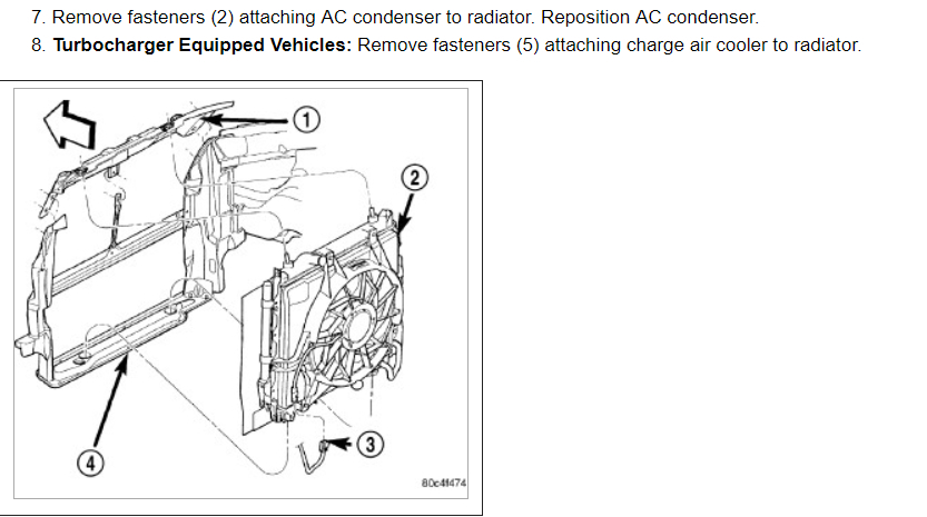

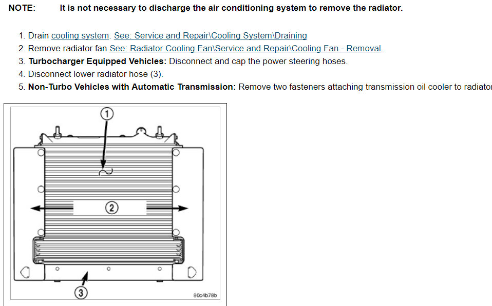

You do not need to discharge the air conditioner to remove the radiator. Here is a guide to help you see what you are in for when doing the job:
https://www.2carpros.com/articles/how-to-replace-a-car-radiator
Here are diagrams of what it will be like on your car (below).
Check out the diagrams (below).
