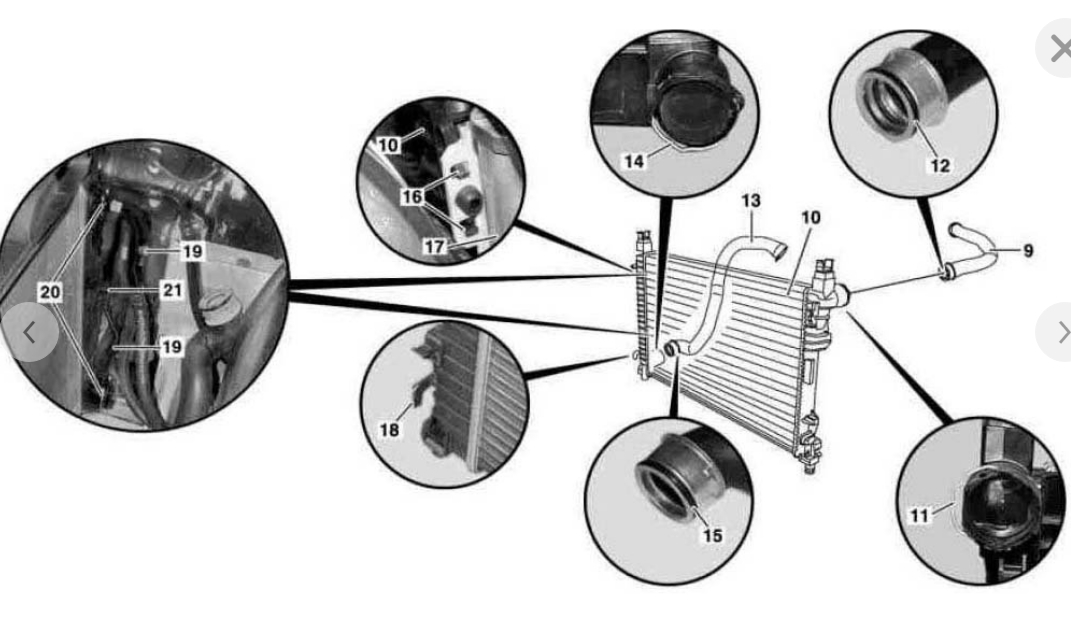

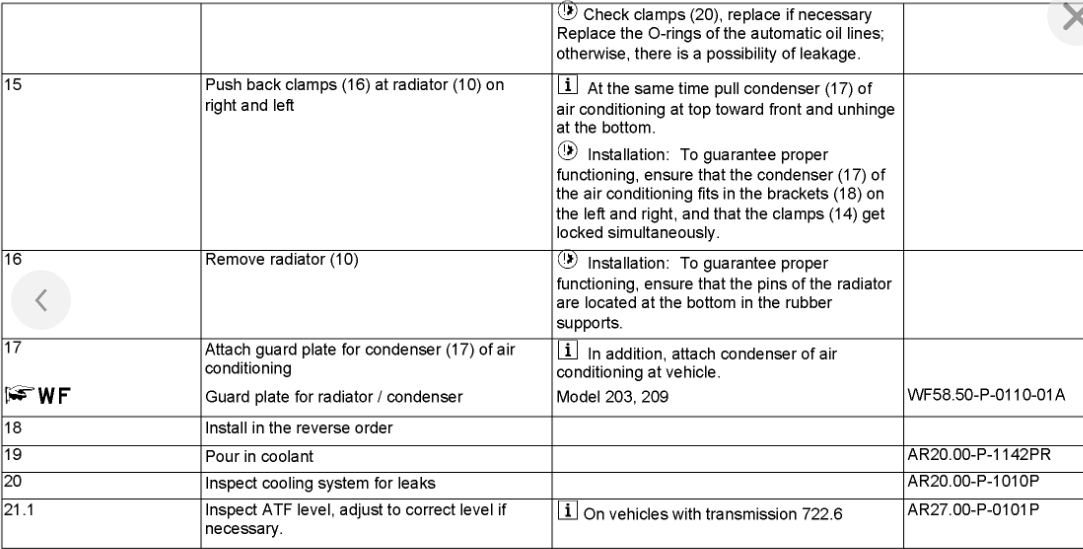

Hi, I've got a radiator leak. Tried removing but it looks like it is stuck to the condenser. My question is, do you know if it is attached as one unit? Or am I missing something?
Sep 18, 2019 at 12:42 AM
DANNY L
  • 5,648 POSTS
Hello, I'm Danny.

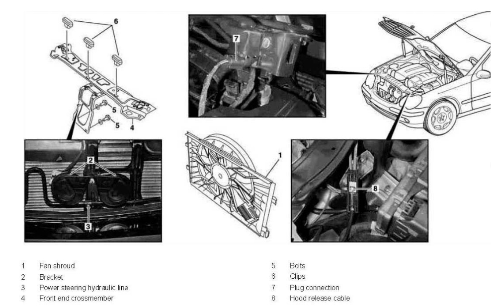

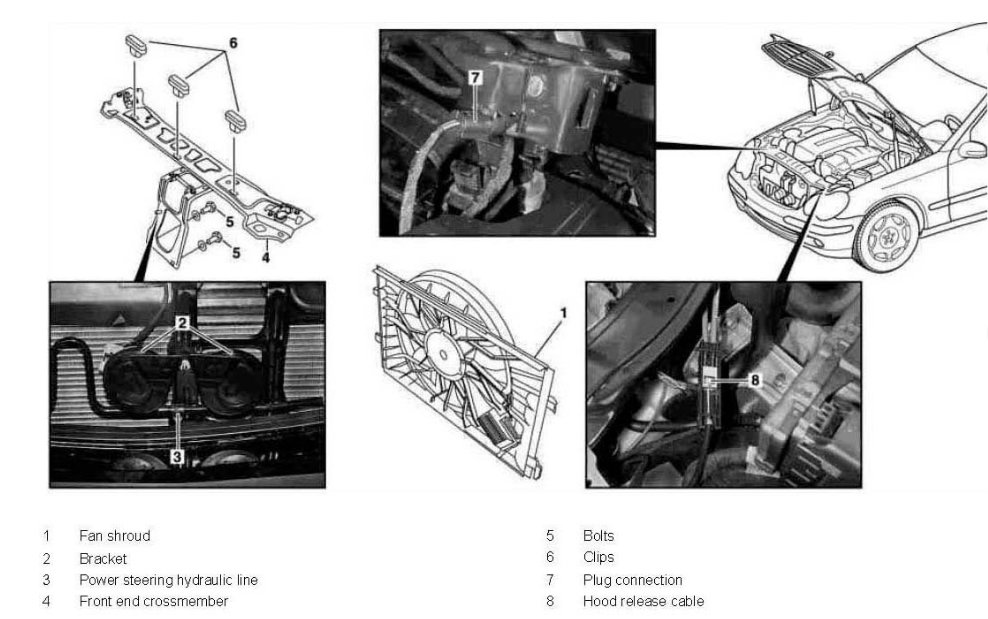

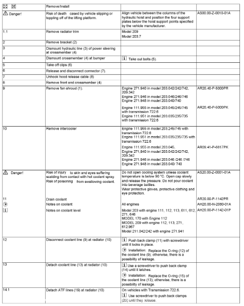

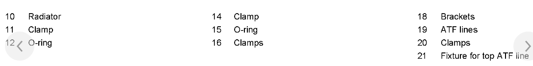

No, It's attached to the condenser but separates by bolts. Here is a tutorial showing a radiator removal:
https://www.2carpros.com/articles/how-to-replace-a-car-radiator
I've attached below The Mercedes Benz step-by-step instructions.Hope this helps and thanks for using 2CarPros.

Hi Danny, thank you so much it is exactly what I needed.. will give update when I am completed.

Hi Danny I managed to replace the radiator, turns out it was a couple of induction hoses running from the compressor (supercharger) that had to be removed before freeing the radiator. That was a successful project, connected everything back seems to be running fine. I got another question though I have the MBII obd scanner and it gave me a B1100 code any idea how to interpret this code? On the same c230k by the way. Thanks once again.

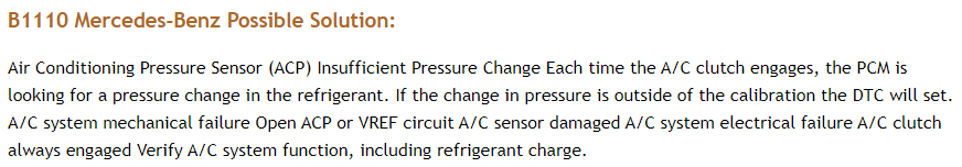

I hooked the car (2004 c230k) up on a MBII obd scanner and gave me a B1100 fault code any idea how to interpret it? Can't find anything on it. Have a feeling it has something to do with the AC because when I run it for a while then the check engine light comes on.
Sep 20, 2019 at 1:29 AM
DANNY L
  • 5,648 POSTS
Hello again.
Yes, that code has to deal with an A/C issue... I've attached a diagnostic test step below.Hope this helps and thanks again for using 2CarPros.
