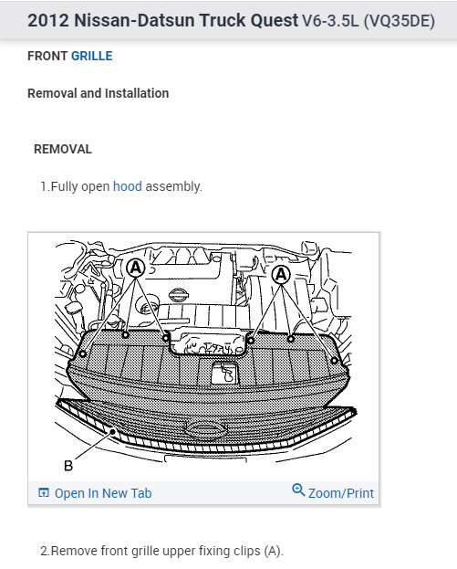

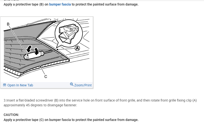

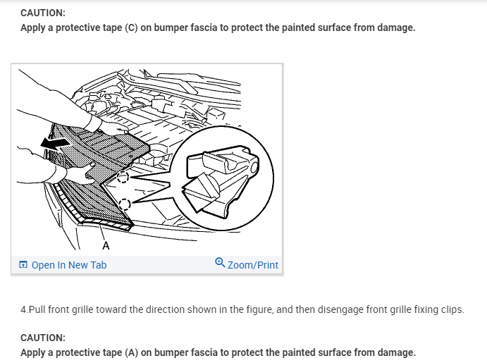

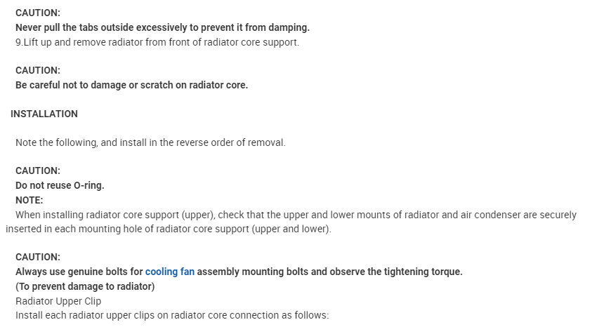

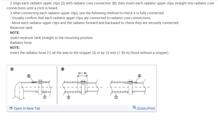

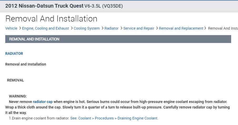

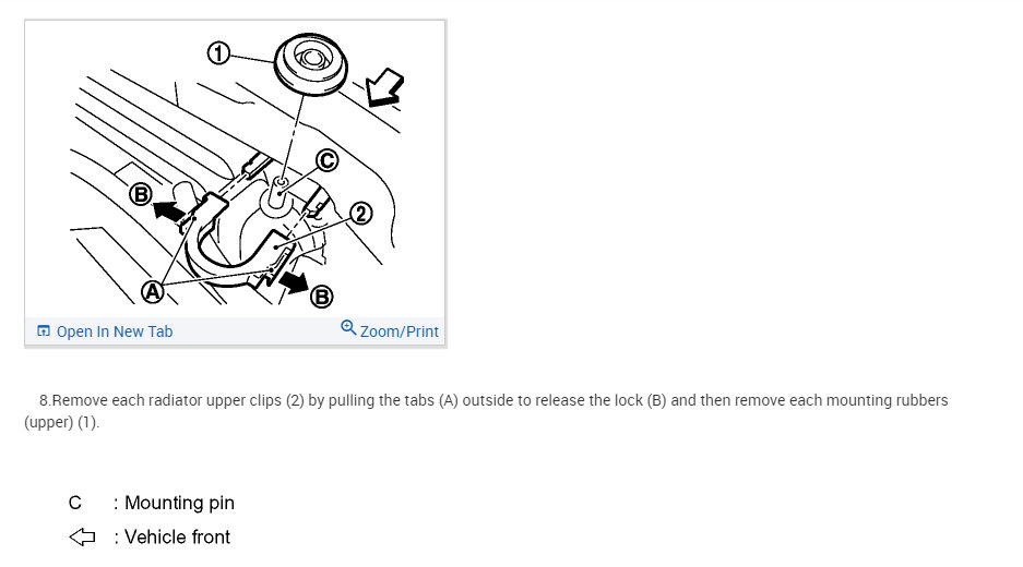

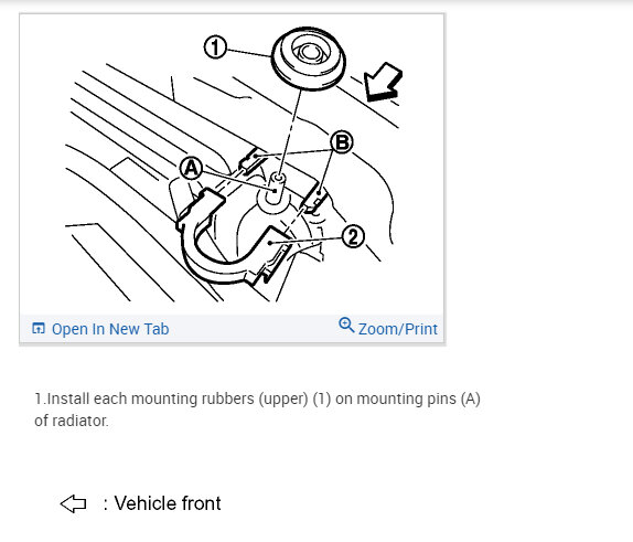

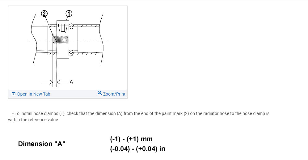

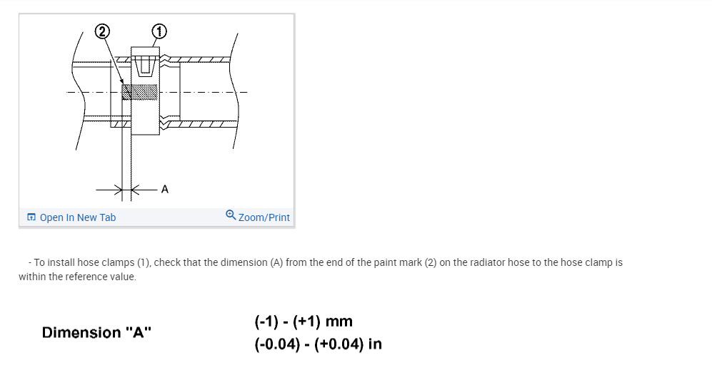

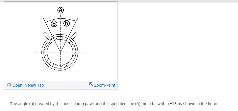

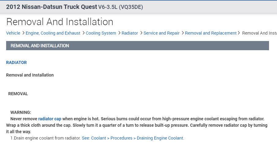

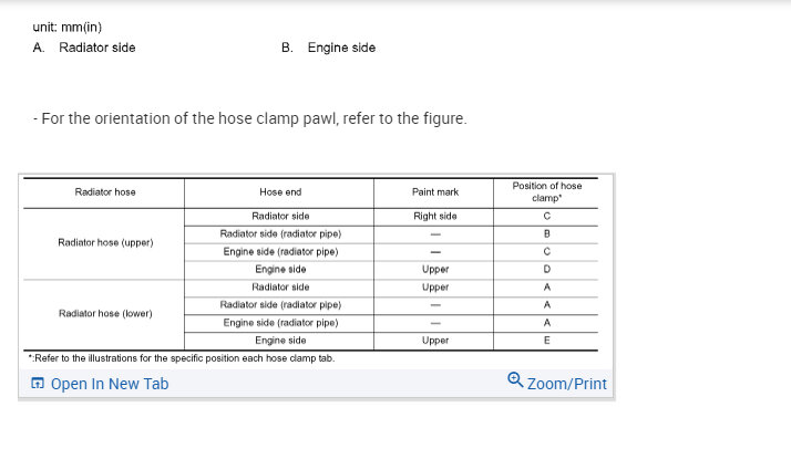

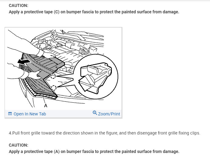

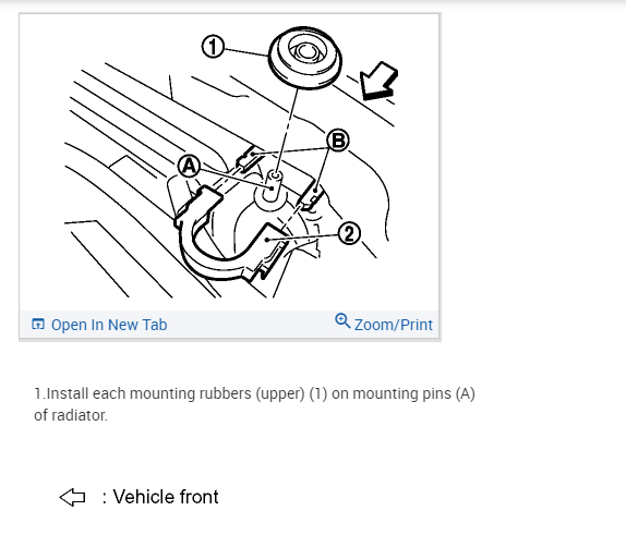

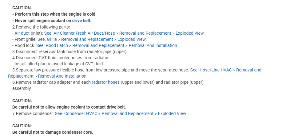

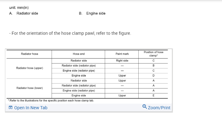

The bumper doesn't need to be removed, but the front grille will along with other components.
I attached the directions below for the removal and installation of the radiator. Take a look through them and let me know if you have questions.
Take care and let me know if I can help.
See pics below.
Nov 30, 2022 at 9:43 PM

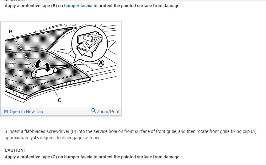

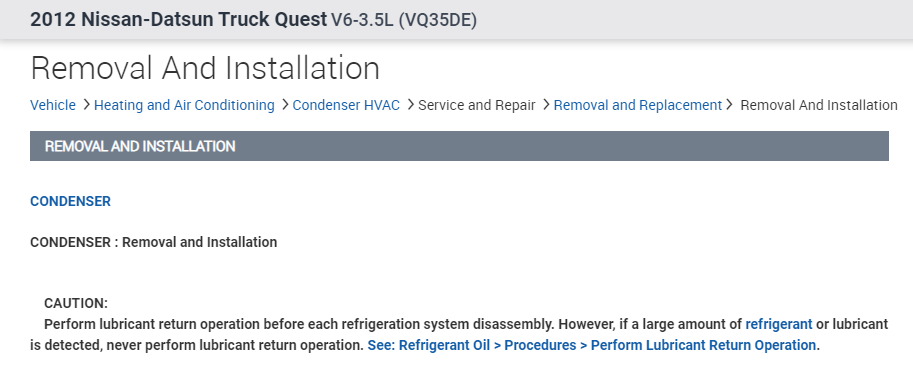

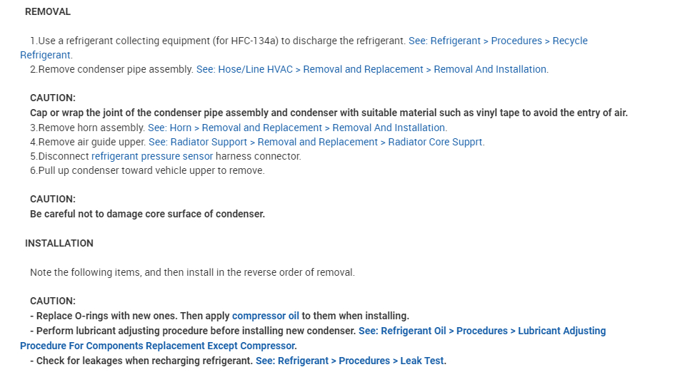

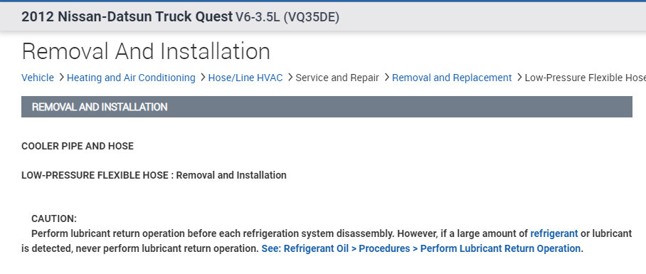

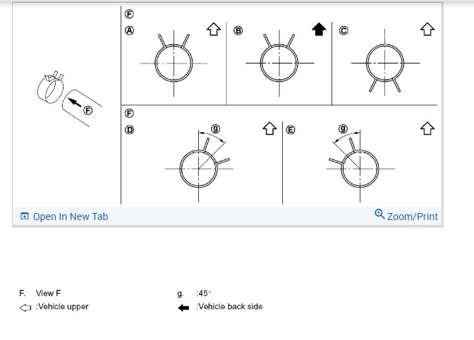

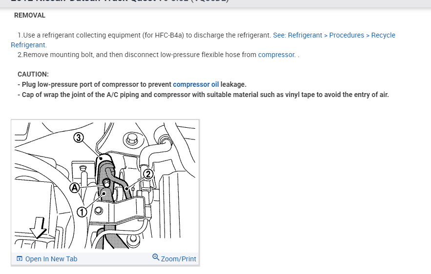

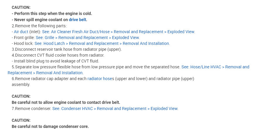

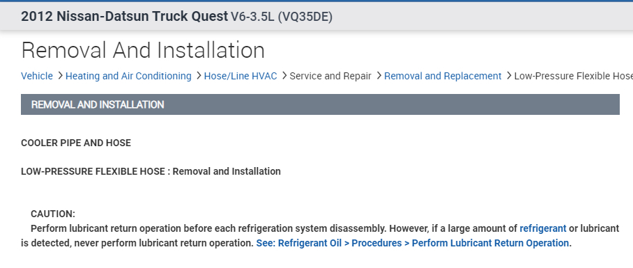

Hi this is Tommy Pepsi, I don’t see the front grille how to remove and the low-pressure flexible hose and the A/C condenser removal.
Dec 1, 2022 at 4:02 AM

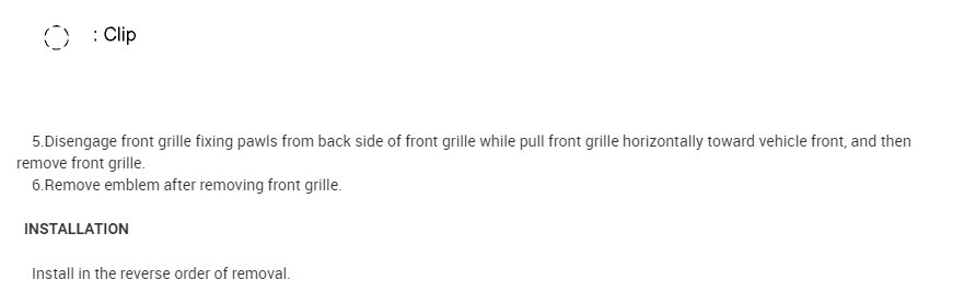

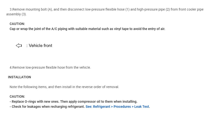

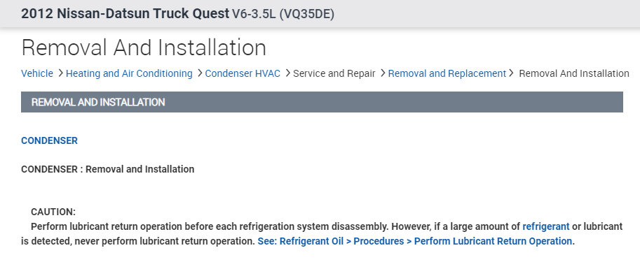

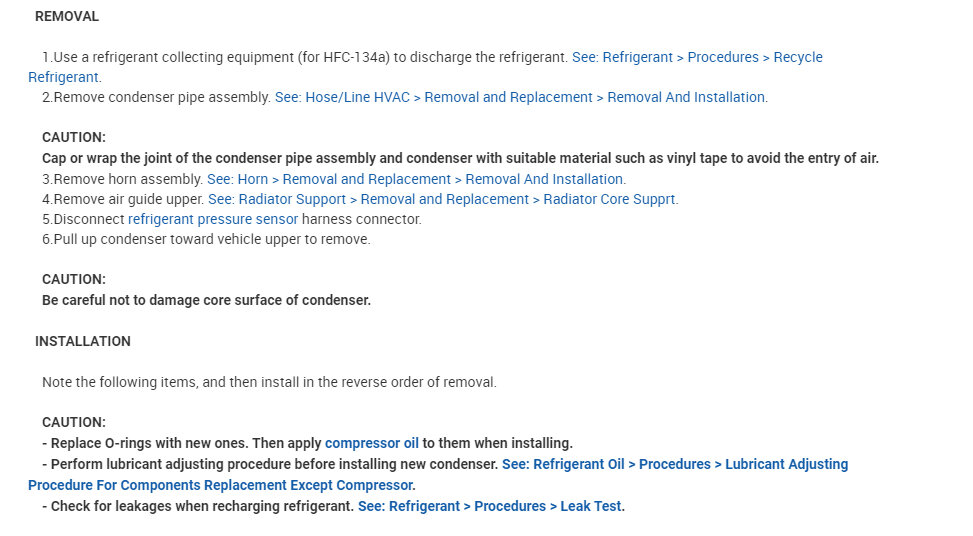

Hi Tommy,
I attached directions for the individual components below. Please keep in mind, you will need to evacuate the refrigerant from the A/C system.
Let me know if this helps.
See pics below.
Dec 1, 2022 at 1:55 PM
