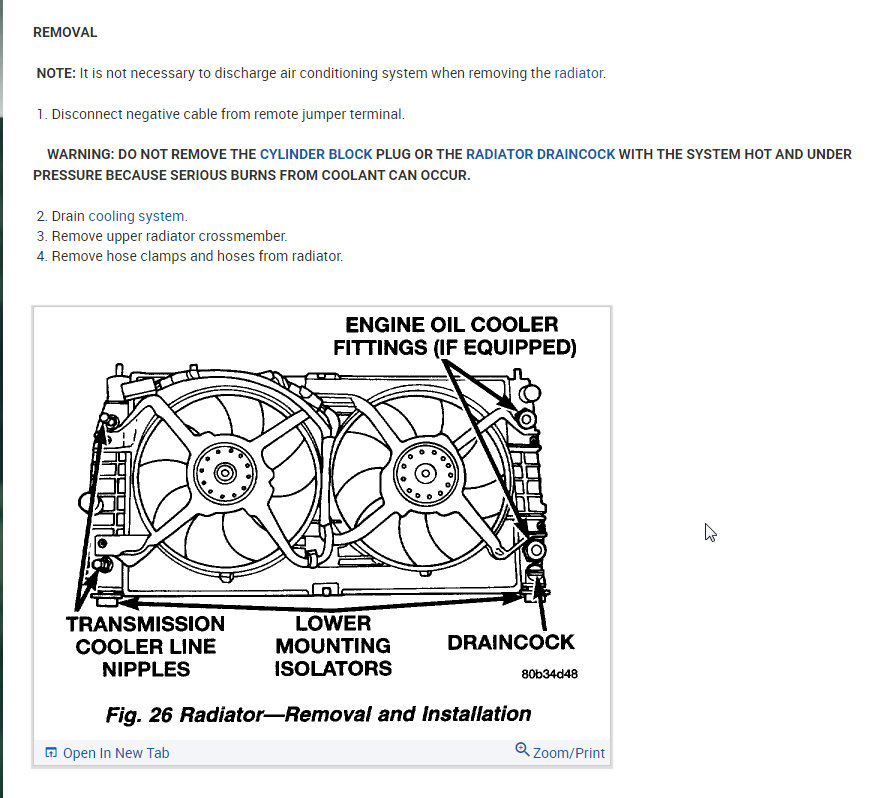

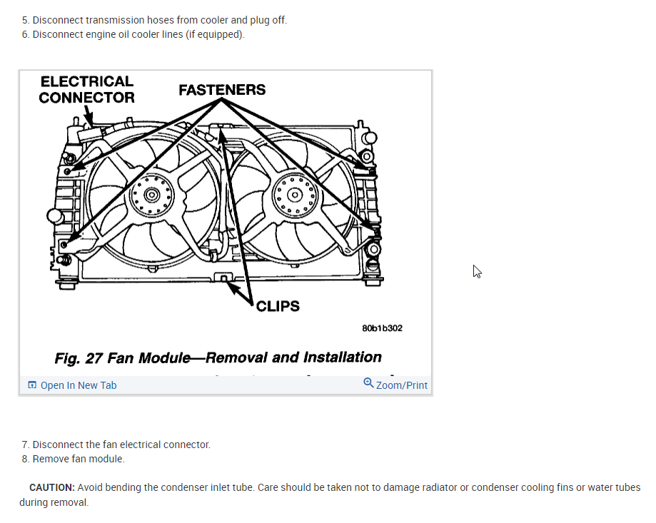

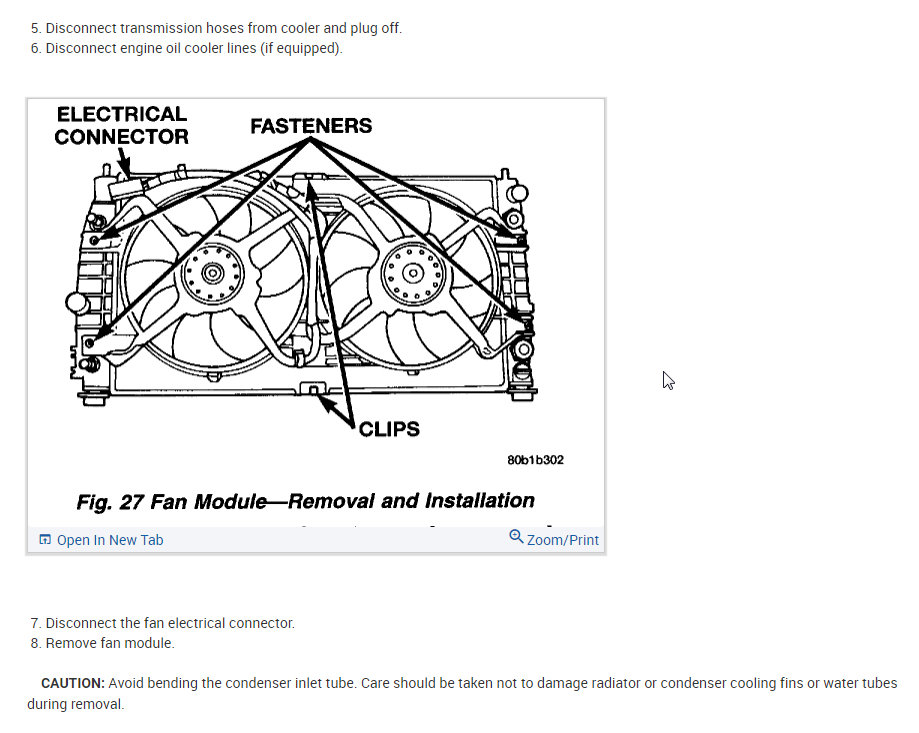

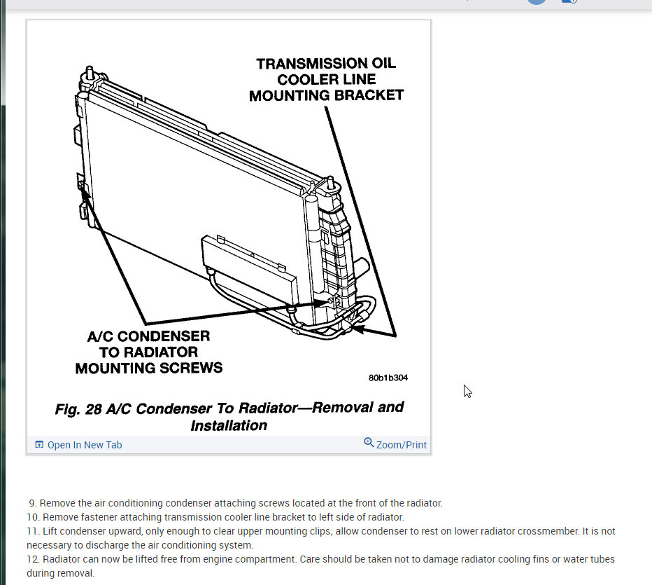

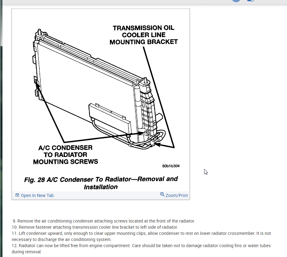

I removed the fan, the coolant hoses, the upper and lower hoses and the 2 screws on the front of the radiator, but the problem is; i i'm not sure how to get to the bolt on the driver side of the radiator. do i remove the front bumper for access? if so how?
Nov 12, 2020 at 11:04 AM
Here is the process from the manual. Take a look at this and then let us know if you need more info. If you still can't get it, can you get a couple pictures of what you are dealing with then we will go from there? Thanks

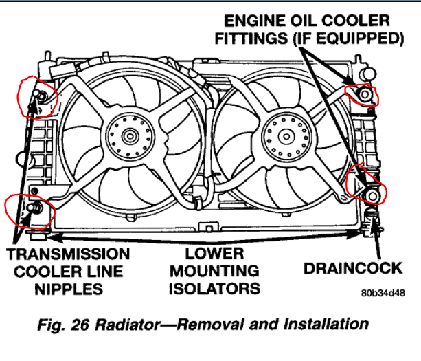

Sorry your getting frustrated. so I just want to add my 2 cents. I've attached a picture below and circled the oil cooler and transmission cooler lines in red. Which is the line that is not attaching due to thread or adapter issues? Get back to us and we'll go from there. Hope this helps and thanks again for using 2CarPros.

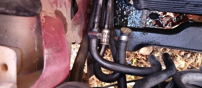

Lower transmission coolant line. I'm looking at this and it seems that "nipple"remains. I undid the old one leaving it in the line to remove radiator faster. So i should try to remove the old one and the line should attach?

This hose that resembles horseshoe shape is what's messing me up.
Nov 13, 2020 at 9:08 AM
I just want to make sure I am understanding. I pointed to the old and new lines. Is this correct? If it, then yes, just unscrew those band clamps and remove that brass connector and then slide that line onto the hard line for the oil.

I am trying to remove brass connector. But that is the toughest hose to get off. There's not much of a line to snip it.i wish i could. Thanks.
Nov 13, 2020 at 6:01 PM
It may be molded to the line. Luckily it is a rubber line so worst case, you could cut it and then just use a coupler to add an extension. Let me know if you need help figuring that out.

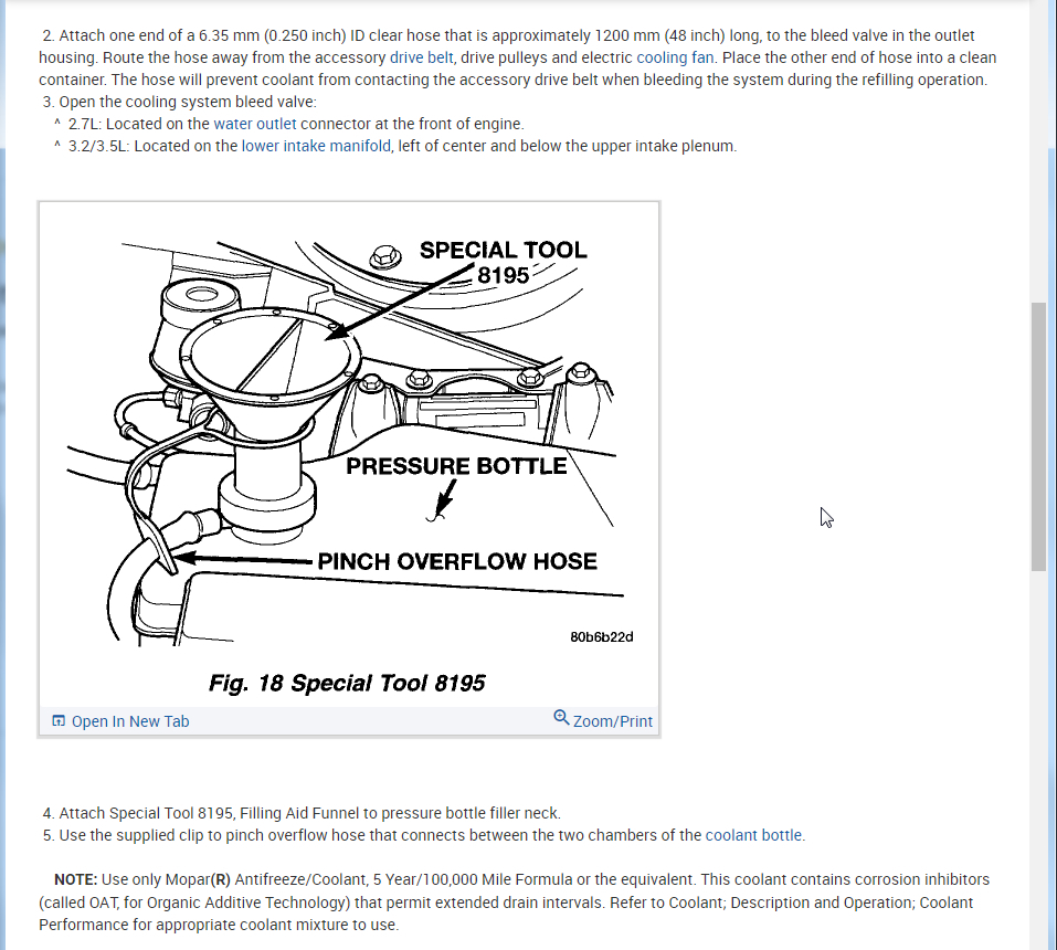

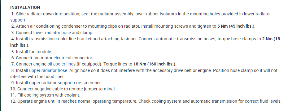

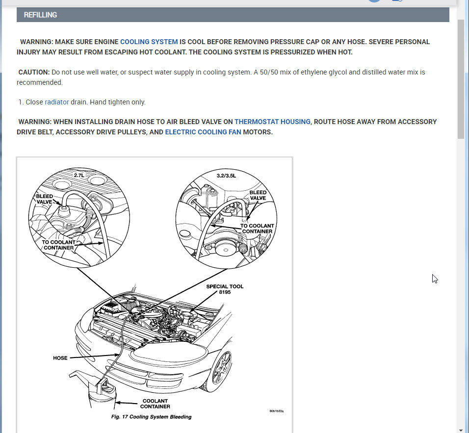

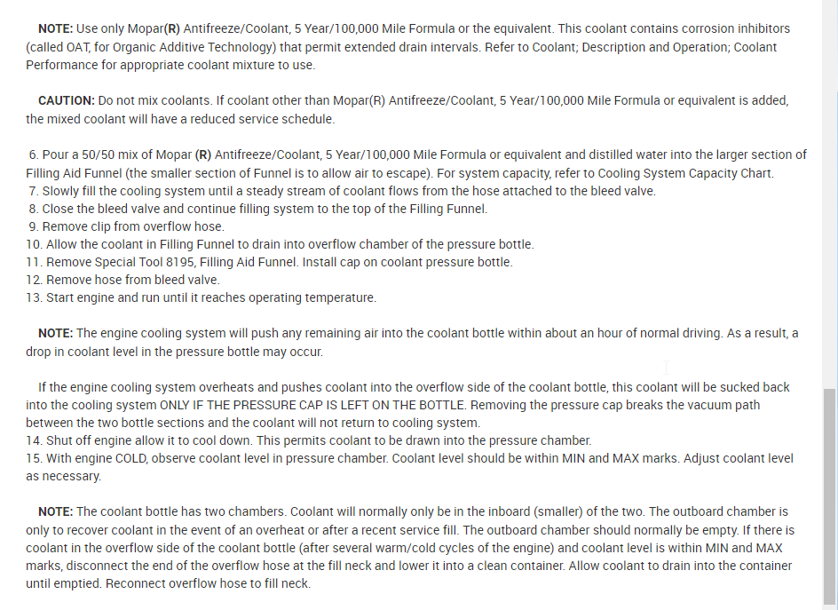

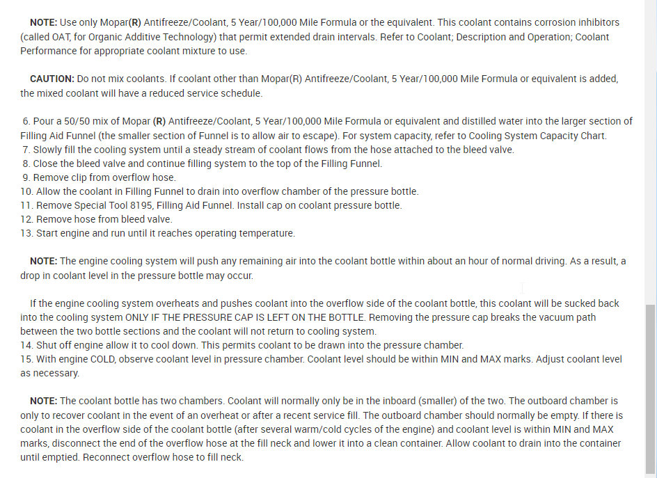

well, i have it all back together. i used the old one ,tightened the nipple ,then i was able to loosen the hose with pliers and a screw driver, then i slid the old one out, put the new one in and hooked everything back up. but now another minor problem; how do you replenish the coolant? do you start it and while engine is cool pour coolant in the plastic bottle and hope it gets sucked into the radiator?
Nov 15, 2020 at 8:25 AM
There are a number of ways to do it. I attached the info from the manual and a guide that will help in more general terms. However, you want to fill the radiator with as much as it will hold then let the engine warm up so the thermostat opens then it will pull it in from the radiator and you will want to keep the funnel full while it is filling the engine and hoses.
