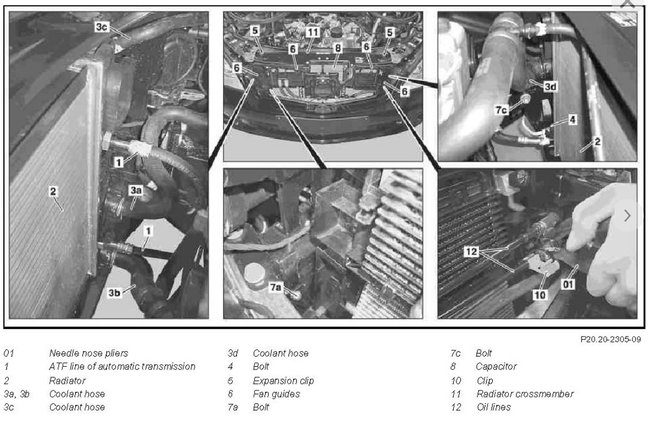

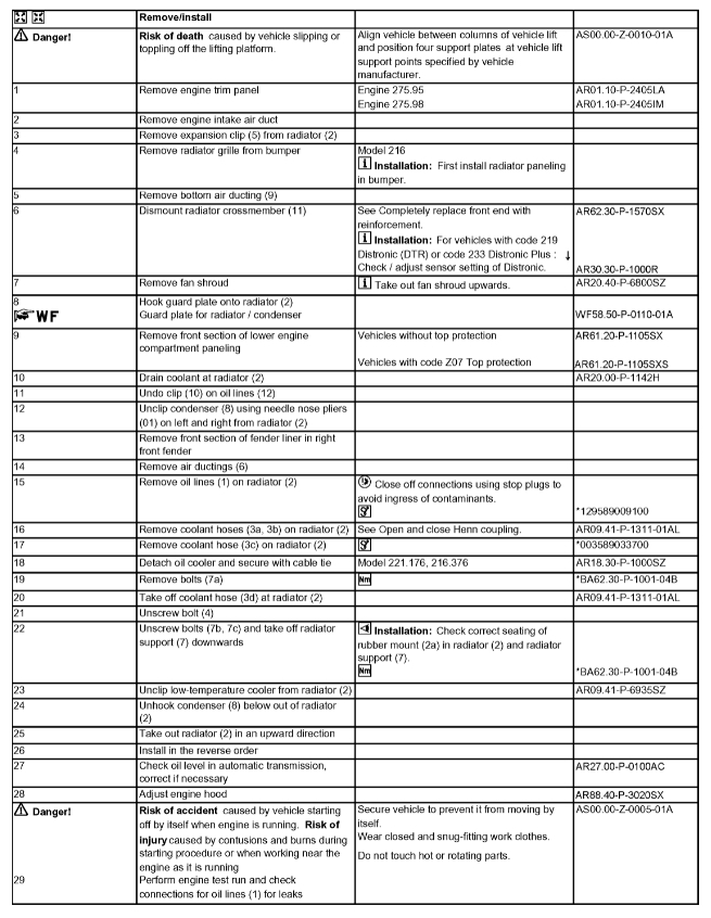

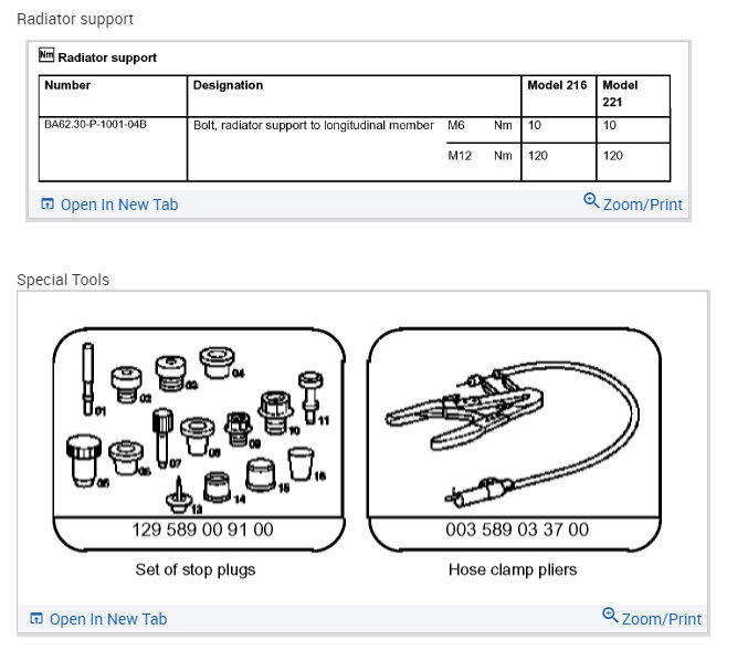

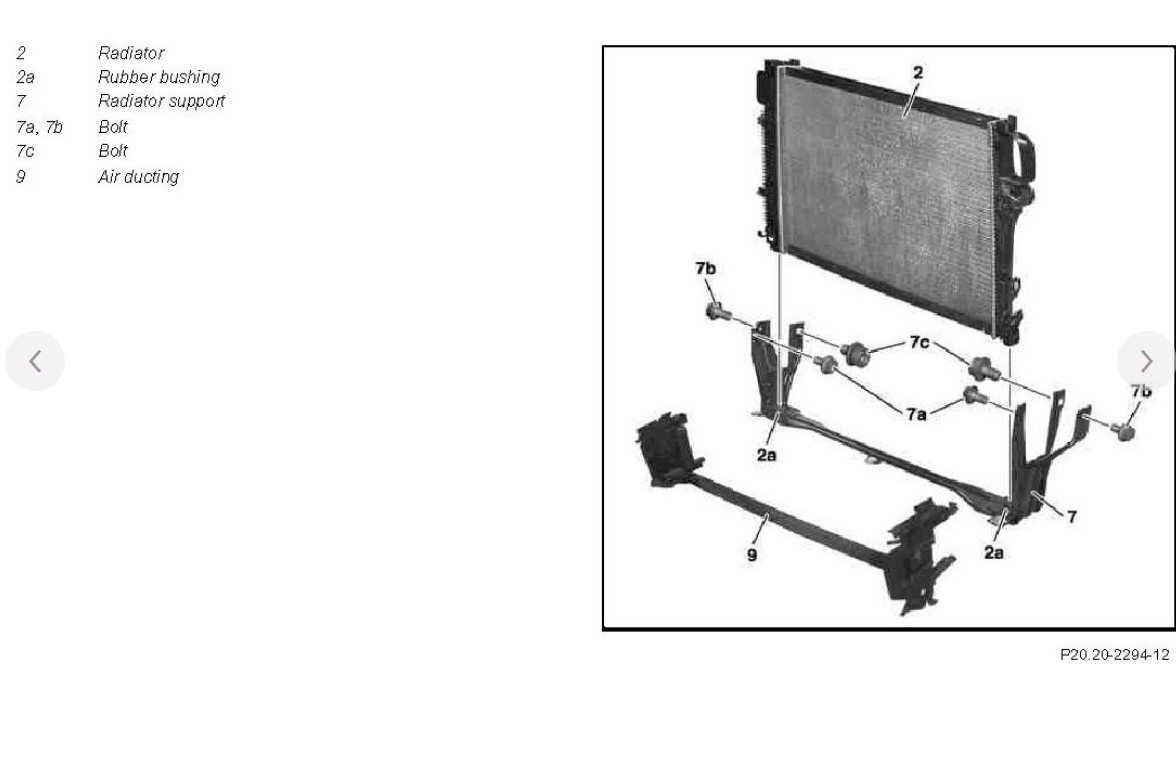

Hi, any tips on removing radiator?
Dec 16, 2021 at 1:44 AM
SQM
CERTIFIED EXPERT
6,383 POSTS
I have attached the radiator replacement procedure below for the S600.
Here are a couple of helpful guides and a video that cover the best practices:
https://www.2carpros.com/articles/how-to-replace-a-car-radiator
https://youtu.be/NRlr9sg3rr8
