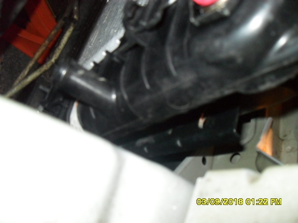

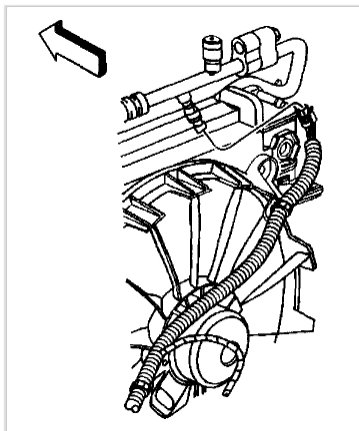

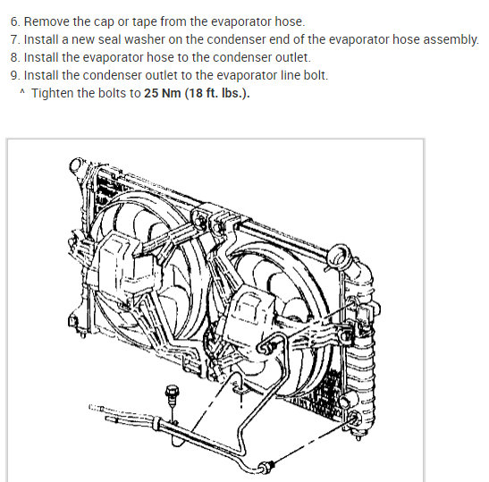

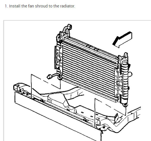

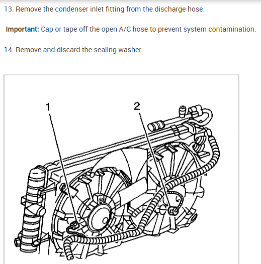

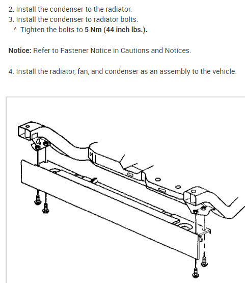

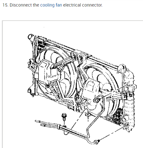

I am trying to replace the radiator in my car and it has already taken me much longer than I planned, and my college final exam is tomorrow morning and the one the following day. So I am desperately trying to finish this job this evening.

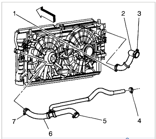

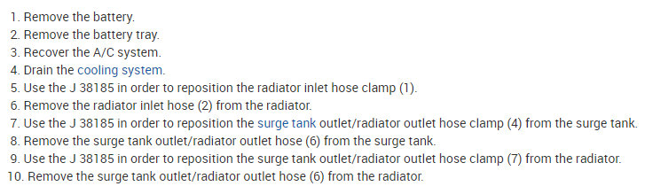

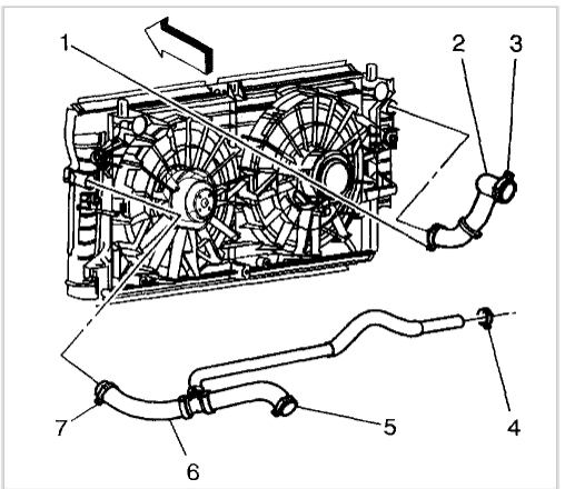

I removed the battery, and all plastic coverings that would prevent access. I have successfully drained all coolant out of the radiator (the petcock would not come out so i had to remove the hoses) then I removed the lines that went in to the radiator.

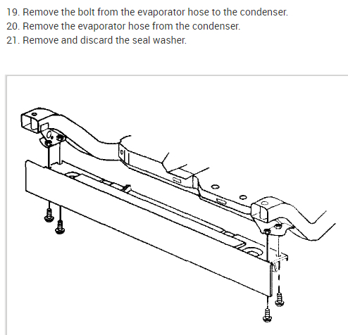

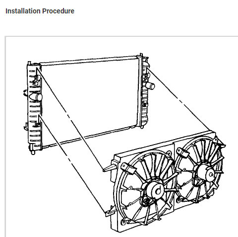

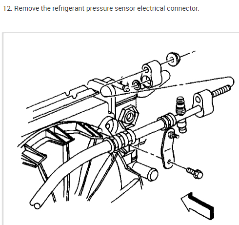

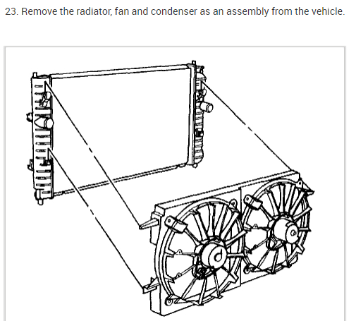

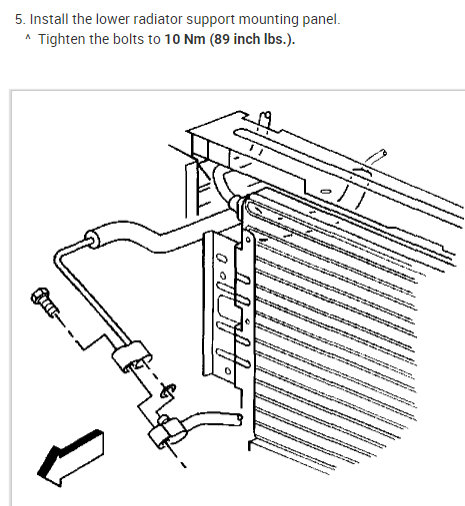

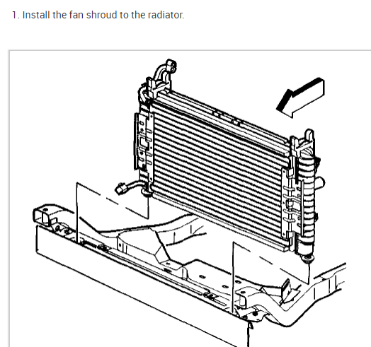

Next was the fans then radiator. My problem is that I am having difficulty getting my A/C condenser and radiator to get close enough to attach the bolts that go into the condenser that connects to the radiator a long with the plastic front cover.
