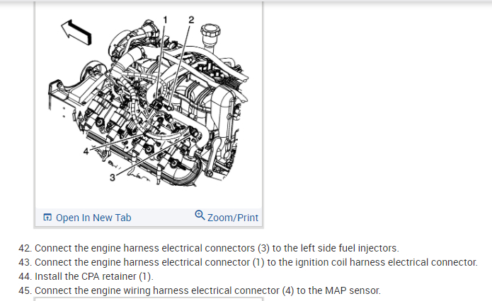

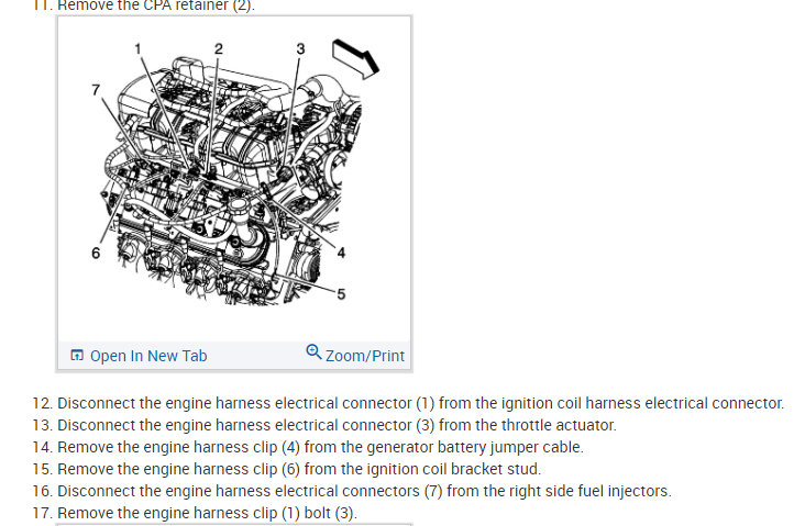

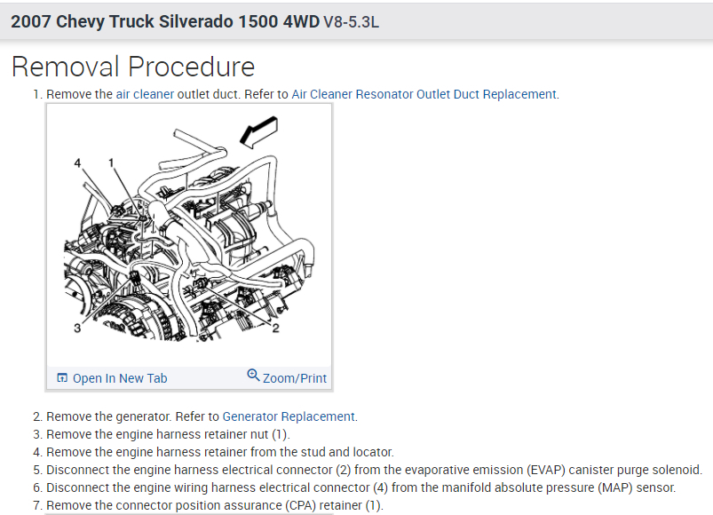

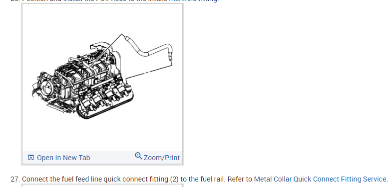

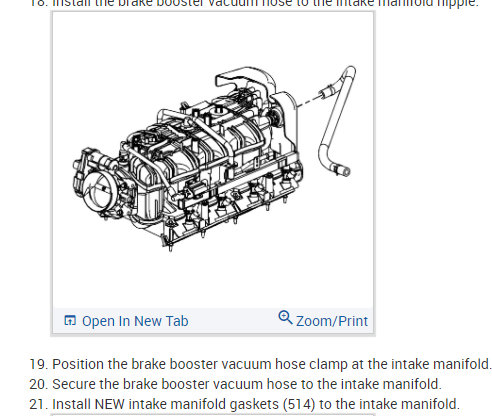

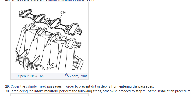

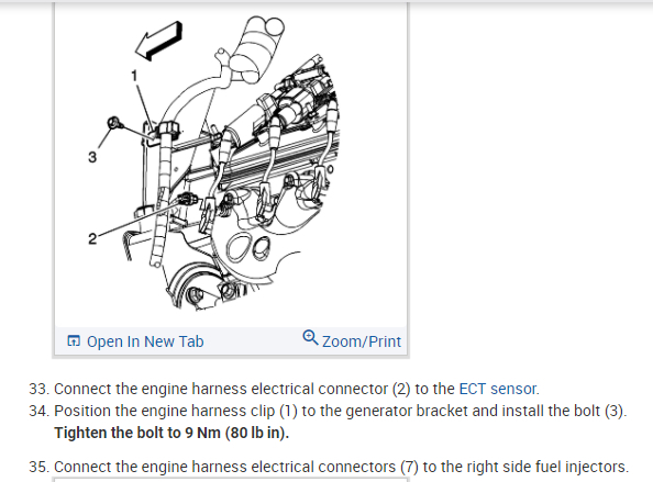

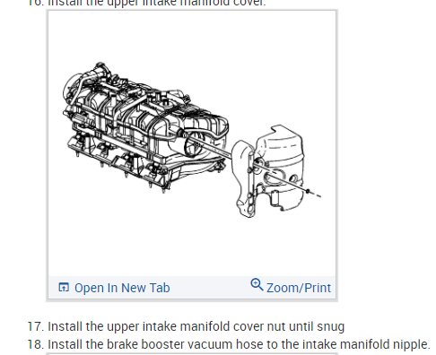

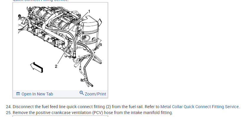

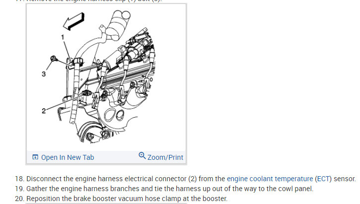

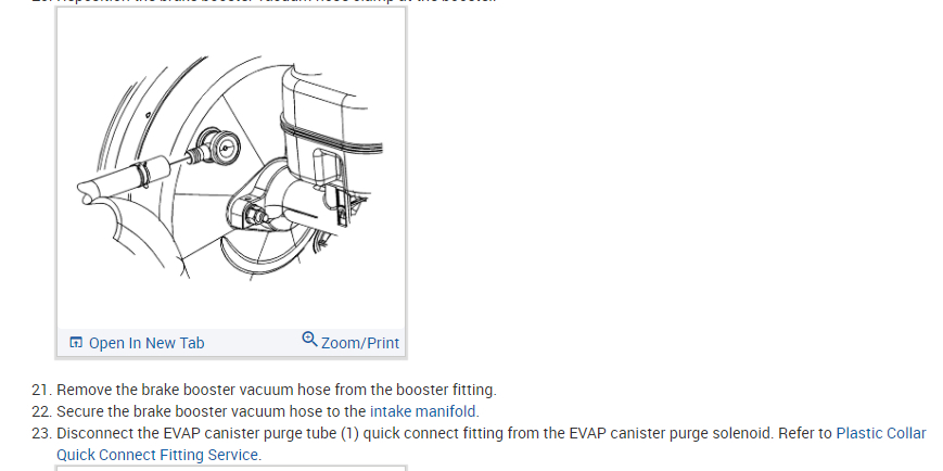

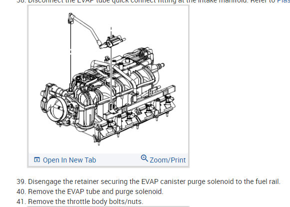

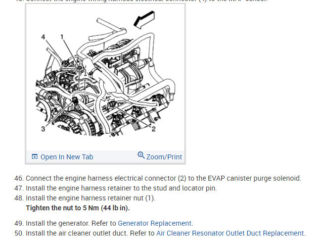

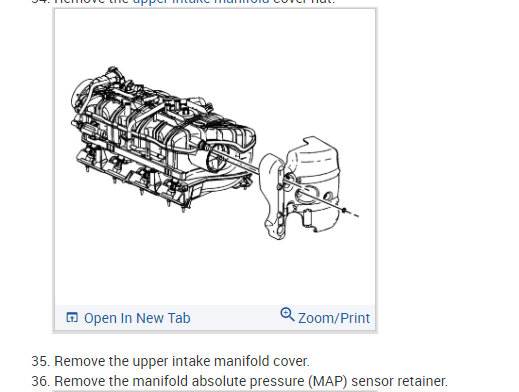

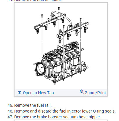

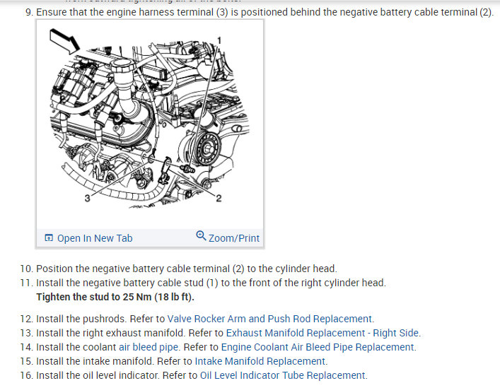

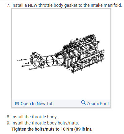

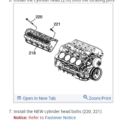

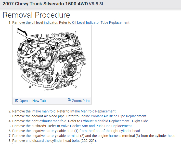

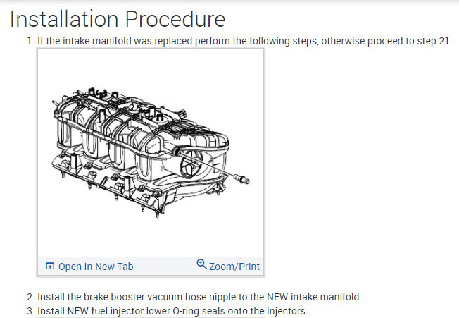

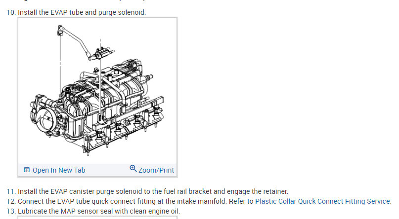

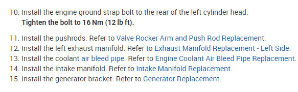

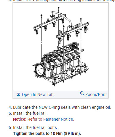

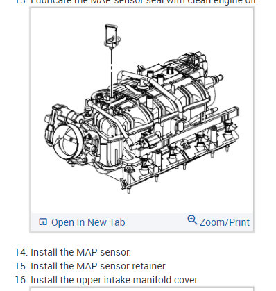

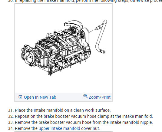

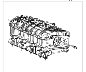

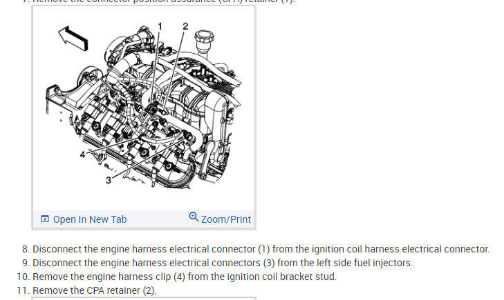

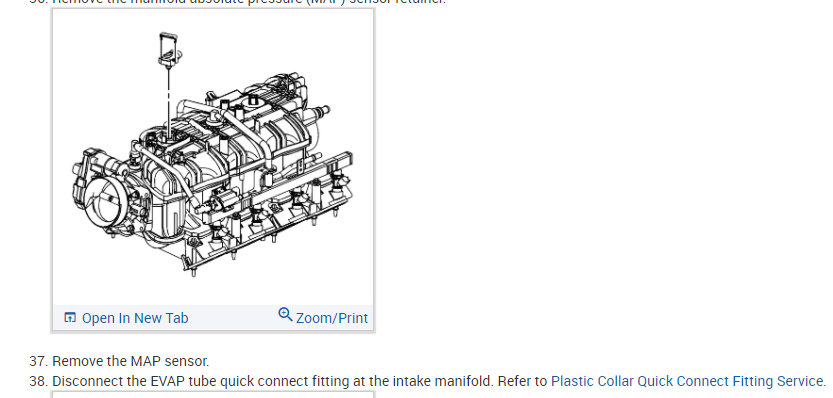

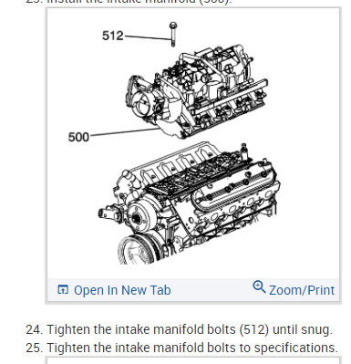

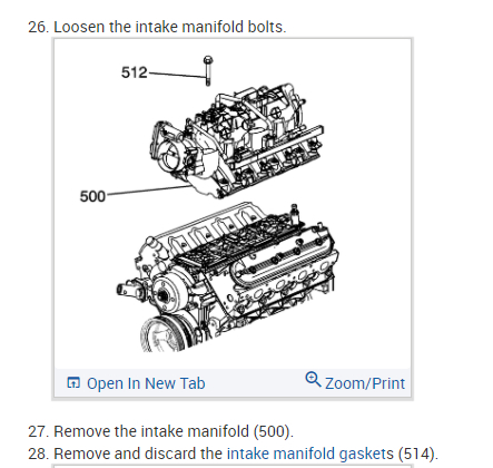

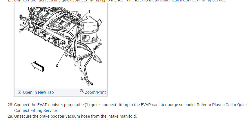

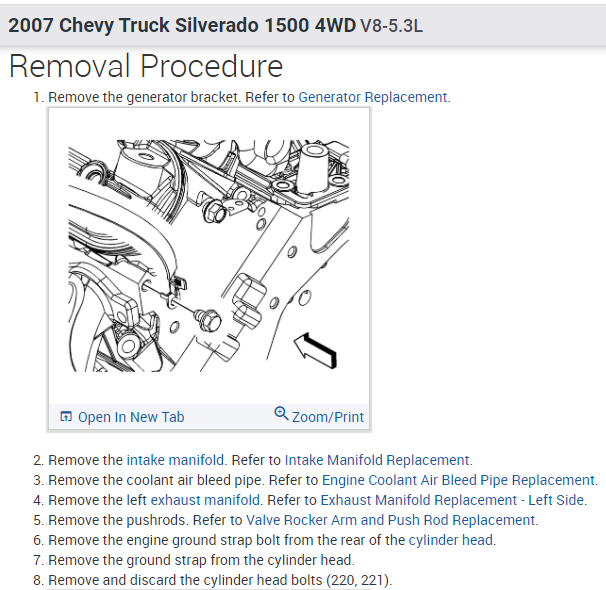

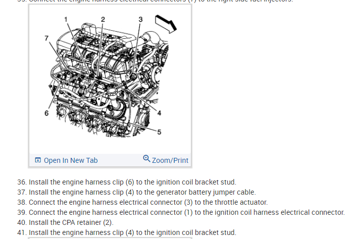

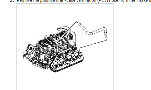

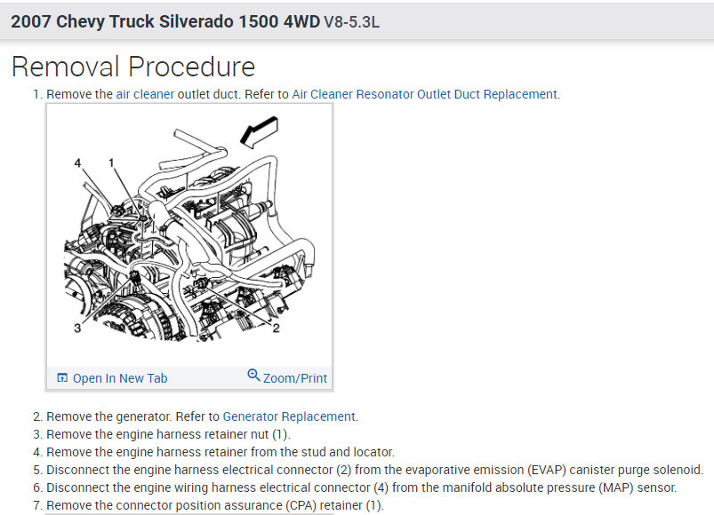

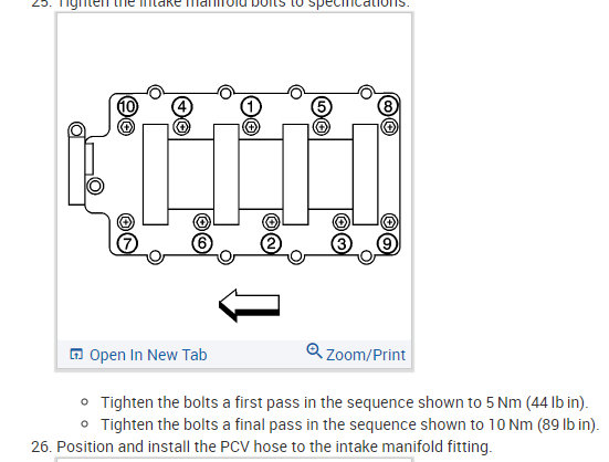

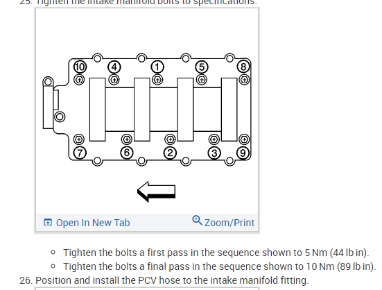

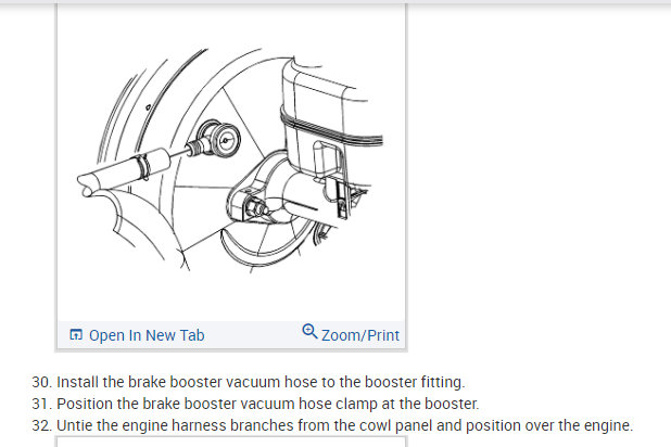

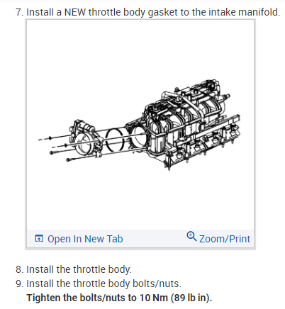

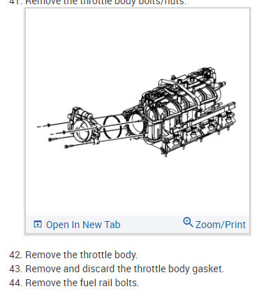

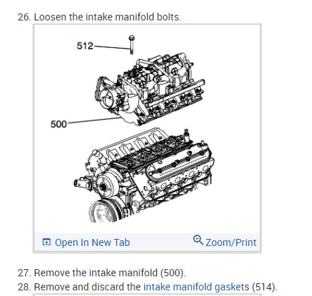

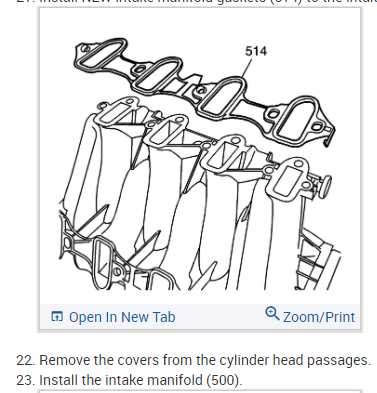

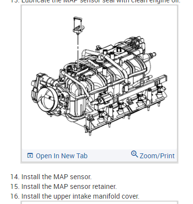

I'm attaching repair instructions for replacing the head gaskets if needed. To get started you will need to remove the intake manifold. Here is a tutorial showing what is involved:
https://www.2carpros.com/articles/replace-intake-manifold-gasket
I've attached picture steps below for removal and replacement of the intake manifold for your truck. Hope this helps and thanks again for using 2CarPros.
Danny-
Jan 29, 2021 at 6:33 PM

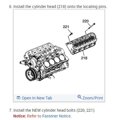

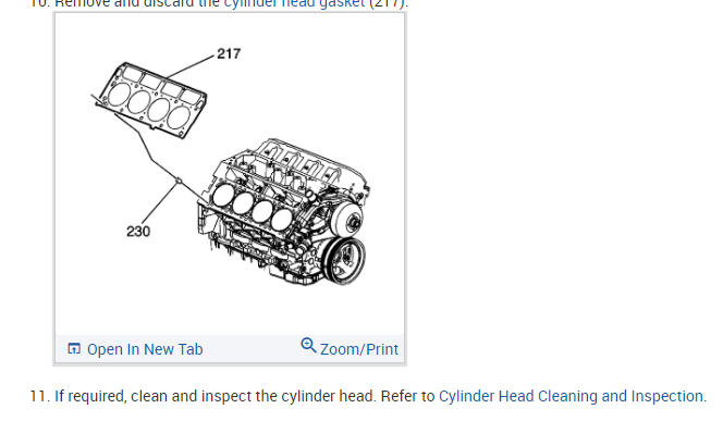

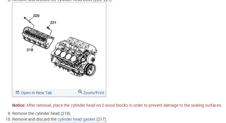

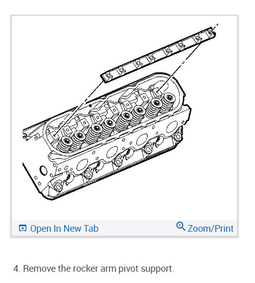

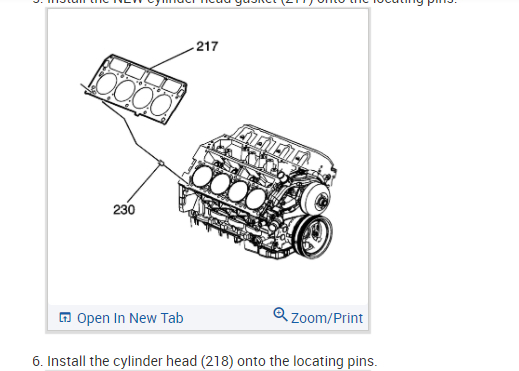

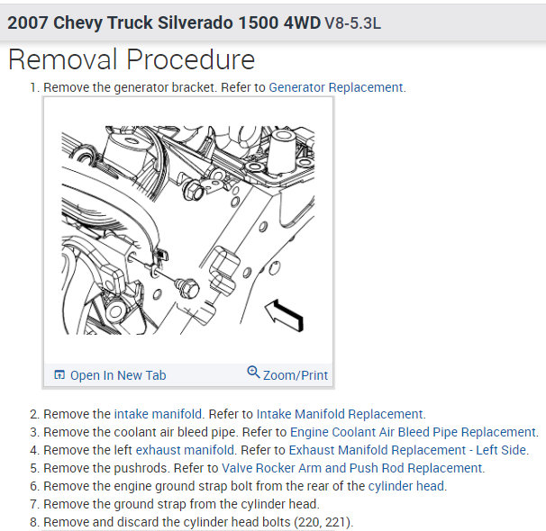

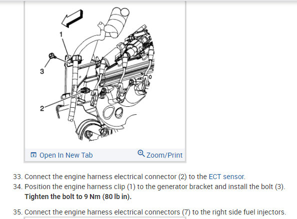

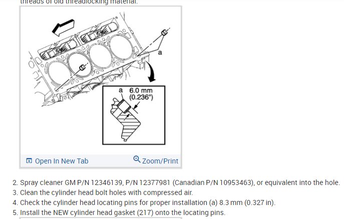

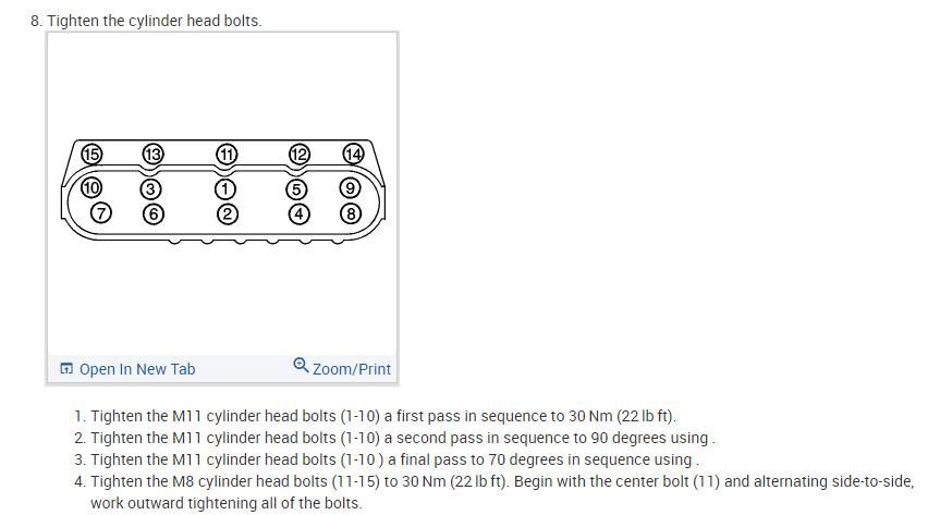

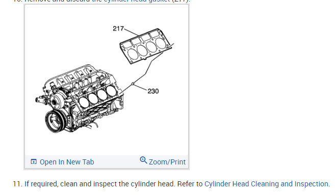

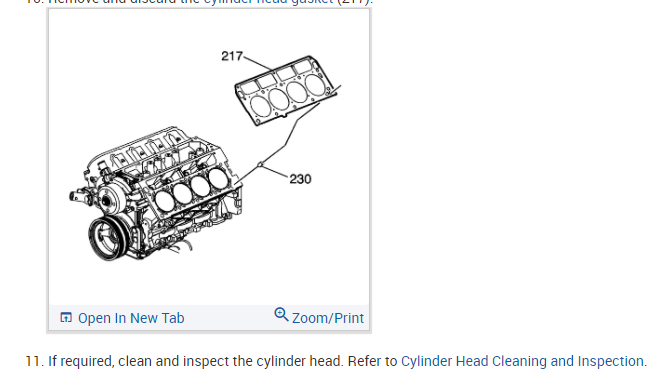

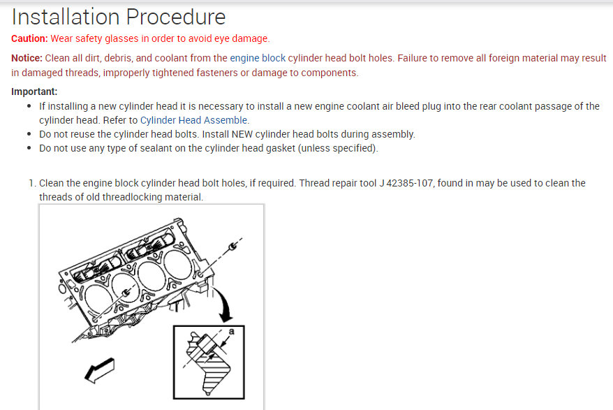

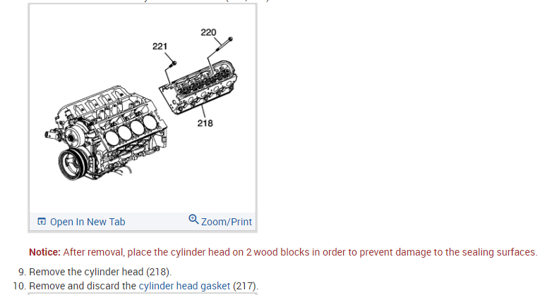

Hello again.

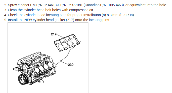

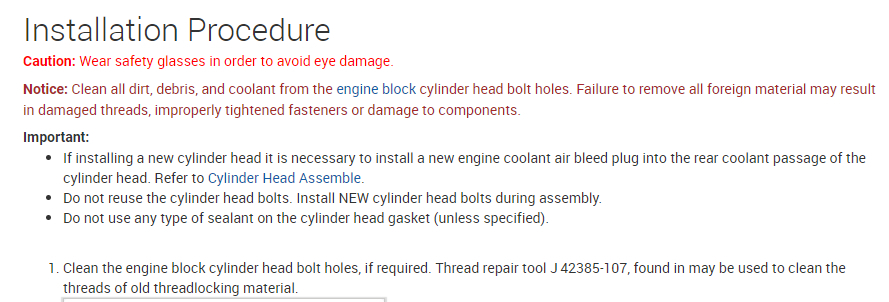

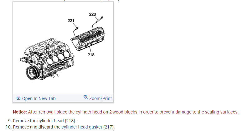

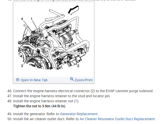

This is a continuation from last post. Here are the picture steps below for the head gasket replacement for your truck. Hope this helps and thanks again for using 2CarPros.
Jan 29, 2021 at 6:38 PM

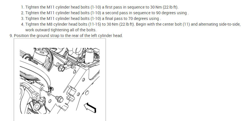

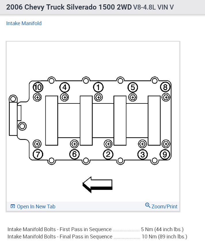

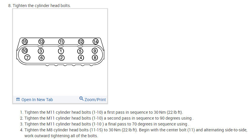

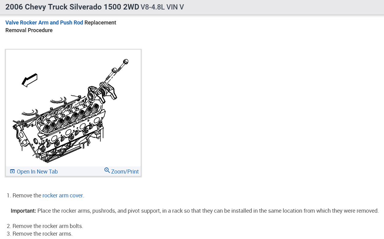

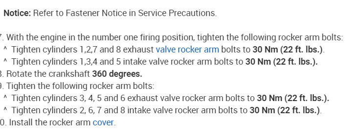

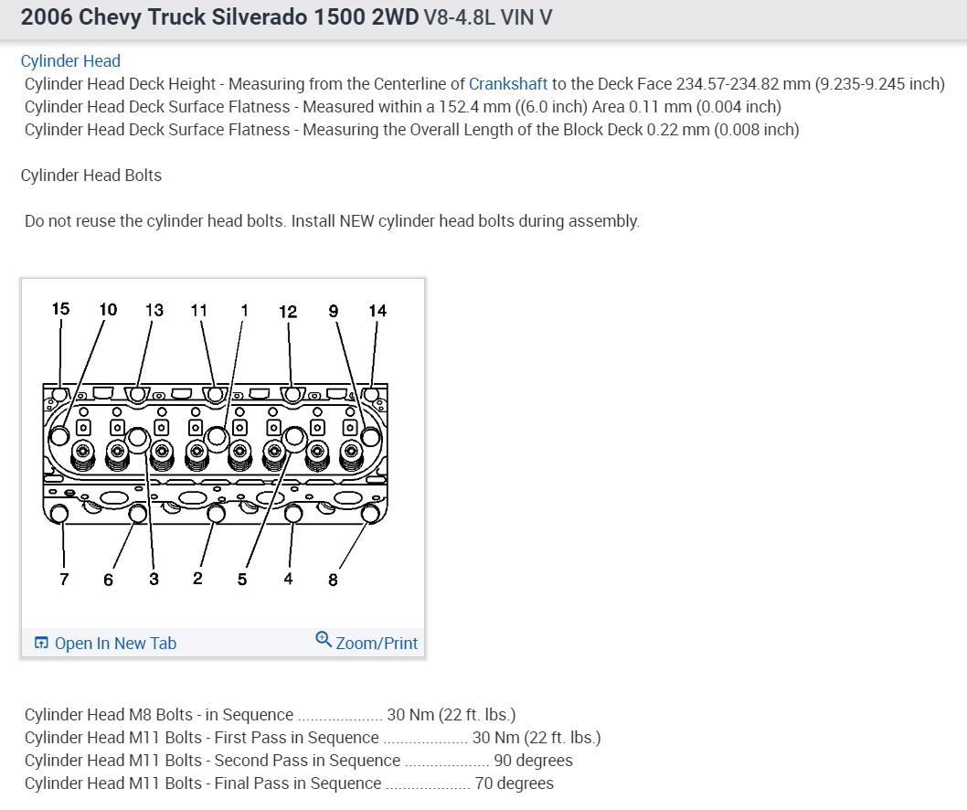

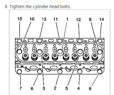

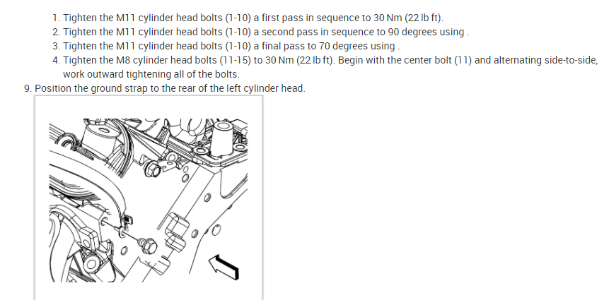

Replacing the head gaskets on my truck. I have found torque specs for the 5.3, but cannot seem to find any for the 4.8. Are they the same and if not what are they? I am needing:
head bolts
intake manifold
rocker install sequence
Feb 3, 2021 at 10:03 AM (Merged)
HMAC300
  • 48,601 POSTS
4.8 is same as a 5.3L. Here are diagrams below to show you the torque specs for the head, intake and rocker arms with a video to show you how to use a torque wrench correctly.
https://youtu.be/juOClONIWeY
Check out the diagrams (Below). Please let us know if you need anything else to get the problem fixed. Cheers
