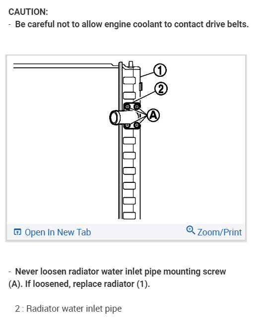

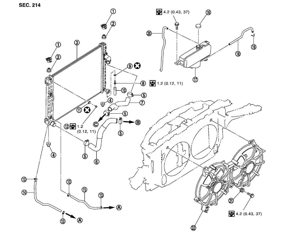

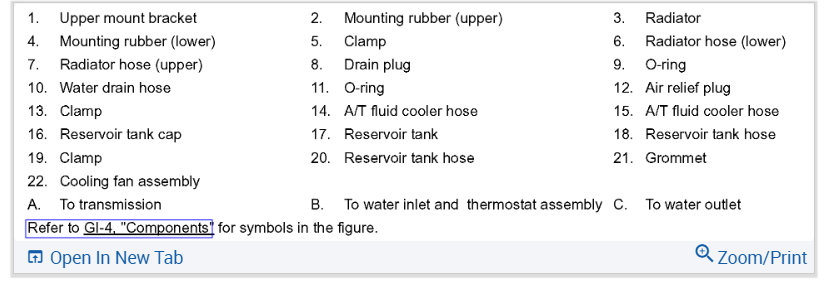

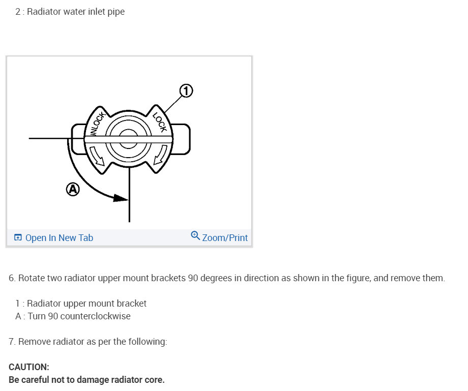

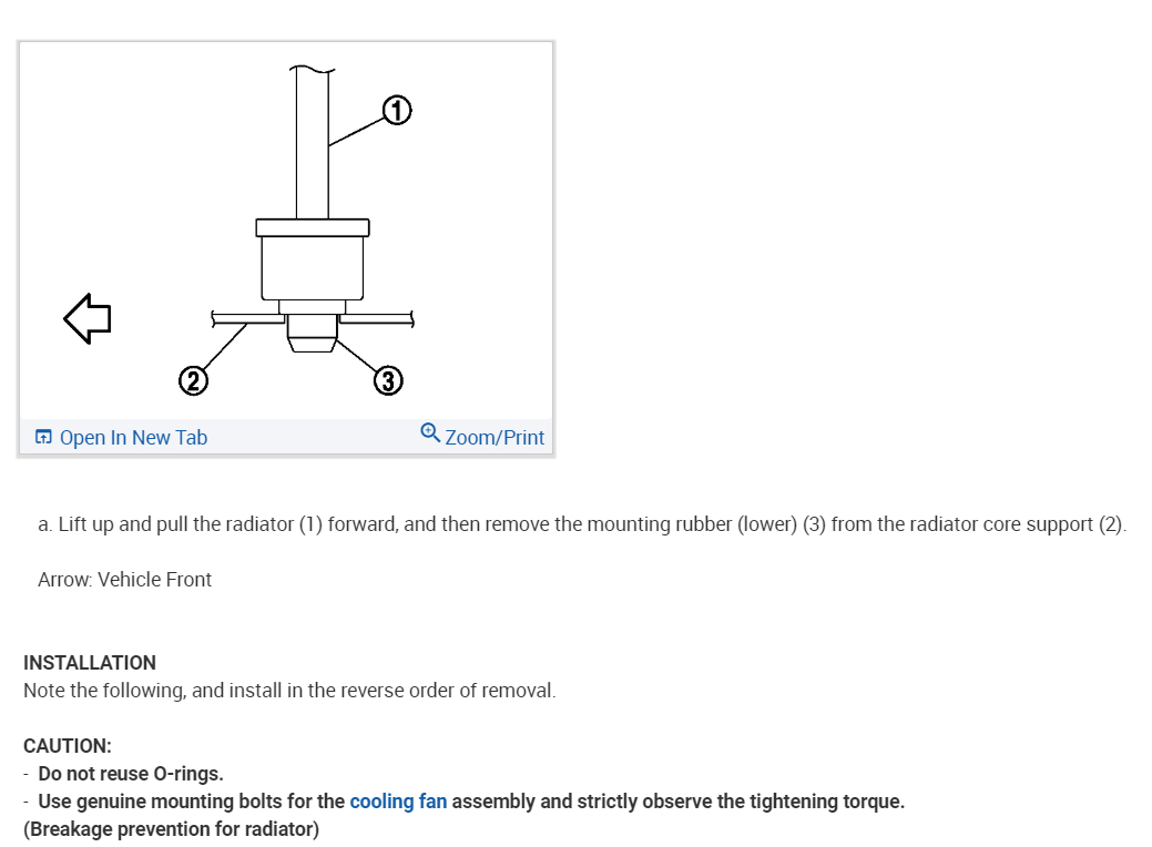

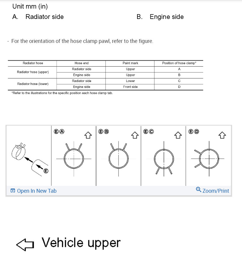

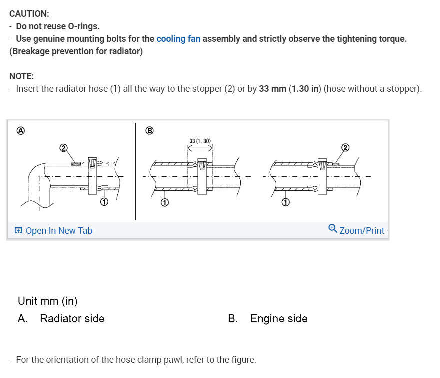

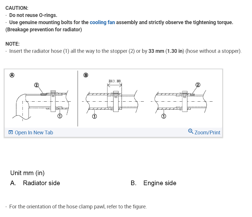

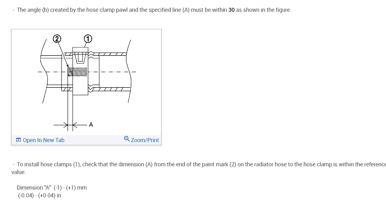

Yep, this is common. here is a guide to help walk you through the repair with instruction in the diagrams below to show you how on your car:
https://www.2carpros.com/articles/how-to-replace-a-car-radiator
They have some pretty specific instruction on how to install the new radiator or it will leak. Check out the diagrams (below). Please let us know what happens.
Jan 29, 2020 at 9:07 AM
