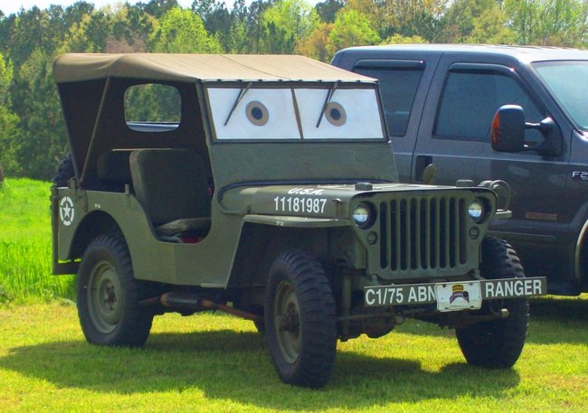

I have had nothing but CJ's since I got my license in 1981 (seven total)
1-5 were my experimental Jeeps (I experimented with them to see exactly what they could and could not do.) 1-3 sustained a good bit of hell damage. I sort of was easier on 4 and 5!
I now have 6 and 7. Got them both in 1991.

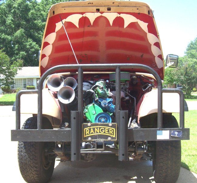

"Mr. Jeep" is a 1977 CJ-5 w/ 258 6 cylinder made one payment of $2400, he now has lots of user friendlier upgrades/ modifications. He has been my primary transportation for the last 25 years.

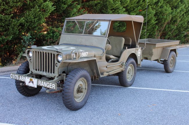

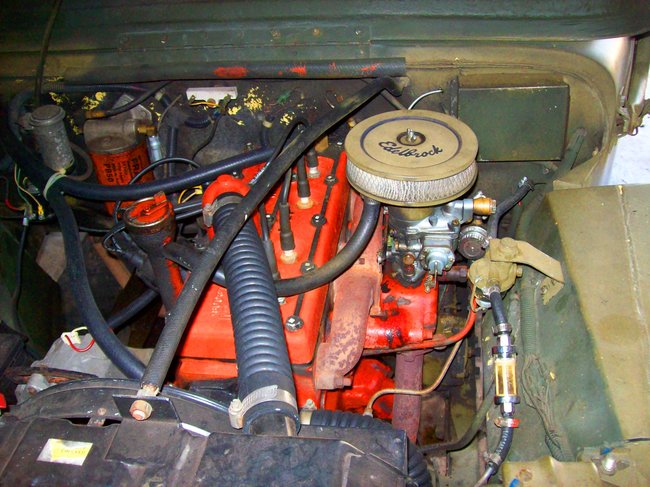

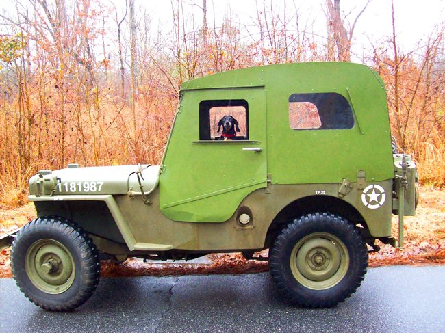

The other is "Willy", my 1946 Willy's Jeep w/ a 134 flat head four cylinder engine, one large payment of $100.00, lots of "side jobs", lots of late nights, and two years later he left "my motor pool" in 1993 looking really handsome, I drive him every chance I get!
"Mr. Jeep", "Willy", "He", "Him" reference "Real, Manly, and Masculine" Jeeps, There have never been any "Sissy's" in my garage!

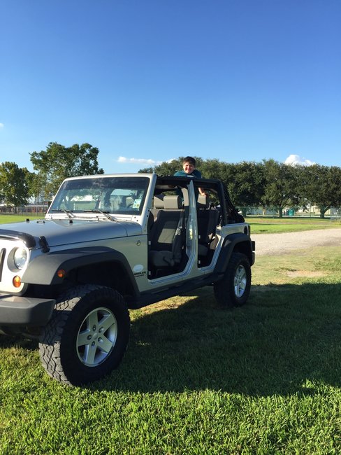

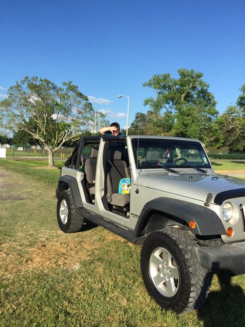

She is my baby! I do not let anyone touch anything under her hood. if I cannot do it she has to go somewhere where they specialize in jeeps! I have a 2013 challenger also but my jeep is my baby!
Aug 23, 2016 at 9:32 PM
CJ MEDEVAC
  • 11,004 POSTS
Really nice Jeep!
Sell the Challenger so you can buy more Jeep accessories
