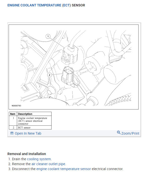

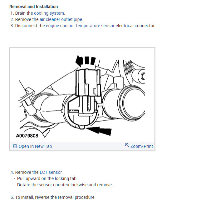

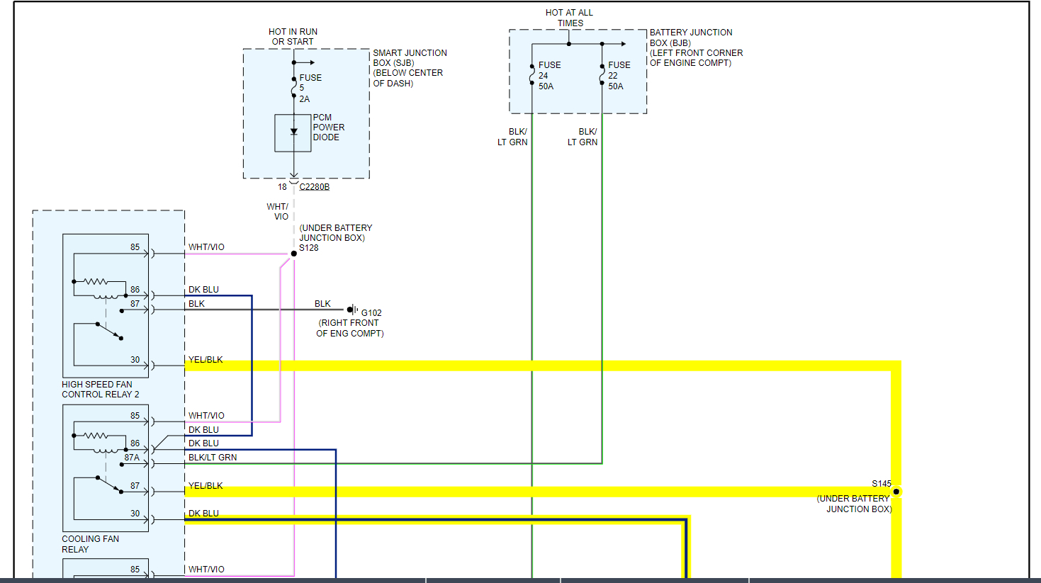

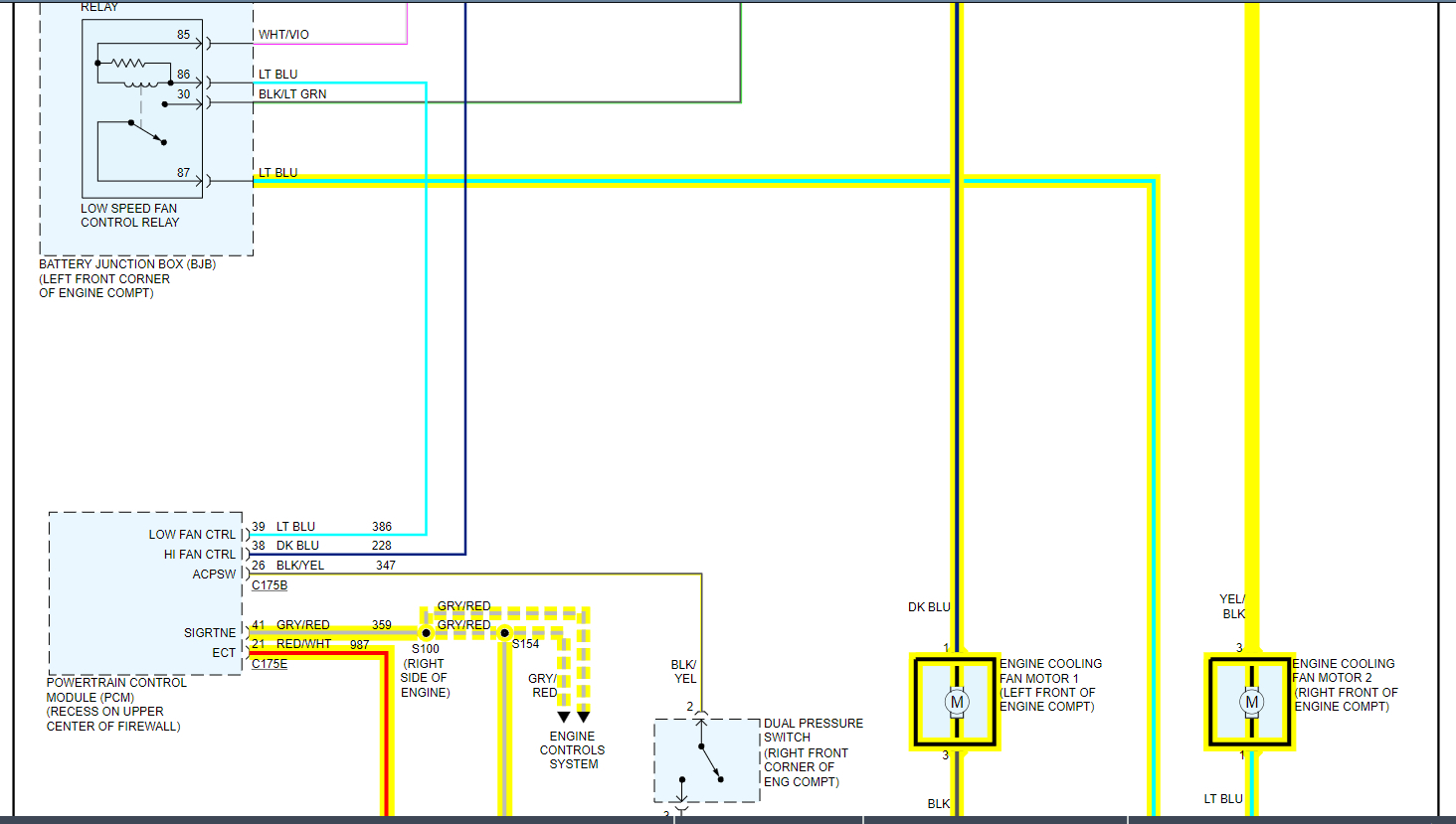

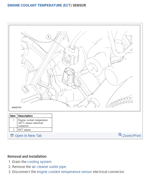

had radiator changed because of leek now fans won't come on to cool engine fans will stay on if I leave ac on or if I unplug the coolant sensor the fans will run on high but the inside temp gage won't work what to do all fuses are good should I change coolant sensor someone said maybe bad fuse box ??
