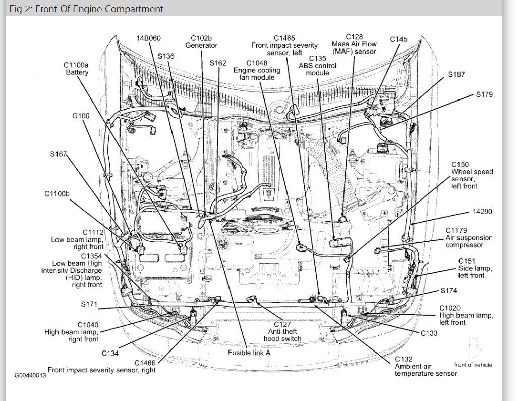

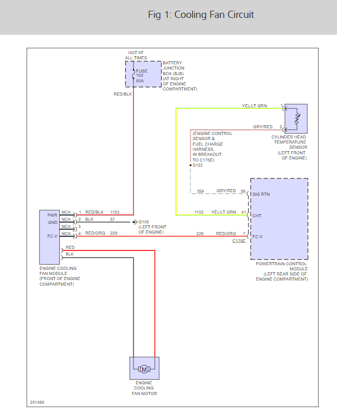

It sounds like you have a cooling fan module that has gone out. here is the location of the module so you can replace it with the cooling fan wiring diagrams so you can see how the system works. Check out the diagrams (below). Please let us know what you find. We are interested to see what it is.
